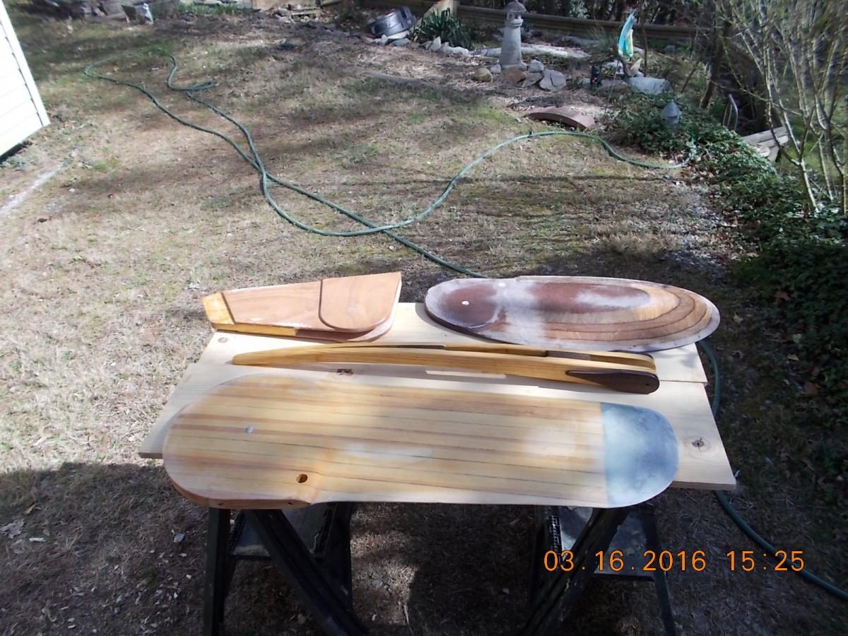

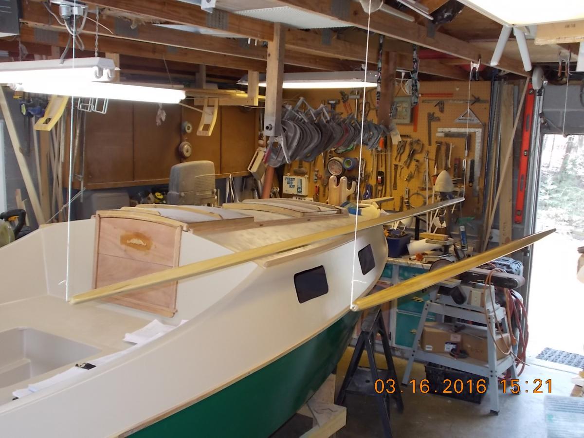

Chick Ludwig Posted March 16, 2016 Author Posted March 16, 2016 Just to prove that I'm actually still plugging along, here are a couple of pics. Sprits have a first coat of epoxy. Rudder parts all are poxy coated, in the process of being sanded, and ready for varnish coats. I'm saving all of the exterior brightwork to be done at the same time. Tomorrow I'll get to building the boom gallows and the c/b sheave box. Yeah, Vern, I know that box shoulda been done while the deck was still off. Now i gotta crawl down into the "hole" to get at it. (Never enough time to do it right the first time, but always time to fix it later!) Sprits hanging in the garage where Miss Debbie can bump into them and get poxy in her hair. Rudder parts awaiting Mr. Sanders. Quote
