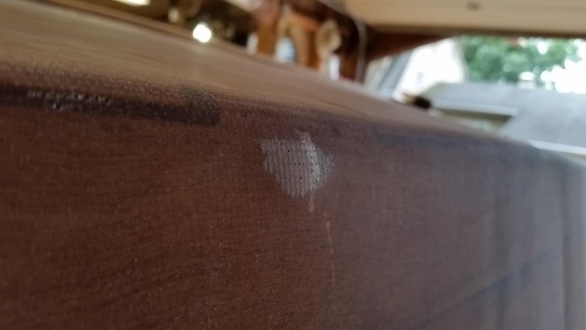

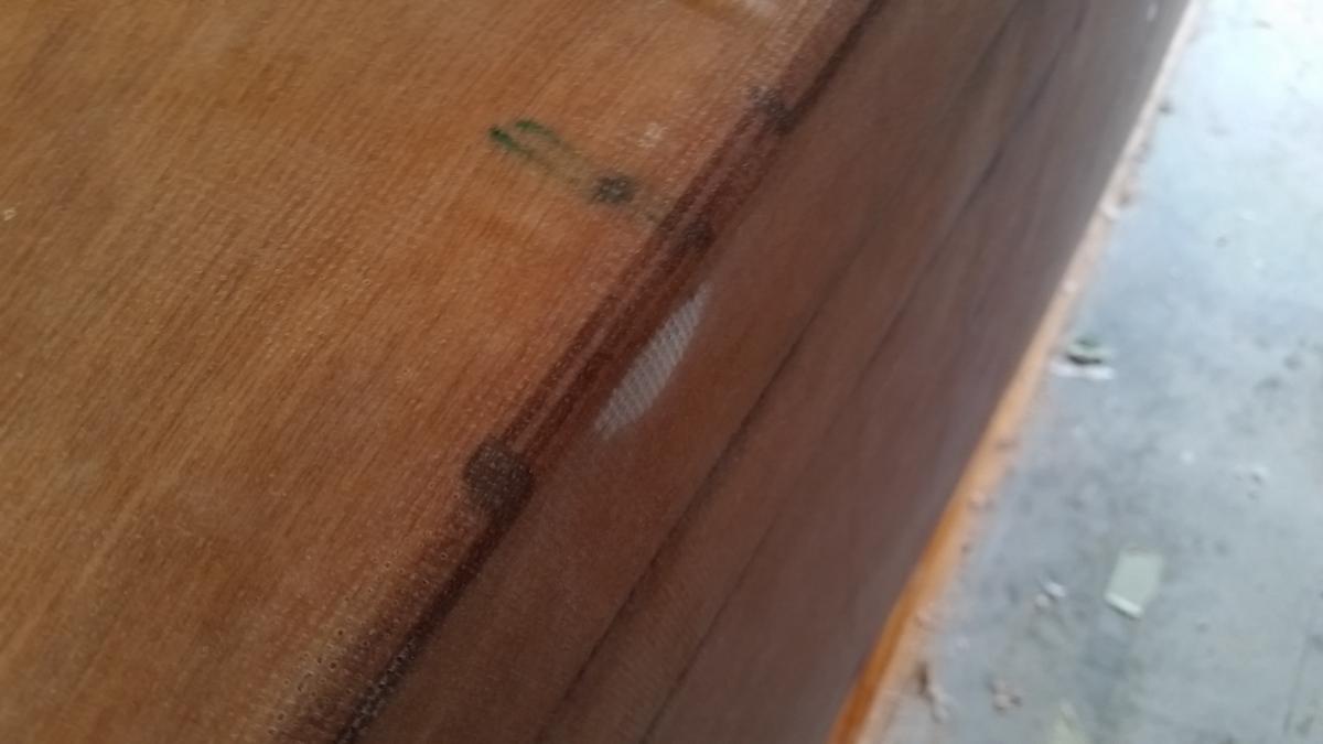

Pete McCrary Posted September 16, 2016 Author Posted September 16, 2016 ADVICE NEEDED from experienced glassing experts. While prepping the bottom for its first coat of AWLGRIP 545 epoxy primer I discovered a "bubble" under the fiberglass near the chine. Here are photos of it: . It's about 1.25" x .75" and if I push on it, the space under it ~ 1/64". I was considering: A. Drill small hole and inject it with slightly thickened epoxy, leave bump as is, and sand for the epoxy primer; or B. With an Exacto blade, cut around the primiter, remove the bubble, feather the edge with scraper and 80 grit, then fill space with epoxy putty, and sand for the epoxy primer; or C. Any better idea. Suggestions would be appreciated. Quote
meester Posted September 17, 2016 Posted September 17, 2016 I had a similar problem, and PAR suggested basically the same thing as B. http://messing-about.com/forums/topic/9349-cs15-with-a-lug-yawl-rig/?p=91788 Quote
Jknight611 Posted September 17, 2016 Posted September 17, 2016 Had the same minor bubble. Option B Quote
PAR Posted September 17, 2016 Posted September 17, 2016 In that location, you're not going to need much abrasion protection, as the protruding rail will guard the area, so knock it down, removing the blister, fill with fairing compound and move onto the next problem. Quote
Pete McCrary Posted September 17, 2016 Author Posted September 17, 2016 Thanks guys. Bubble's been cut out. Watertite epoxy putty to be applied to all dinks today. AWLGRIP 545 starts tomorrow. Quote

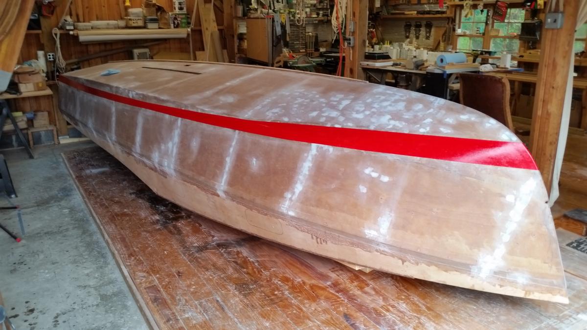

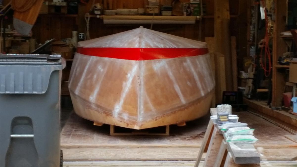

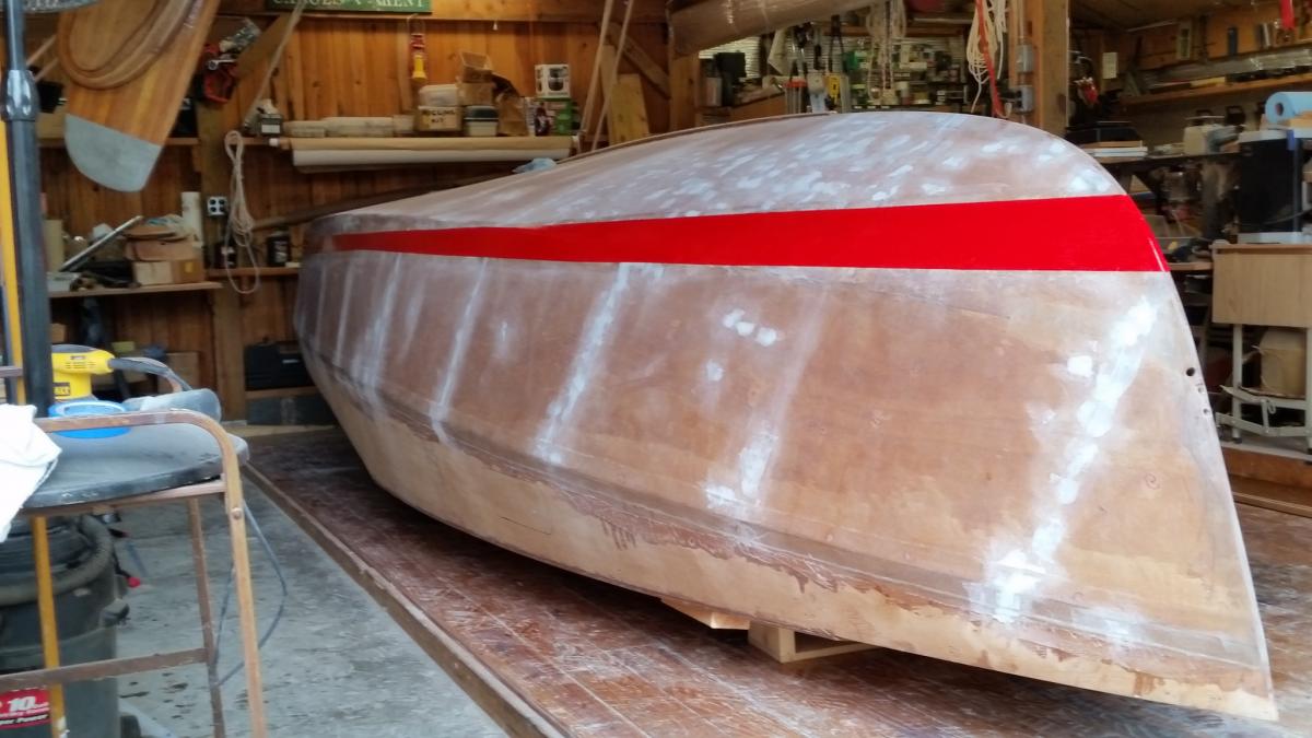

Pete McCrary Posted September 21, 2016 Author Posted September 21, 2016 Just pulled the tape off the 1st coat for the red Boot. One more and I'll start the 545 primer on the bottom and topsides. The bottom will have 2 coats of 545, the 2nd one with some graphite to make it kinda gray rather than white. The topsides will have 2 coats of 545 and then 2 more of Interlux Brightside Polyurethane (white). . Straight-on eye-level with the waterline. My paint schedule should have "Chessie" ready for insertion of her CB and then bedding of the Anderson Bailers, bow-eye, and half-ovals by approximately Tuesday, September 27. Then ROLL HER top-side UP (never to be "bottom up" again) !! The remaining color scheme: Sheer strakes -- Green; Cabin roof and bulkhead -- White; Decks -- Gray. I might leave the rub-rails, toe-rail, and transom BRIGHT. But maybe not, depends on how they look when I'm ready to paint or varnish. Haven't decided regarding the sprit booms. They'll be made of poplar. Not a very pretty wood (in my opinion) -- so maybe paint them white like the masts. Comments, suggestions, welcome. 1 Quote

Hirilonde Posted September 21, 2016 Posted September 21, 2016 Kind of late to offer this advice, but I would have primed the entire hull before any painting. This would avoid mechanical seams at color change lines as the primer would not break there. Quote
Pete McCrary Posted September 21, 2016 Author Posted September 21, 2016 Dave, I considered that. But I didn't want to have to strike the waterline and the boot-top after the hull had been painted. I know it's a bit more trouble masking, etc., And, anyway, there would still be a transition from bottom paint to topside paint. Now, I'll have two transitions. I'll be quite happy with a nice looking "20-footer" -- as they say with respect to antique car classified ads (i.e., "looks good from 20 feet"). Robert, I had in mind what the car people call "British Racing Green." It's a roadster that must have a buff-tan soft-top. It's a dark green. I think Interlux calls it a "Sea Green." Quote
