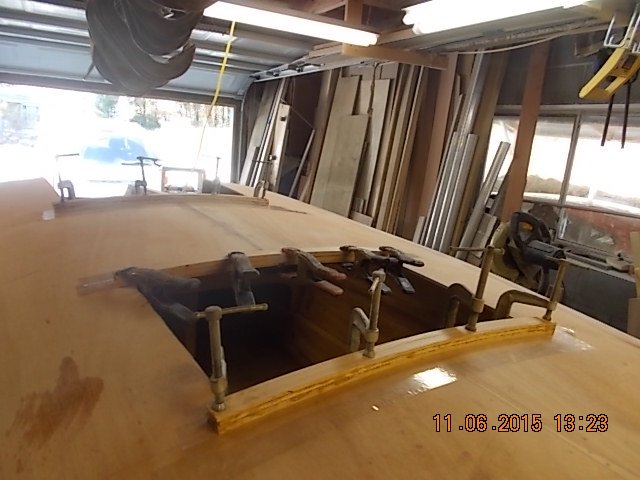

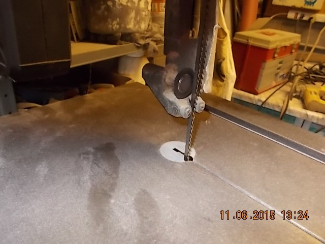

Chick Ludwig Posted November 6, 2015 Author Posted November 6, 2015 Hey y'all. Just a quick update. I've decided to laminate the transverse parts of my hatch coamings rather than try to get a smooth curve on my old, narrow bladed, worn out guides band saw. Besides, It will look kinda cool---er---neat. Guess I'll do the same for the hatches themselves. Don't forget to lay down some packing tape or something on the deck before clamping down the laminations. Ya don't want them stuck down before cleaning 'em up. (I know you old timers know this, but maybe it will save some troubles for a "newbie".) Laminations in place. The "old bandsaw". Quote

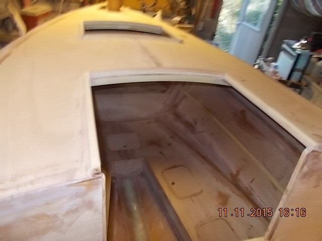

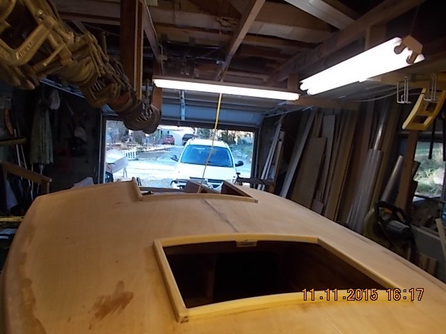

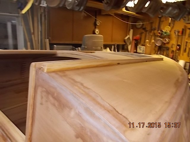

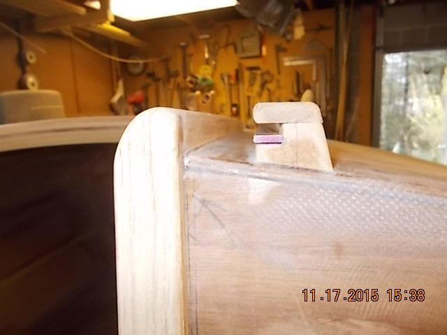

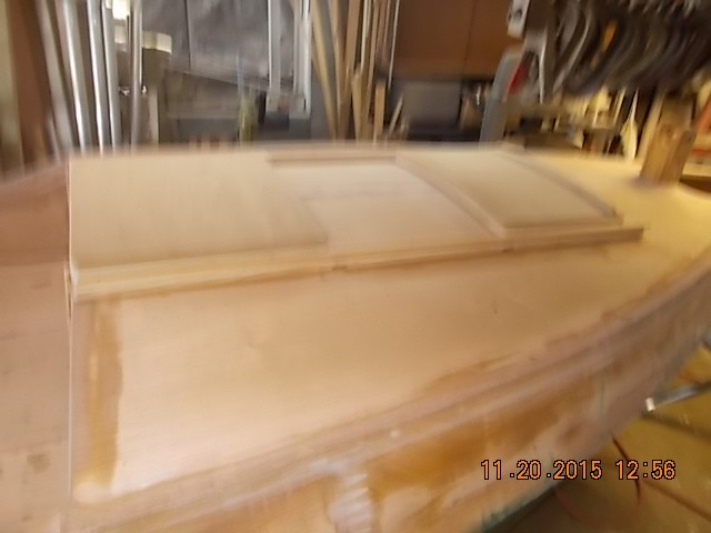

Chick Ludwig Posted November 17, 2015 Author Posted November 17, 2015 I've gotten a bit more done on Breezie. The hatch runners are almost finished. The front ends will be incorporated into the forward hatch sea-hood. You'll just have to wait for it. Gotta build the hatches first, then the hood. Side view showing drain slots. Aft view. The top cap is removable to insert the hatches. There is an aluminum strip that another strip projecting from the hatch side will slide on. 1 Quote
Hirilonde Posted November 18, 2015 Posted November 18, 2015 Make the sea hood removable. It doesn't have to be easy, but at least possible without destruction. Something I did on my Renegade sliding hatch was UHMW plastic bushings for the slides. Looking good. Quote

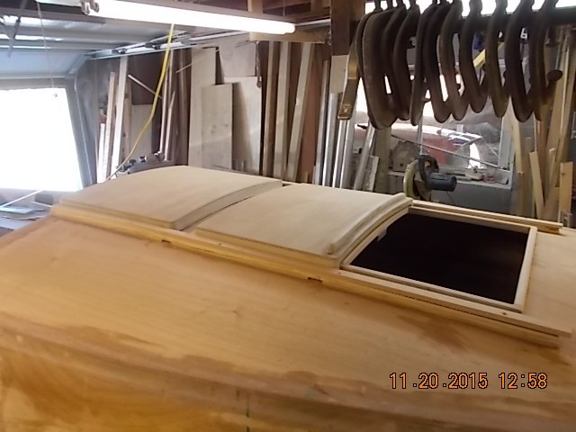

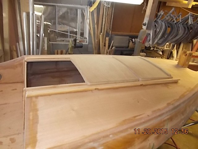

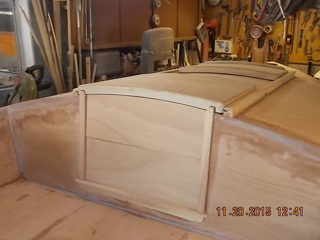

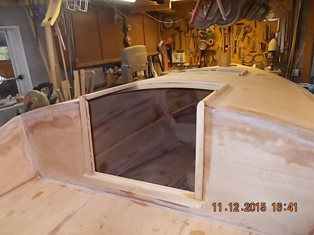

Chick Ludwig Posted November 20, 2015 Author Posted November 20, 2015 Almost done. Just have to add stiffeners to the top and a security lock on drop boards. Oh, yeah, the hood up front. I'll be back with the final pictures next week. Meanwhile, take a look.... Hatches closed, drop boards in place. Both hatches slide on the same hatch rails. Companionway hatch open. Forward hatch open. Only one hatch can be open at a time. A "trade-off". I want to be able to open the forward hatch with the masts lowered. Plan is to be able to raise the main mast from the forward hatch, and the hatch wouldn't have room to raise if it was the typical hinged hatch. "Why?" you may ask. I'll need to be able to lower the masts to go under bridges that go over some of the lakes I'll be sailing on. The older I get, the poorer my balance is. I don't wanna have to stand on the deck. Mast raising, sail controls, and anchoring will all be done from the cockpit or forward hatch---I hope. 1 Quote

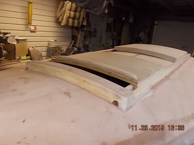

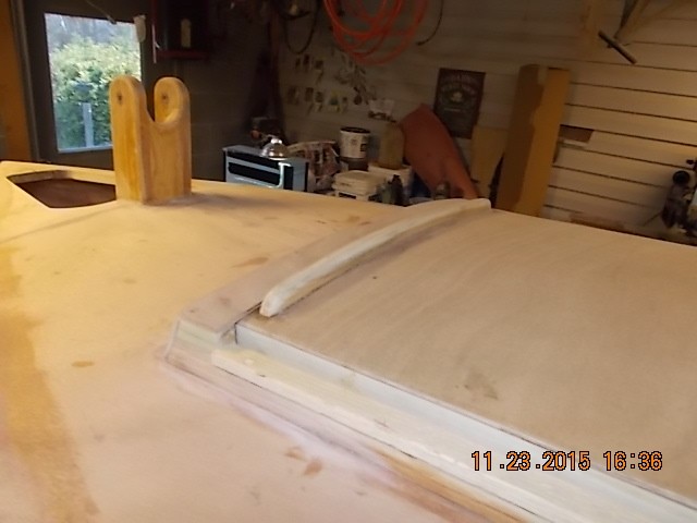

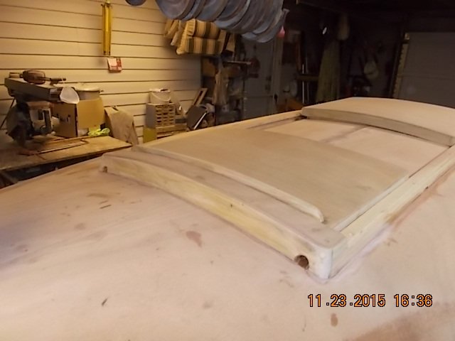

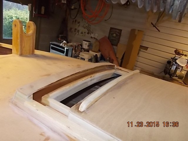

Chick Ludwig Posted November 23, 2015 Author Posted November 23, 2015 Had to come in outa the cold for awhile, so I might as well post a few pics of the sea-hood. by-the-way, I'm getting the garage re-arranged a bit so I can run my heater---if I can afford the propane... Hatch closed Hatch open Now, back to the shop to work on the "ribs" to stiffen the hatches. They are made of 4mm ply, and need to be re-inforced enough to stand on of necessary. 1 Quote
