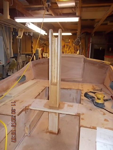

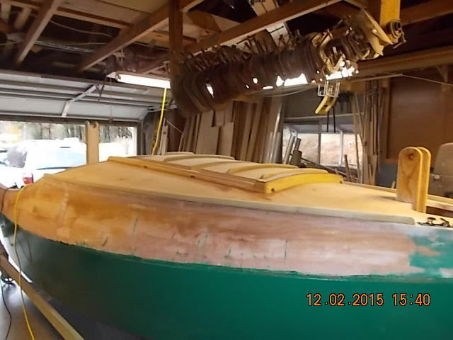

Chick Ludwig Posted November 30, 2015 Author Posted November 30, 2015 Today's job was installing the mizzen tabernacle. Still have to round off corners, but it's epoxied in place. The mast will fold forward and the top end will reat on a bracket on the side of the forward tabernacle. Here is a picture from my CS-20 Mk-2 that was done like this. I'll have to unbolt the pivot bolt and slide the mast aft so it won't stick out too far in front of the boat. Quote

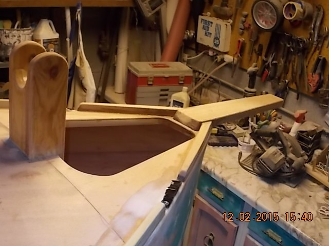

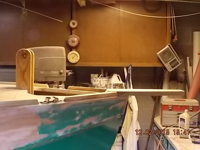

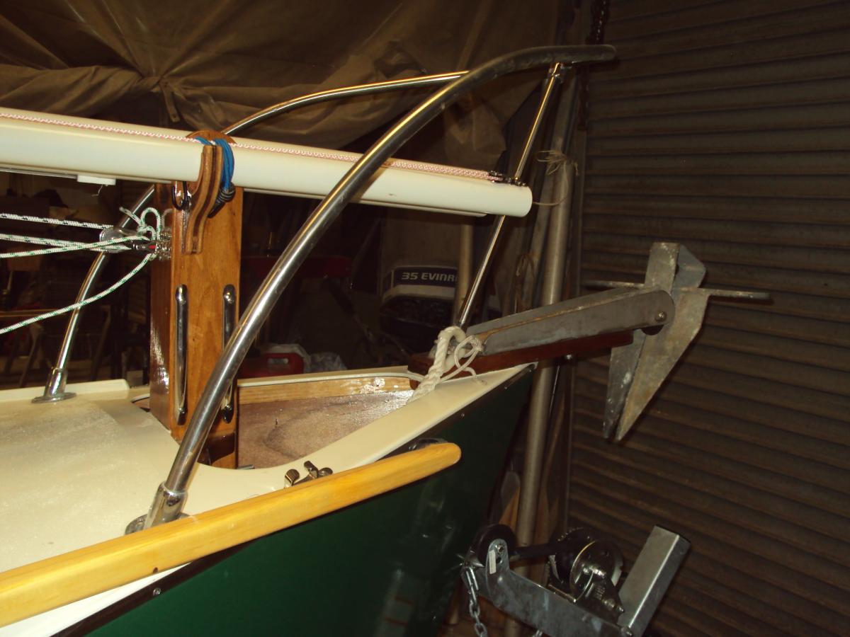

Chick Ludwig Posted December 2, 2015 Author Posted December 2, 2015 I know y'all have been anxiously awaiting the latest additions to Miss Breeze. So, here are the toe rail and bow sprit / anchor-roller-mounting-place. You'll notice the chocks set in place temporarily, but "where is (are) the cleat (s)" you may ask, to which I reply "I dunno". I'll figure it all out when all of the sail controls are led down to the deck on their way back to the cockpit. 1 Quote
Drew Posted December 3, 2015 Posted December 3, 2015 Here's a thought. If you have the anchor housed out on the bowsprit, do you need such a wide opening in the forard anchor bay. Perhaps one would only need a slot wide enough for the foot of the mast and also for stowing anchor rope and chain, thus reducing the size of the opening that can take green water in a swell. Quote
Don Silsbe Posted December 4, 2015 Posted December 4, 2015 How did you attach your "anchor-sprit"? Looks like it's gonna see a lot of load. I recommend using bolts made of unobtainium. Quote
Chick Ludwig Posted December 4, 2015 Author Posted December 4, 2015 Drew. The gremlins have attacked my computer again... I replied yesterday, but now it's gone. Or maybe Don took it. I dunno. Anyhoo, you're probably right about the hole not needing to be so large, but this 'ol country boy is not about to be out whenever there's a chance of the afore mentioned "green water". Don, how DID you know? I keep a supply of unobtainium bolts for just such times as these! Hey, I like that---"anchor sprit". Quote

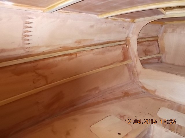

Chick Ludwig Posted December 4, 2015 Author Posted December 4, 2015 "Life" has been a little hard on the Ludwig household today, but a couple of things have gotten accomplished on the boat. I made and installed sheer clamps (For lack of a better name for them.) in the cabin between the anchor well bulkhead and aft cabin bulkhead. These kinda match the more traditional "theme" of my cabin. Their actual purpose is to give something to screw my rubrails into, In the cockpit area, there is already a "cleat" that the seats rest on that should be in the right place, and in the anchor locker forward, I'll screw from the inside out into the rubrails. The rubrails will be 1/2" wood with a SS cap. The other thing that was finished is a shelf inside the cabin bulkhead. It is for storing things like flashlight, binoculars and such. I like to use the spindle rails from Lowe's for these shelves. I needed to get this one in now so I could temporarily run screws from the outside to hold it while the poxy cures. Then I can remove the screws, fill the holes, and epoxy coat and paint the cockpit and deck. There will be other shelves inside, but they won't need screws from the outside. Hey, why is it that I can proof read these posts several times, but after posting them, I find "oopses" that I need to go back and edit. This usually happens 2 or 3 times with each post. Sheeesh, what a dummy!. Maybe Thrillsbe can come over and help... Quote

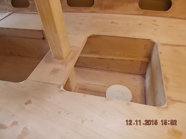

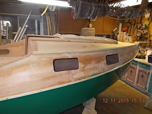

Chick Ludwig Posted December 11, 2015 Author Posted December 11, 2015 Well, back to the project at hand. i have gotten down to that magical point when it's about time for the epoxy coats and paint on the cockpit/cabin/deck. I'll show you the final things that are done now and tell you about them with the appropriate pictures. With the beautiful lines of the boat that the Master designed, I didn't want to leave "square" corners in the cockpit seats. I glued in little "curvey" corner blocks. Then the edge is routed to a nice radios all around. Here is the forward tabernacle with a support (cradle?) thingy to hold the mizzen mast when in the lowered position. The holes for the Beckson opening ports are cut out. Being an old Florida cracker-boy, I want LOTS of ventilation, so I have 4 ports. Also notice the rub rail. There will be a SS hollow-back rail screwed on top after the paint work is done. Quote
