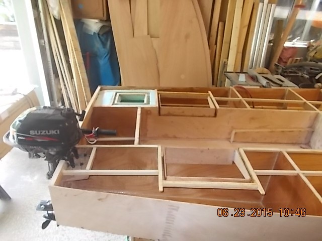

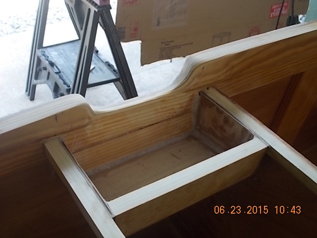

Fred, I have the Suzuki 4-stroke 2.5 hp. It is a short shaft. (By the way, although these short shaft motors are called 15", they are actually 17".) I'll attach a picture of my transom set-up. I still need to add a wedge on the back of the transom so the motor shaft will be vertical. The cutout in the transom allows the foot of the motor to rotate all the way around for reverse. It also gets the prop deep enough in the water. I really like this motor. Be sure to use gas without ethanol, add Stabil, and shut off the gas and run the motor out of gas before storage. The mizzen sheet will foul on the motor shaft when it's kicked up. There is conversation on the forum about how to prevent this.

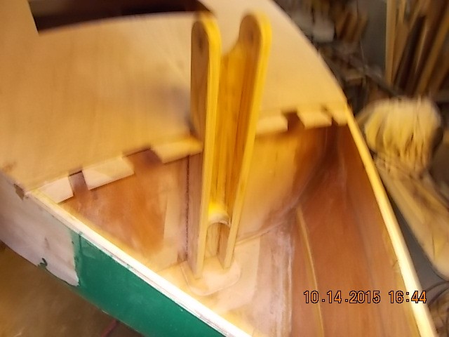

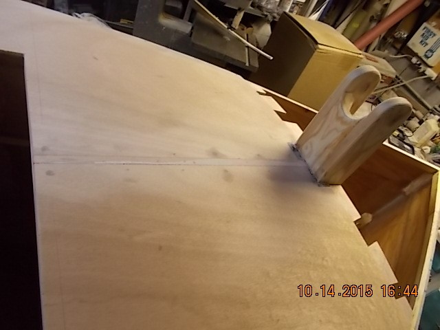

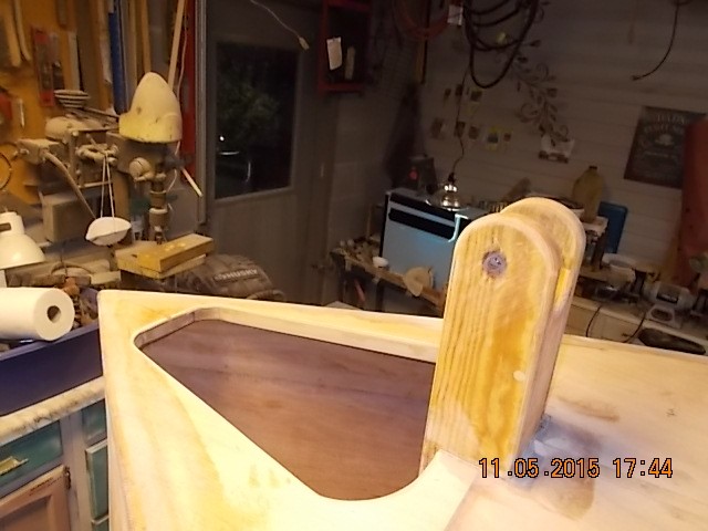

Hi y'all, I'm back with the promised pictures of the tabernacle. I measured the deck ahead of the cutout where the mast swings through the deck. There will only be a little more than 6" of deck ahead of this point to install an anchor on a sprit. This is gonna take some engineering to give the sprit enough support to take the force of the anchor deployed from the end of the sprit. Or I could be sure to run the anchor rode through chocks  mounted adjacent to the deck cutout. Any thoughts from you guys? The second picture also shows where I filled between the halves of the deck/cabin top there my deck parts were not wide enough.
post-1823-0-58826900-1444919667_thumb.jpg This is it. The tabs on the deck are butt blocks for the forward deck section.
post-1823-0-75055600-1444919668_thumb.jpg A view from aft. Also shows where I filled between the halves of the deck/cabin top.

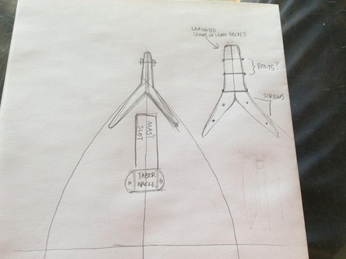

You could put on a false clipper bow and some trail boards to support your sprit.
Or, perhaps a sprit that is two hockey stick shapes glued up (or even bolted up with the anchor roller between), then bolted through the deck on either side of your split.
It's actually raining here, so I'll go listen to it and sketch up my weird hockey stick idea...
Link to comment
Share on other sites
Please excuse the poor quality of this drawing. I don't know if you're a roller in a notch guy, or a roller on either side guy, so the merest indication of anchor handling gear is there.
I think if it's short, like just for anchor handling, it should be fine. Is there a sheer clamp to tie into? Might could be pretty rigid after all...

Just make sure you use feather boards and a push stick when you rip the laminates, yeah?
This could be a really handsome deal. I think you could double duty one of the through bolts and have a roller on each side.
My favorite Yogi-ism and personal mantra has always been, "When you come to a fork in the road, take it."
Appropriate for our weird hockey stick sprit, eh?

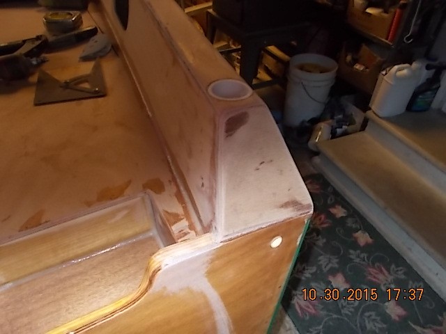

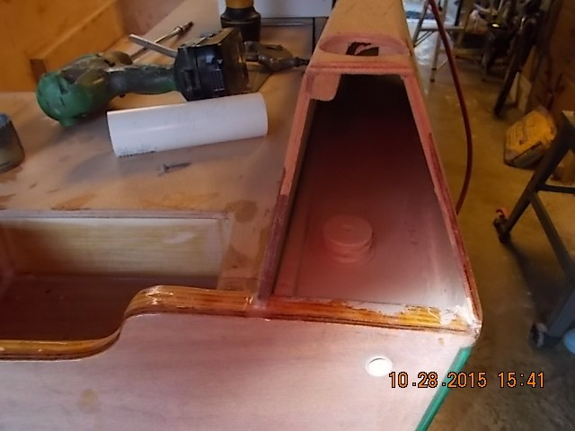

Here is some progress on my boom gallows mount. I've capped the ends of the coaming. The 1-1/2" P.V.C. pipe will accept a removable 1-1/2" aluminum tubing that are the uprights for the boom gallows. You'll have to wait for the completion of the gallows until after the rest of the boat is done. It will be similar to the one on my CS-20 Mk-2. That was the first Summer Breeze. You can check it all out on that building thread.
post-1823-0-40878500-1446244448_thumb.jpg  Plug at bottom to slip and epoxy the 1-1/2" P.V.C. pipe over.
post-1823-0-51261500-1446244449_thumb.jpg  Pipe temporarily in place. There is a drain hole at the bottom.
post-1823-0-61445900-1446244450_thumb.jpg  Finished installation. It all gets glassed when I glass the coaming tops.

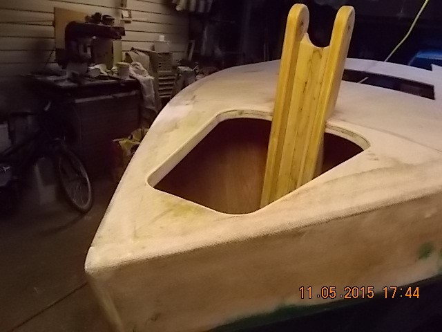

The last few days have ben spent glass taping and sanding all of the corner joints on the coamings, deck, and cabin top. Along with that, I've finished the anchor well / mast pivoting slot thinghy. The opening is ringed with 3/4" wood to reinforce it and make it look "cool". Later on, the bow sprit will be added, but now it's time to move on to hatch coamings and forward and companionway hatches.
I don't think pictures of the deck corners are very exciting, but here's a couple pictures of the hull. And NO Verne, this is NOT the "head"!
post-1823-0-45323200-1446764059_thumb.jpg  post-1823-0-82384900-1446764060_thumb.jpg
