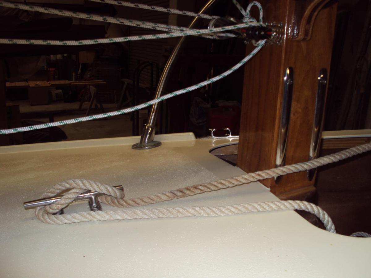

Chick Ludwig Posted September 24, 2015 Author Posted September 24, 2015 Ok guys, let's get back to some boat building talk. I'm looking for input on a couple of things. (Well, actually all part of one issue---kinda.) I'll explain. The mainmast (Foremast to you politically correct types.) is very close to the bow. My anchor will be hung on a short bow sprit, and anchoring and docking will be carried out from the forward hatch. There is not enough room on the fore deck ahead of the "hole" that the mast foot swings down into to have a mooring/anchoring cleat. (I'm sure that there is a proper name for this hole, but I dunno.) A vague thought is to have the anchor on the sprit at an angle so the anchor rode can come along side the "hole" to a cleat farther back. If I would run it directly back along the mast tabernacle, it would interfere with all of the sail control lines coming to turning blocks mounted on the deck at the back and either side of the mast. Included in these is snotter, down haul, halyard, reefing pennant for the first reef, and boom topping lift. These will all be led aft to the cockpit. As you can see, it's gonna be a mite crowded up there... Any and all suggestions gratefully accepted---even dumb ones. Your boating friend, "Stumpy". Quote
Jknight611 Posted September 25, 2015 Posted September 25, 2015 Chick, as you saw I have 1 cleat slightly off center on the port side, that will be for my anchor rode and to tie to a dock, that leaves the stbd side clear for the main mast lines. Think that will work? Quote
PAR Posted September 25, 2015 Posted September 25, 2015 The mainmast on a ketch, even a cat ketch is still the mainmast. A foremast suggests something bigger is aft of it. As to your rigging, I don't like everything leading into the cockpit. It just creates a rat's nest, so I usually terminate the stuff that'll be used once or twice underway to the front of the cockpit on a cat or the mast on a sloop. This would mean halyards, flag hoists, lifts and ground tackle lines would be out of the way forward, with the sheets and other common sail control lines in the cockpit, such as down hauls, Cunninghams, vangs, etc. You might consider going under the deck, instead of on top. A simple sheaved exit box or turning block arrangement works. Quote
Chick Ludwig Posted September 25, 2015 Author Posted September 25, 2015 Jay, yeah, that's what I had in mind. Par, I'm thinking of the terminology as used on sharpies as developed on the Pamlico sound and other places. Anyway, I call it a mainmast and others probably do too. Just like to stir things up. I like my controls on my boats led aft as I stated. I've never experienced a rat's nest as long as everything is layed out carefully like I had on the first Summer breeze, my CS-20 Mk-2. There won't be flag hoists, cunninghams, or vangs on this boat, and I will use the lines that are there, with the exception of the topping lift, often. I single hand and don't intend to crawl over or under the deck if I want to mess with the lines to control sail shape or reef. The anchor will be handled from the forward hatch as stated. Seems like I took pictures of everything except how I led my lines aft. These are all that I could find. On this boat, there was room for the dock line/anchor cleat on the deck directly behind the mast and bowsprit. The sail control lines led from turning blocks on the tabernacle and through fairleads on the cabin top. I think you get the idea. On the Mk-3, there is a forward hatch to avoid, but i think I can achieve the same results. Quote
Peter HK Posted September 25, 2015 Posted September 25, 2015 and I will use the lines that are there, with the exception of the topping lift, often To avoid too many lines running aft from the mainmast on my CS17 I put the topping lift adjustment on the boom. There is a fixed line from mast top which attaches with a snaphook to a line from the end of the boom which, after going through a turning block, cleats along the boom. There's plenty of adjustment after fiddling a bit with the length to get it right (and also to make it at an easy-to-reach height when rigging the boat for launch). Might be worth thinking about. Cheers Peter HK Quote
Chick Ludwig Posted September 25, 2015 Author Posted September 25, 2015 Thanks Peter. Yes, I have considered that, but I also use the topping lift to pull the sprit all the way up to where it is against the mast. Then I lower the mast and sprit as a unit and secure them together for trailering. Guess I do everything differently from the world. Quote
Ken_Potts Posted September 26, 2015 Posted September 26, 2015 How about just tying a line around the main mast when you want to tie up or anchor? It's a bit ad-hoc but it worked alright for me. Quote
ecgossett Posted September 27, 2015 Posted September 27, 2015 I use my anchor roller for running the line, then tie around the main mast as well. It's worked wonderfully!!! The clothes line was a little harder, and I wished I had real cleats aft on my boat. What I've done for temporary cleats is used pins in rowing positions, or ran line through pin holes, to create loops for a more secure solution. Quote

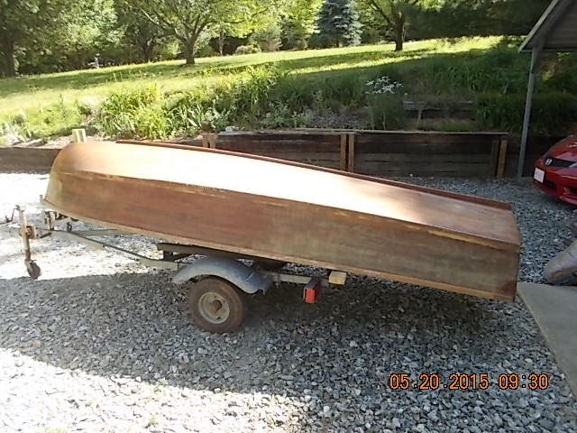

Chick Ludwig Posted September 28, 2015 Author Posted September 28, 2015 Well folks, here I go again... I'm selling the Spindrift 12 that I bought from Scott, but never finished. I'll repeat the ad that's in "classified" so ya don't hafta go there. I had gotten all of the parts, sails, etc. from B and B in anticipation of finishing it before getting my CS-17 kit, but the kit was ready first. Spindrift 12 hull finished except for some minor details. I bought it with the intent of finishing before beginning on my CS-17 so I'd have something to sail. Good plan, but it didn't happen! All hardware, aluminum mast tubing, new sail with zipper reef from B and B, etc. are included. All for what I have invested. Galvanized trailer is available and I prefer to sell the trailer with it, but will sell without. I'll get pictures when the rain stops!!! Boat and the rest, without trailer, $1300.00 Trailer $350.00. Quote
Michael Hiester Posted September 28, 2015 Posted September 28, 2015 Chick, You have a lot more miles under your belt than I so I trust your judgement. Is that trailer good for a trip to the coast, say Charleston, SC? Quote
Chick Ludwig Posted September 29, 2015 Author Posted September 29, 2015 Mike, the trailer would be good. It has not yet been set up to properly fit the boat, but I think the boat would do fine just tied down. With my new "stumpy" finger injury, I'm not able to actually work on anything yet. Right now the boat is upside down on saw horses, but I can get it onto the trailer when needed. If you're interested, just let me know and bring plenty of rope. Quote
Chick Ludwig Posted September 29, 2015 Author Posted September 29, 2015 Here are some pics. I couldn't turn the boat over but you can check out what an S-12 looks like on the BandB website. With the trailer winch stand moved forward and the boat right side up, the boat will be forward and balanced correctly over the axle. The hull is covered with glass, and finish coats of resin are smooth and fair. With very little more work, it will be ready to be scuffed-up and primered or painted. Quote
