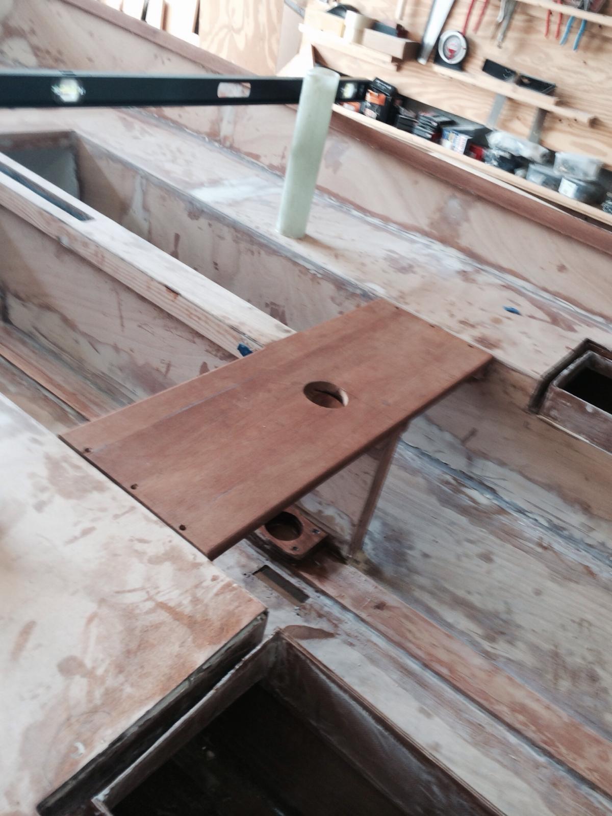

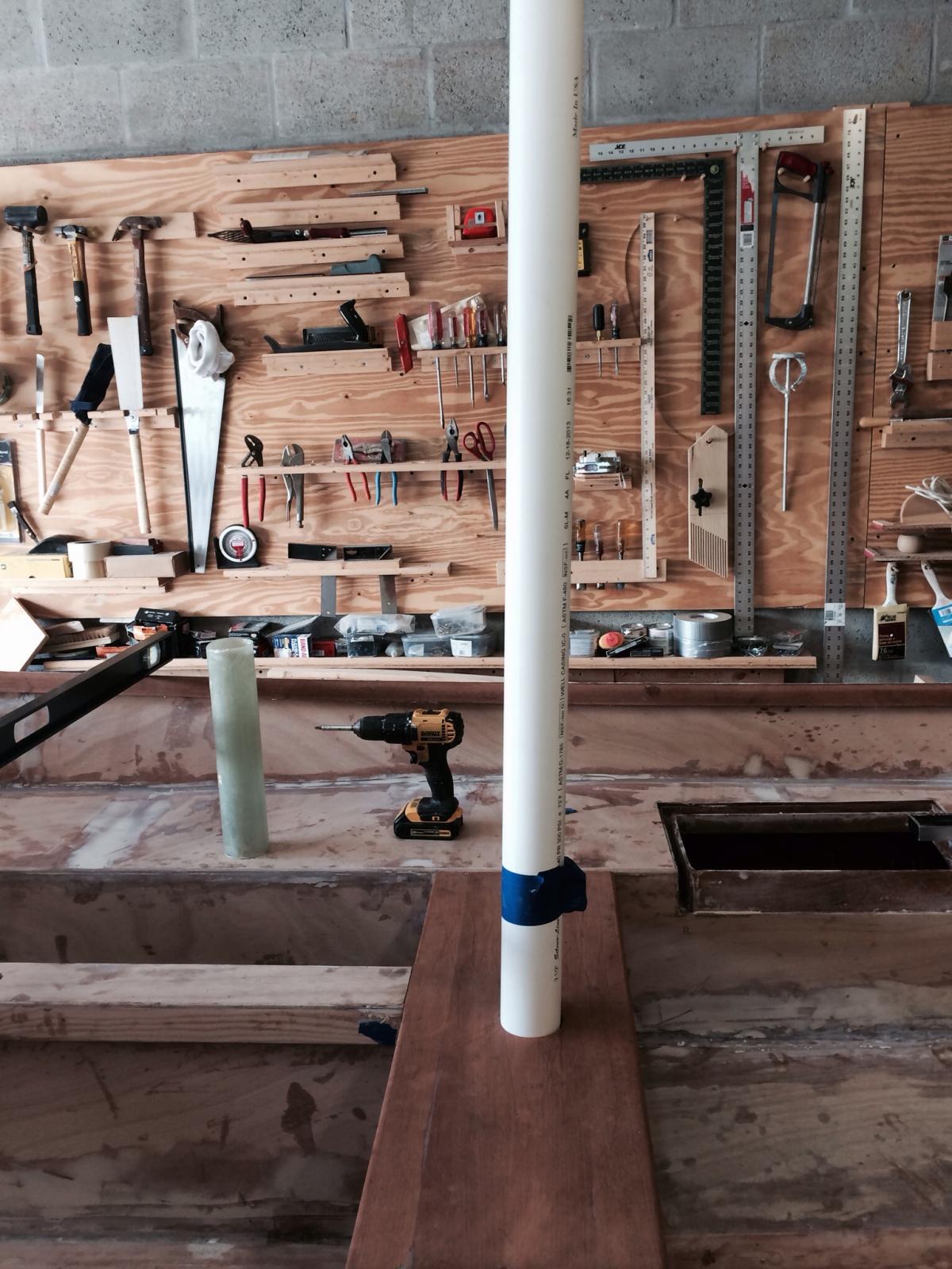

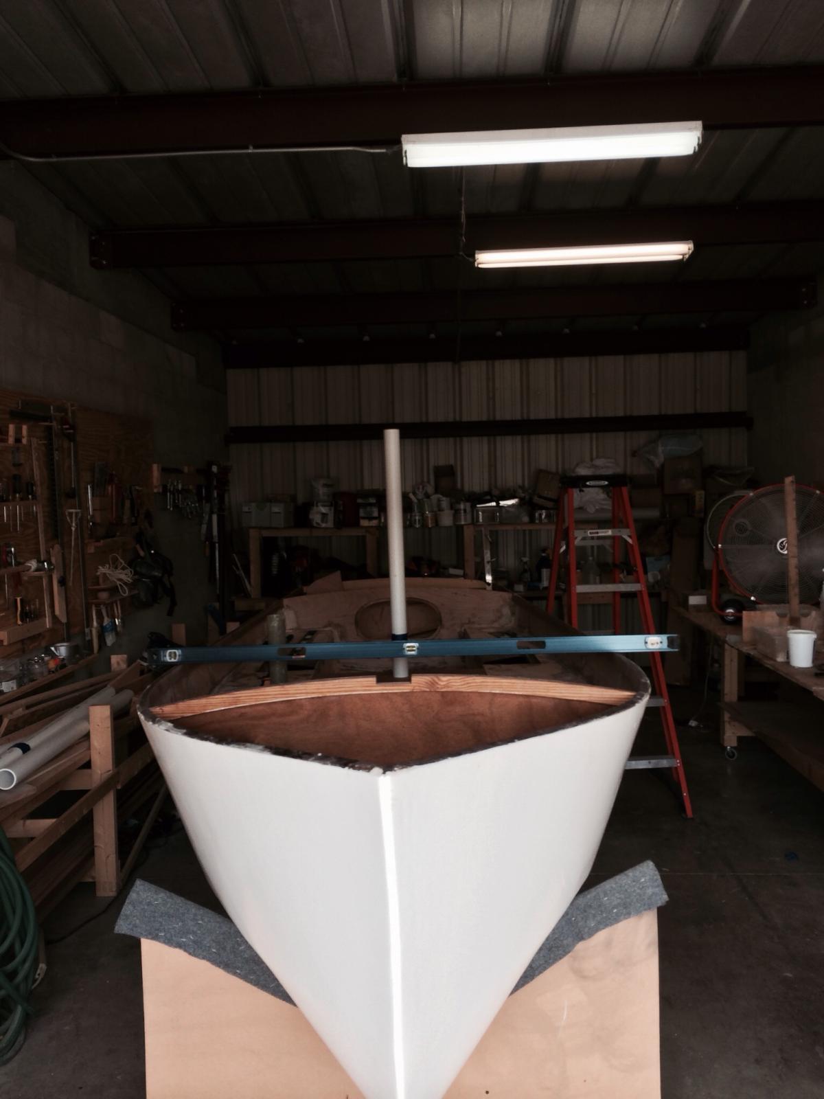

LennieG Posted August 28, 2014 Author Posted August 28, 2014 Great couple days....got past some intimidating parts of the build that has caused sleepless nights. Did my last application of "putty", I think, but more important cut the holes in center thwart and mizzen mast step, aligned and installed the mast step, thanks to Alan Stewart who took all the mystery out of this with his video on the CS15. Â His ( and I am sure, Graham's) method of establishing the 3 degree rake and plumb with the 1 " block 20" up the mast was superb. It all worked out great and the photo may distort but it is all aligned well. Paul- thanks for the coaming photos and info- it will become very useful. Your boat looks great!! Quote

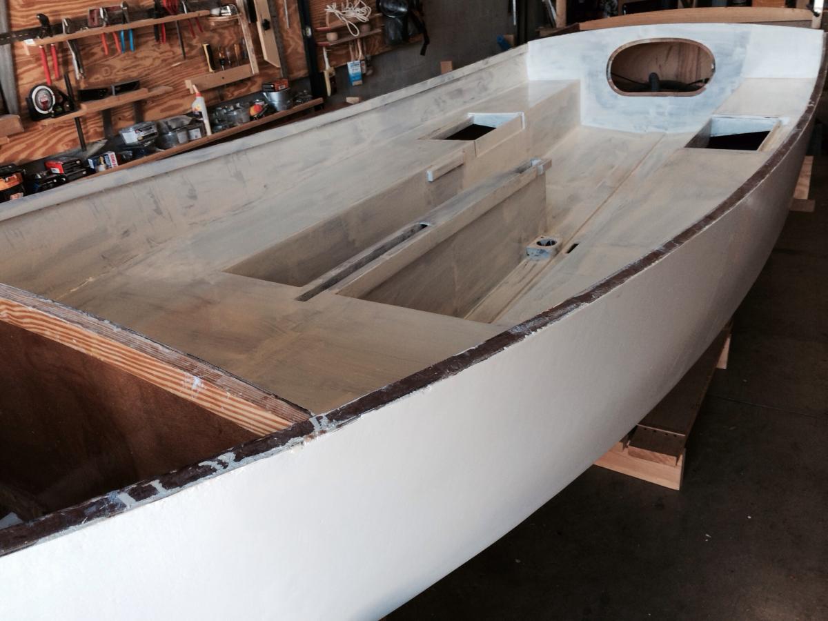

LennieG Posted September 6, 2014 Author Posted September 6, 2014 Put on the third topcoat this morning, and then a non-skid layer this afternoon. Used the Bateau additive powder. Like others have said here years ago, a bit clumpy and hard to keep suspended, but believe it all worked out. Not pictured here after applying, but assume I can sand off the clumps in the morning and apply the fourth and hopefully final coat. Looking forward to moving forward. I like the System Three LPU system paint much more than the Interlux Premium Yacht enamel.  Quote

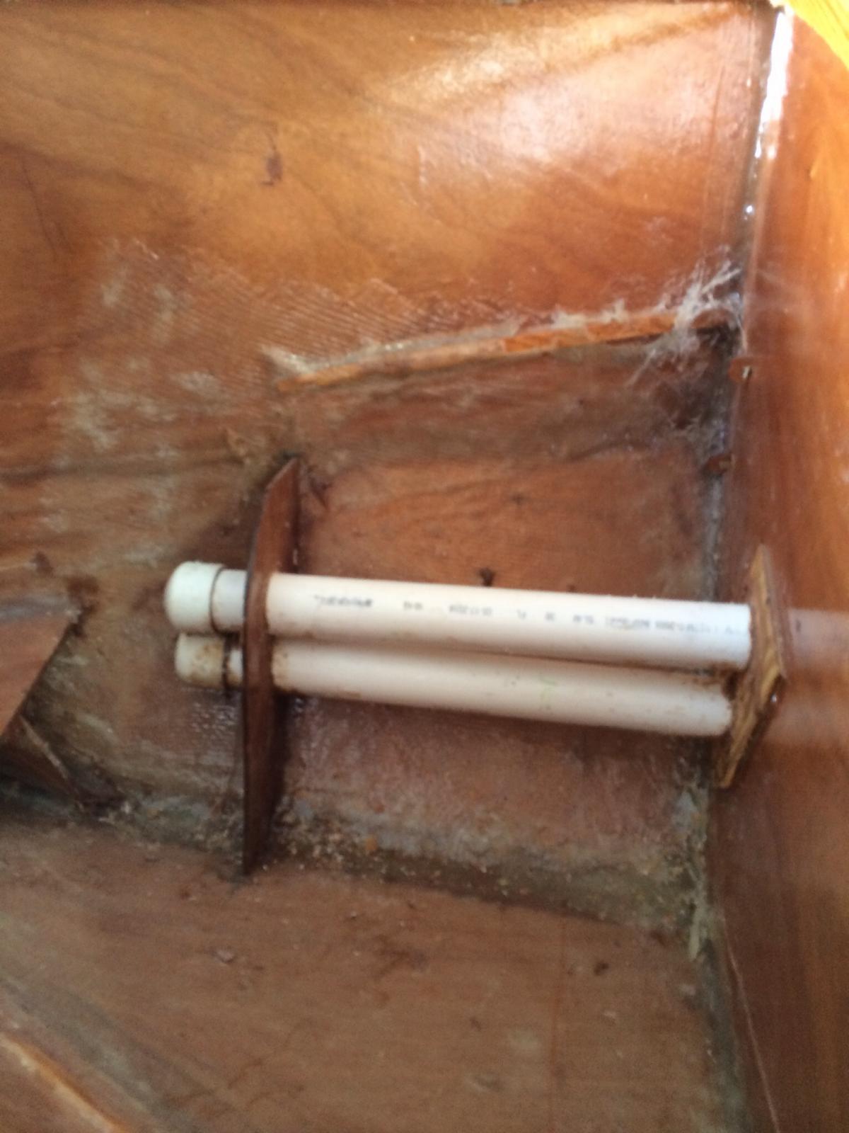

makenmend Posted September 7, 2014 Posted September 7, 2014 curious, what are those cleats for on the stbd side of the center board trunk ? Â MM Quote
LennieG Posted September 7, 2014 Author Posted September 7, 2014 MM- oar brackets.....wanted something to screw them into. End is held with attached, and brackets on CB trunk. Quote
MattandTru Posted September 8, 2014 Posted September 8, 2014 That is a pic of the forward compartment by the main mast step? Pipes receive the oar handles under the deck? Very nifty. Matt and Tru. Quote
LennieG Posted September 8, 2014 Author Posted September 8, 2014 Yes- not my idea. Works well for some apparently. Next time I may save a bunch of time and hang them under one of the side decks, as the designer recommends. I don't have oars yet but am hoping I haven't lost much leg space. I did buy one at oat a Westt Marine for dry fitting as I built the storage, and then returned it. Seemed to work. Quote
mattp Posted September 8, 2014 Posted September 8, 2014 I am thinking I will store my future oars under the side decks as you mentioned but I figure they won't tuck neatly under there without some curvature built in. I also wonder if the curvature could be used when rowing to wrap around the high decks and maybe require less length than straight oars. Anyways, you're boat is looking great Lennie. You'll be sailing before long. Quote

Hirilonde Posted September 8, 2014 Posted September 8, 2014 I am thinking I will store my future oars under the side decks as you mentioned but I figure they won't tuck neatly under there without some curvature built in. I also wonder if the curvature could be used when rowing to wrap around the high decks and maybe require less length than straight oars. If by this you mean build in a bend down when the oars are in place rowing and the blades are perpendicular to the water I think you will find they twist in your hands as you try to make a stroke. Quote
LennieG Posted September 8, 2014 Author Posted September 8, 2014 I applied my third and final coat of paint on Sat morning. I applied my fourth and final coat of paint on Sun morning. i applied my fifth and final coat of paint today. Â is it me? Â Quote
LennieG Posted September 8, 2014 Author Posted September 8, 2014 Lennie that makes entirely to much sense. Â T is If you do this the secret is getting the oars as long as possible. The longest possible I think is 8'10". I missed by a couple inches due to my inability to line up the holes/ oars/ fore section optimally, getting the oars in and the handles as forward as possible. Dale (cs17 "lively"did better). I'll give you $5 if you get to 8'10"". Â Quote
