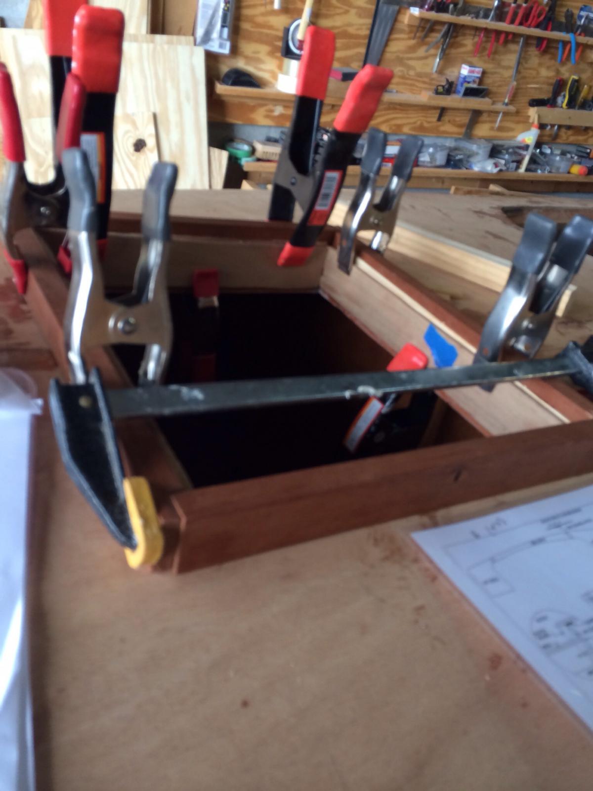

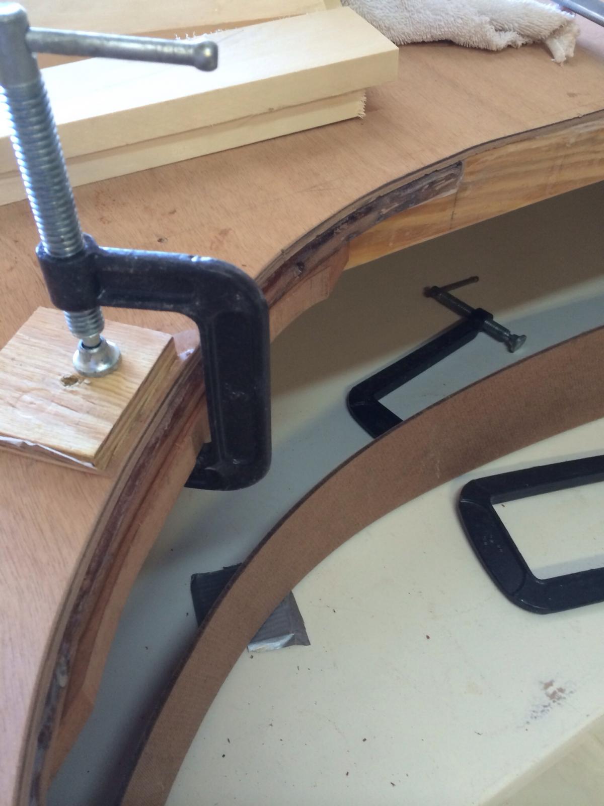

LennieG Posted December 31, 2014 Author Posted December 31, 2014 Thanks all. Howard and Paul- all makes sense and explains it. Dale- down to 2" front center, noodling around with coaming look. Sure am glad I am dry fitting first! David: Definitely dry fit a template IMO as I have wrestled with it for two days and the " peg board without holes", which is pretty pliable stuff, did not fill the voids well at all in the corners. I was glad I wasn't playing around with stiffer wood with epoxy kicking off. I still have another day of wrestling with the template, dry fitting and finding ways to clamp the corners. None of it seems as simple as I imagiined, but it will work out with patience and imagination. Quote

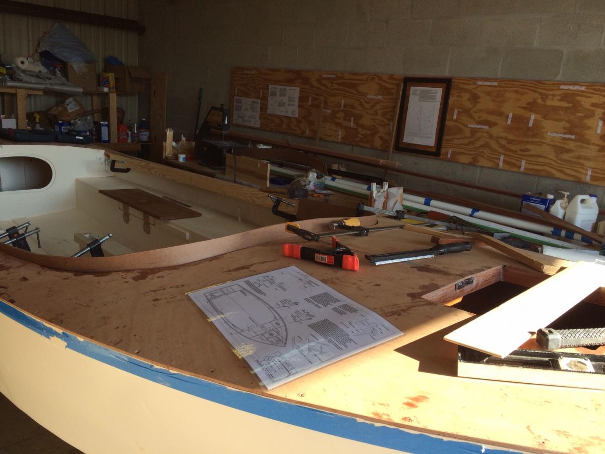

LennieG Posted January 7, 2015 Author Posted January 7, 2015 Inching towards completion with small steps behind me. Finished with coaming template, ordered 1/8" thick mahogany strips for coaming, framed out hatches, sanded off rudder, and added extra support for bend in coaming for better clamping and other misc. Closing in on it. Quote

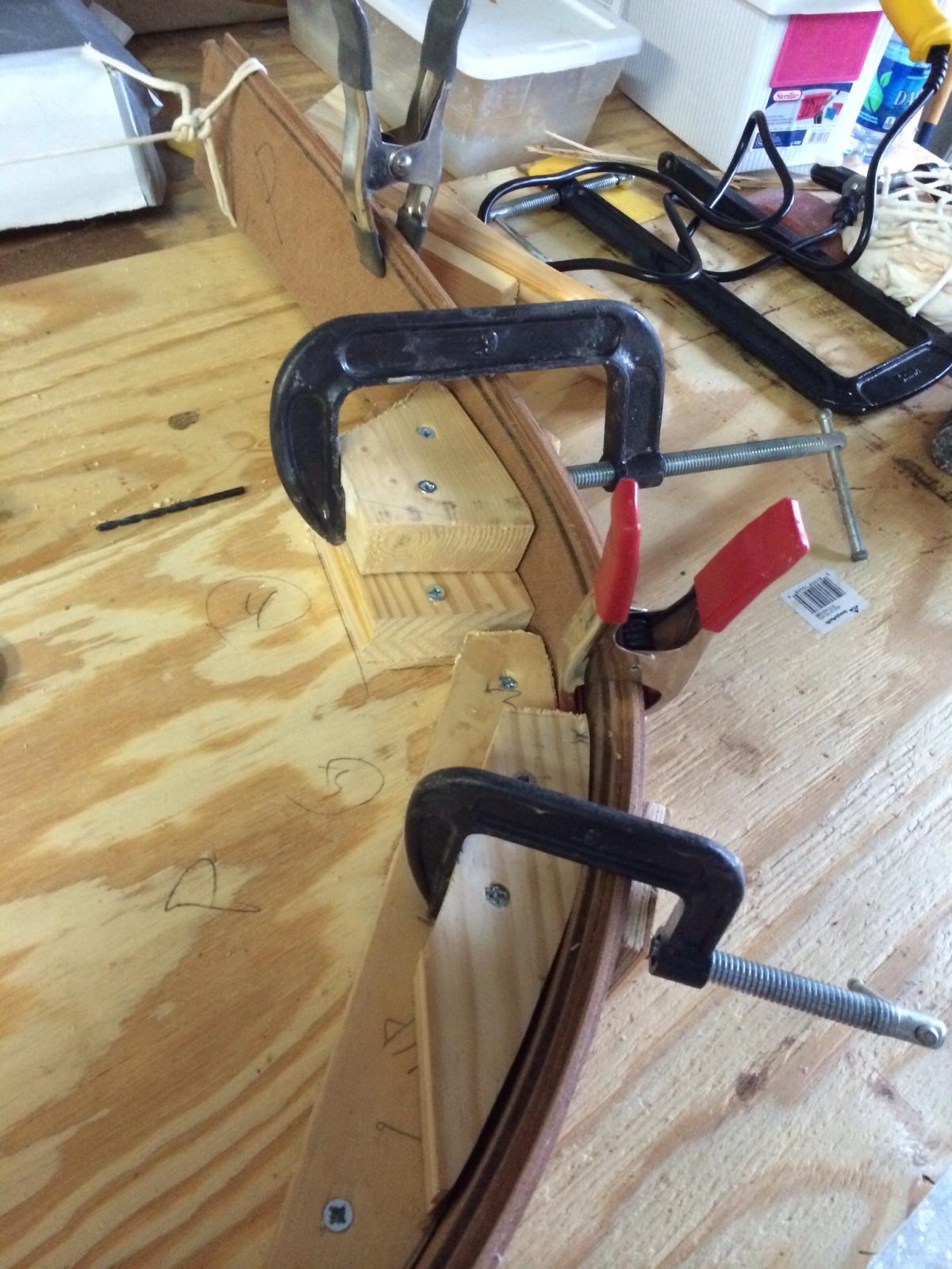

PAR Posted January 7, 2015 Posted January 7, 2015 When you dry fit the mahogany for the laminated combing, use a heat gun and get those corners good and warm. Heat more than anything else is what will do it. Once you do get the pieces clamped into place, wet them down with some denatured alcohol and hit them with more heat a few times, which will help them remember their "set" when unclamped for applying goo. Once bent, the wood will want to remember this shape, so the more time you can leave them in the setup, clamped, the more set the cells will remember when you have to remove them. Quote
LennieG Posted January 8, 2015 Author Posted January 8, 2015 Paul- Thanks very much. Having wrestled with 1/8" marmite or pegboard, which is fairly pliable, during template process, I can tell that the dry fit wil be interesting. I was originally planning to build the laminated coaming on a bench and then install, but feel it best to laminate on boat as rigidity would be my enemy. with the various twists and turns. Is the heat gun basically a hair drier or different animal? Thanks for your comments. I will follow them. I assume the first layer will be the hardest. Quote
PAR Posted January 8, 2015 Posted January 8, 2015 A heat gun is much hotter than a hair drier, usually the cheap ones will have two settings damn hot and really hot. You'll want the really hot setting (typically 500 - 700 degrees) and keep it moving. All the layers of the lamination will piss you off and fight nearly equally. Sometimes it's handy to setup a temporary jig to help the bend, something like "L" brackets that you can use to roughly hold the stock in place, as more pieces get shoved in. Once all are in relative position, clamp them to shape. The L brackets will permit some wedges to be driven in, to compress the laminate stack the last fraction of an inch. Lastly it's very difficult to bend stock in two directions at once (vertically and horizontally, for example). Quote

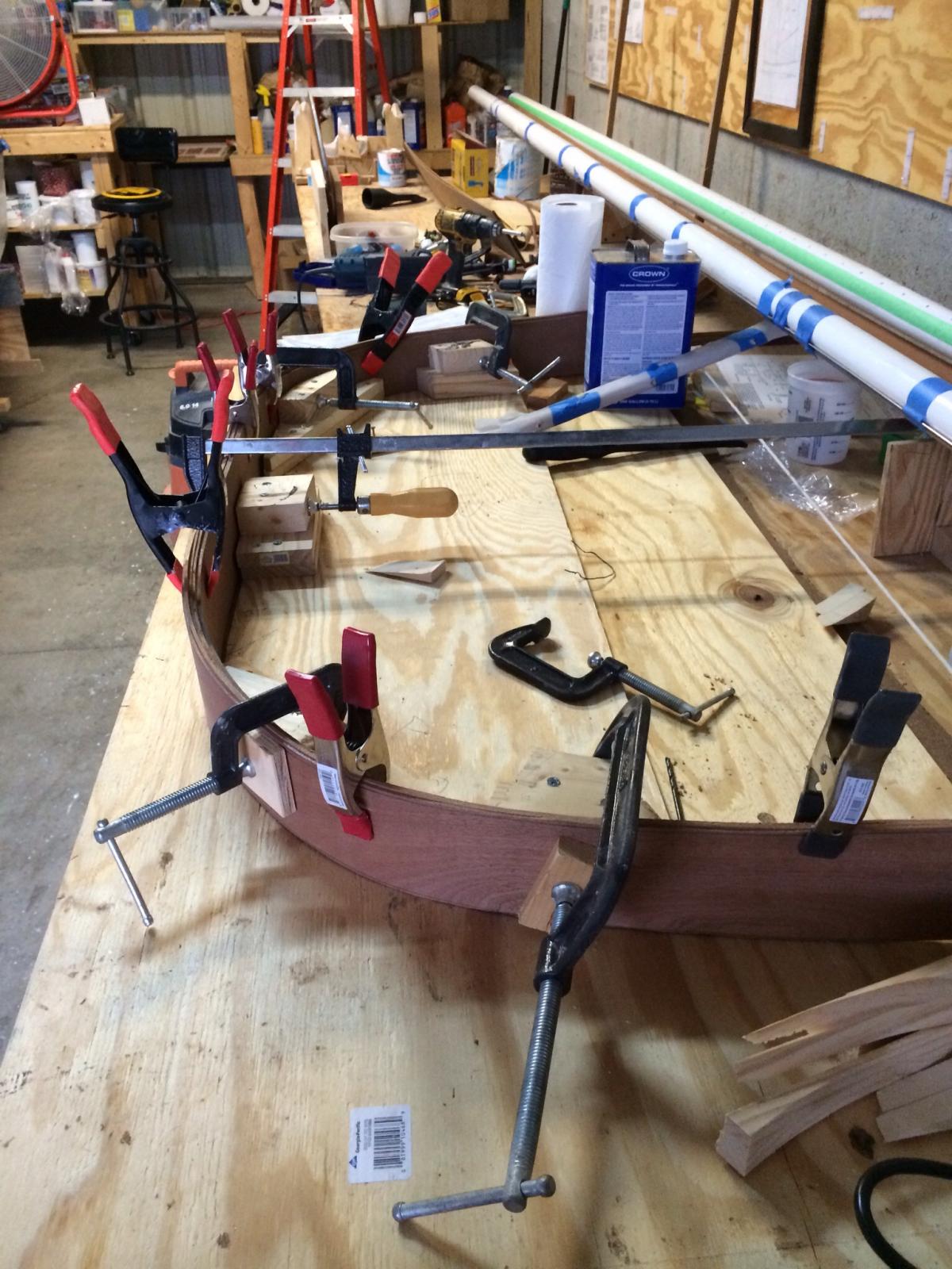

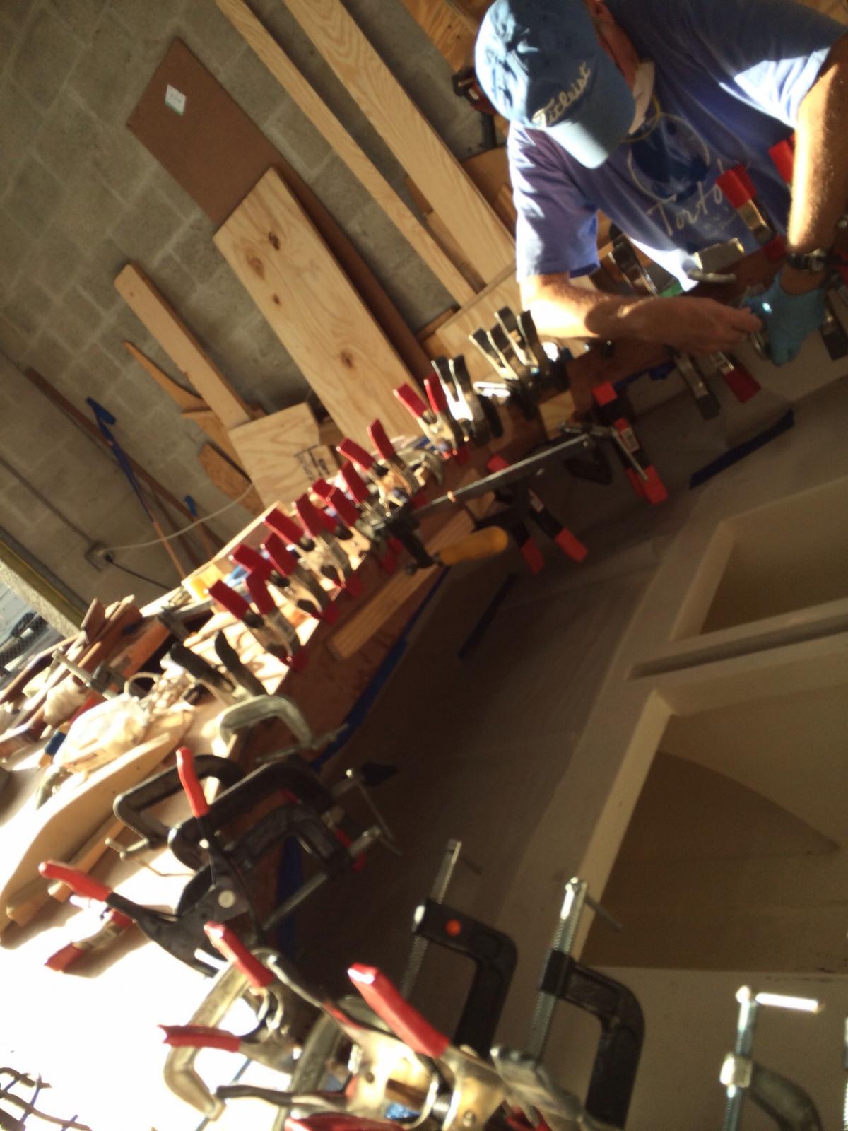

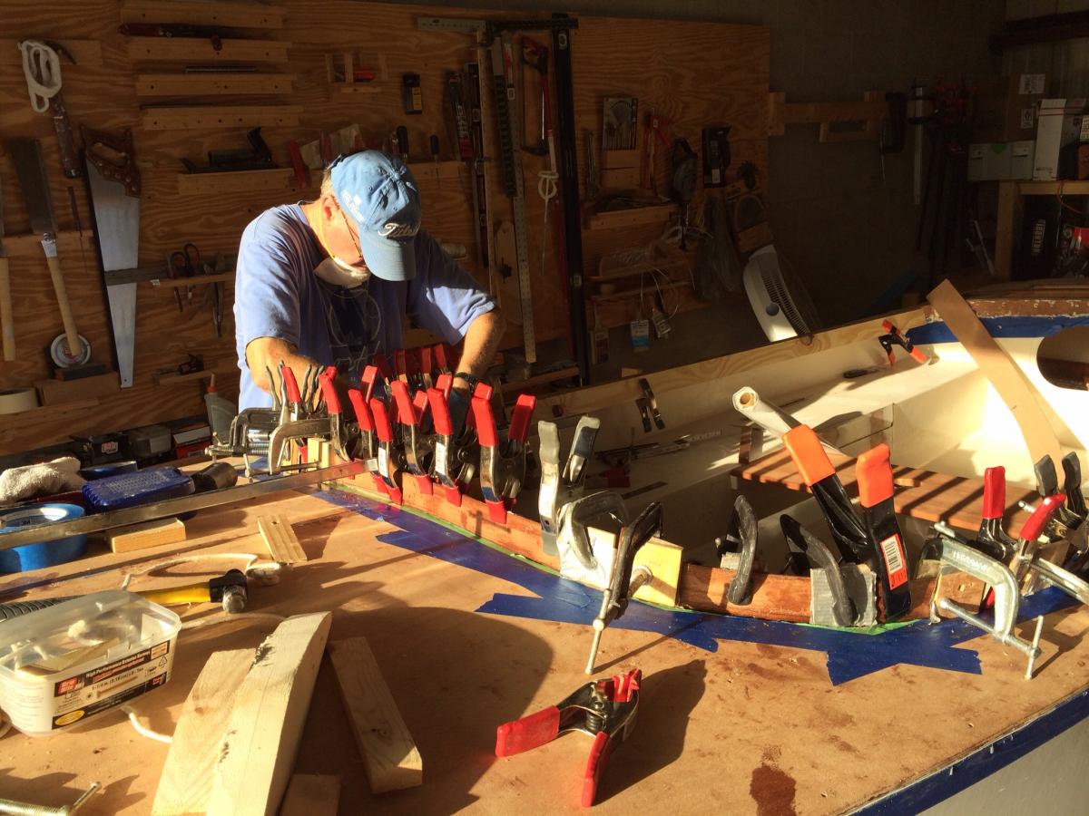

LennieG Posted January 13, 2015 Author Posted January 13, 2015 Had a fantastic day! Bill Palumbo worked with me for a full day.....thank you Bill! (DocPal , CS17 Petunia). We got the boat ready for coaming, mahogany cut , jig made, pieces clamped for memory and obedience. We didn't break any! Heat gun worked, mahogany pliant, alcohol rubbed etc...... Thanks to Bill and Paul for the guidance and help. Quote

Don Silsbe Posted January 13, 2015 Posted January 13, 2015 LennieG, Is that a fir plywood c/b trunk? If so, I suggest you sheath it with some 4 oz cloth. I have experiences RAMPANT checking on a little dinghy I built years ago. I coated it with West epoxy the first time, and MAS epoxy when I refinished her a few years ago. I'm planning to sheath it with 4oz this spring. Quote
LennieG Posted January 13, 2015 Author Posted January 13, 2015 The question confuses me Thrillbe.....CB trunk not shown in pics. The CB trunk is mahogany marine ply that came with the Kit, and I did sheath the inside w 10oz glass which is what I owned. Quote

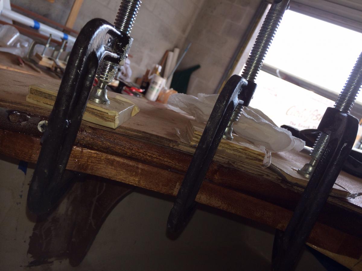

LennieG Posted January 14, 2015 Author Posted January 14, 2015 David- The only reason you won't catch up with me is the MA temps. The coaming is working out and the Saplele mahogany lumber is pretty great as far as bending without breaking. I had 6ea 1/8" 8 footers milled for $80. The sapele is pliable and workable. A friend and I got the first two layers on the boat today without issue, and 2 to go. I am not sure if it the most attractive mahogany but price and workability outweighs other considerations for me. I will spend another $40 for side pieces once I know this is going to fly. A new sheet of marine ply would have cost same or close all things considered like gas and/or delivery. Installing on the boat is a two man job. Further, I was not able, or didn't dare, to get the angle outboard at the corners. Another words, as you come forward from aft deck with the carlins or coaming, the angle is outboard ( top is outboard vs bottom of carlin or coaming). Plan calls for that outboard angle to continue thru corner and then get vertical at front section. Didnt happen. The corners are either vertical or slightly inboard. I did not dare to force tops out at corner, nor did I have adequate clamping leverage. All in all, working out as far as I know. Quote
PAR Posted January 14, 2015 Posted January 14, 2015 I'm glad you got 'er done, looks pretty good too. Sapele (Entandrophragma cylindricum) isn't technically a mahogany (Swietenia macrophylla), though it has some broad (Meliaceae family) relations which partly explains the marketing ploy. Because of it's interlocking grain, it bends better than most of the true mahogany's. This stuff should smell like cedar when you cut it. Quote
Docpal Posted January 14, 2015 Posted January 14, 2015 Thrillsbe, I think the picture you think is a centerboard trunk is really our bending blocks which were then screwed into a piece of 3/4" Fir plywood to make up the bending jig for the coaming laminations Quote
LennieG Posted January 14, 2015 Author Posted January 14, 2015 Thanks Doc- I was going to clear that up for Thrillsbe myself as it dawned on me later what he was seeing. Quote
