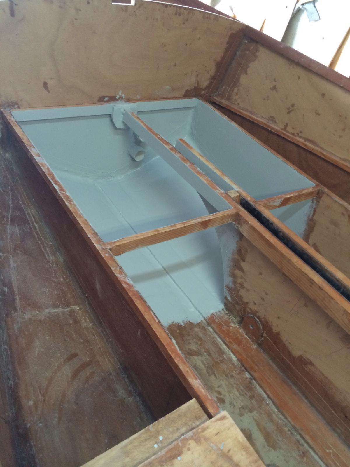

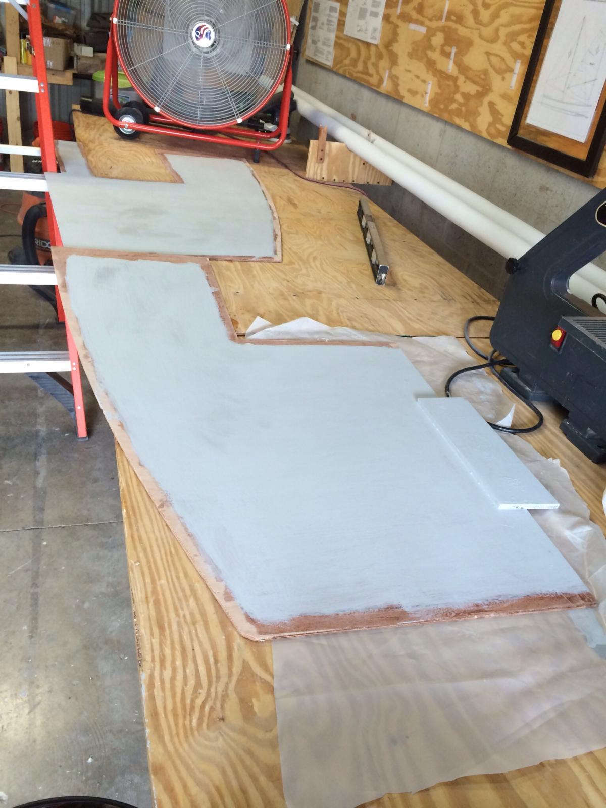

LennieG Posted August 15, 2014 Author Posted August 15, 2014 Back in the shop and making progress. I have 4 weeks before a vacation and hoping to make a serious dent in the build. Enjoying the System Three WR-LPU very much. The fact that one can put on two coats in a day speeds things up. I have three primer coats down on the aft cockpit and the underside of the seats. Plan on three topcoats today and tomorrow and also install the fore seats. Should be receiving the Honda 2.3 today or tomorrow and then will go to work on a motor well. The bad news and a question: seems I once again made the enamel mistake ( I can't believe it), this time on the masts. A bunch of sanding, cleaning, primer coat, sanding, and a couple finish coats with rustoleum professional enamel . It is already chipping and scratching in the shop from a little movement. I believe I will strip it and repaint with better paint. I have been told that with an etching primer, primer, then topcoats by the System Three tech folks that their paint (WR-LPU ) would work well. Do you agree? what have you had success with on masts? thanks Quote

LennieG Posted August 27, 2014 Author Posted August 27, 2014 I am working towards painting the cockpit which I hope to complete in next week. I am taking it a little slower than hull and hoping to minimize visible "seams" which has involved daily applications of fairing compound. Slow but hope it is worth it in the end. Each day I spread more epoxy/micro light mixture thinking I am done and next day see spots I missed. i hope to be doing the coaming in a month and getting ready to order the lumber. I have a good supplier of mahogany and other hardwoods who mills on site at a fairly reasonable price. Can anyone point me to resources for learning about doing coaming? I understand this very little at this point.....There must be a prior thread here but I can't find one and can't find thorough explanation in any of four Boat building books I own. i have a thousand questions- - what is the reasonable minimum # of seams on a cs17? - is 3/16 " mahogany a good choice? - do you laminate off the boat and then install or laminate and glue on the boat? - do you install and then shape or visa versa? - do you need to steam bend? - do you dye the epoxy so the seams don't show up like plywood? Shame to use a nice wood like mahogany and then have white glue lines. i know it's a vast topic and don't expect all the answers here......appreciate being pointed to a good resource.... thanks Quote
