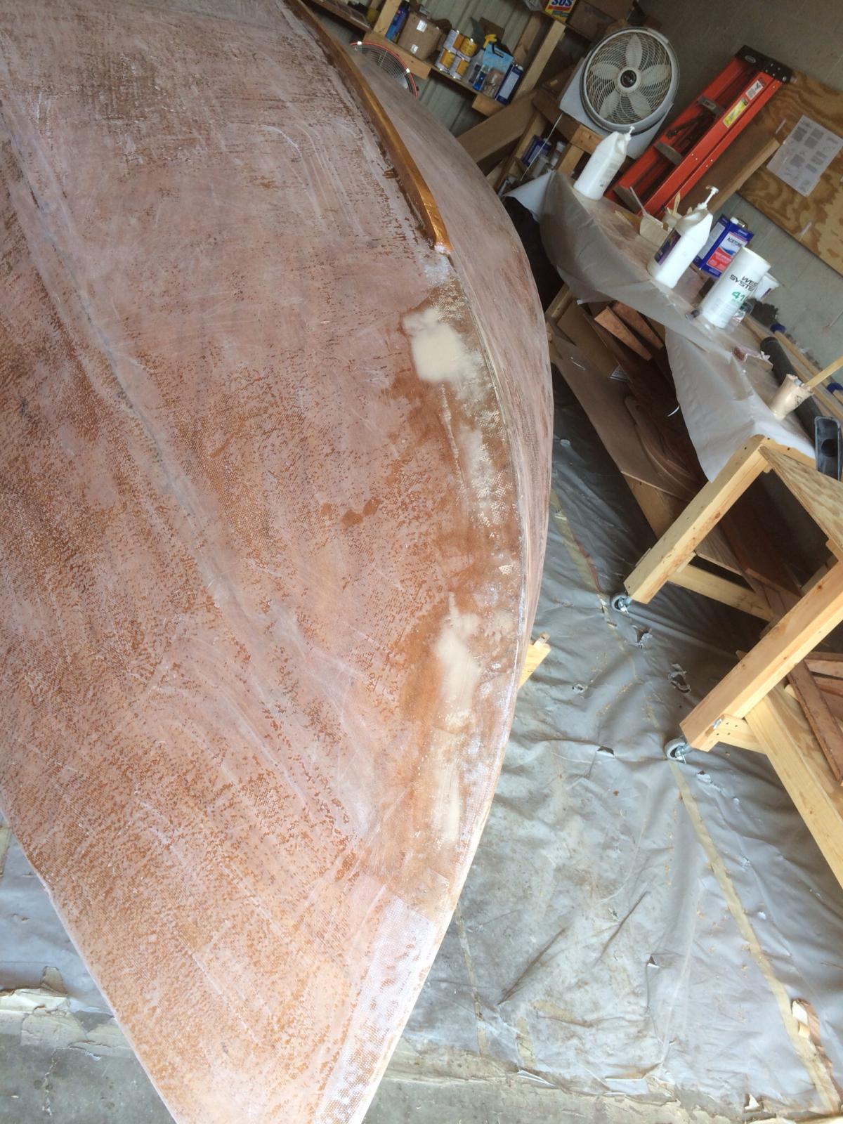

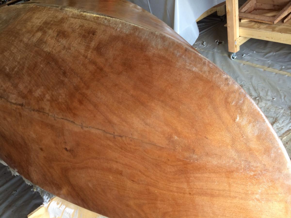

Added another layer of epoxy today. Boat looking good with exception of one section 18" by about 4', where the glass didn't adhere. I had sanded in this general area by hand prior to adding new layer of epoxy prior to glassing this side. I think I just learned the same lesson (dummy) about cleaning before sanding, and/or after sanding. In any event this section not right. I am assuming that tomorrow I can sand this section down to bare wood or close to it ( I did not add epoxy to this area today), then patch in new glass.
Would appreciate any red flags on that approach......
Thanks
The good side and bad side photos below:post-3404-0-25703500-1400697363_thumb.jpgpost-3404-0-07743800-1400697392_thumb.jpg
Yep, grind it down to known good material (get into the base epoxy coat) and try again. I (and others) have said it a lot, but the home builder should always assume a blush is present on cured epoxy, even if it's non-blush formulated. Preventing blush is easy, but requires more "forethought and planning" then typical home builder can employ or has at their disposal. I know a guy building under a tree in his backyard and wants to "control blush". I wasn't trying to be rude when I busted out laughing, at the mentioning of this request, but it's not a lot different than building in a garage, just less bird poop. Besides, the average home builder, just has horrible "building conditions" so dust, wood chips, bugs, the stray cat or two will all conspire to contaminate any coating (goo, paint, varnish, etc.) and you have to clean each surface for the next steps. It's lesson we all have to learn at some point - sorry it was your turn Lennie.

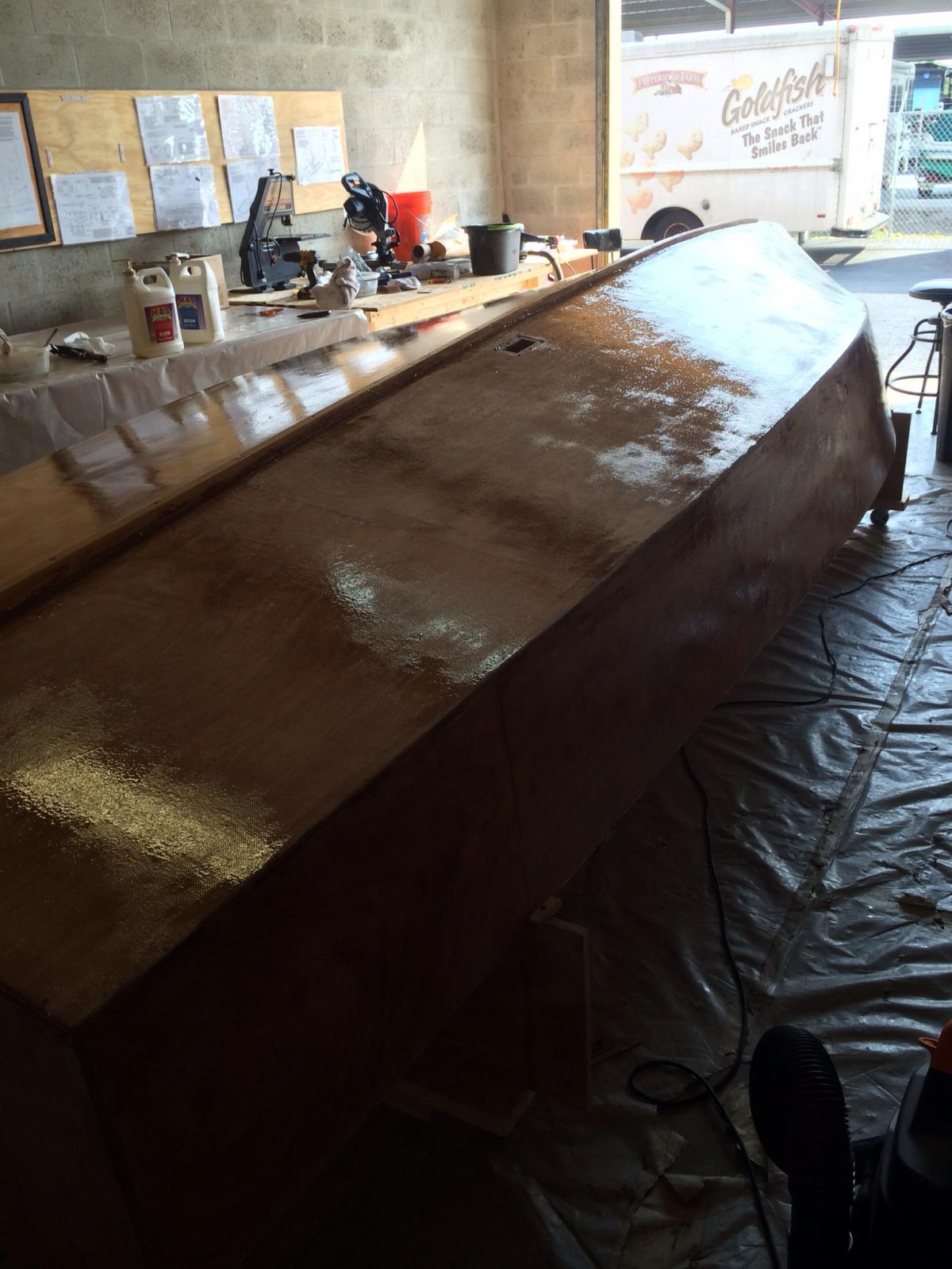

Glassing done....final epoxy coat on....bring on the 120 gritpost-3404-0-92966200-1400974120_thumb.jpg

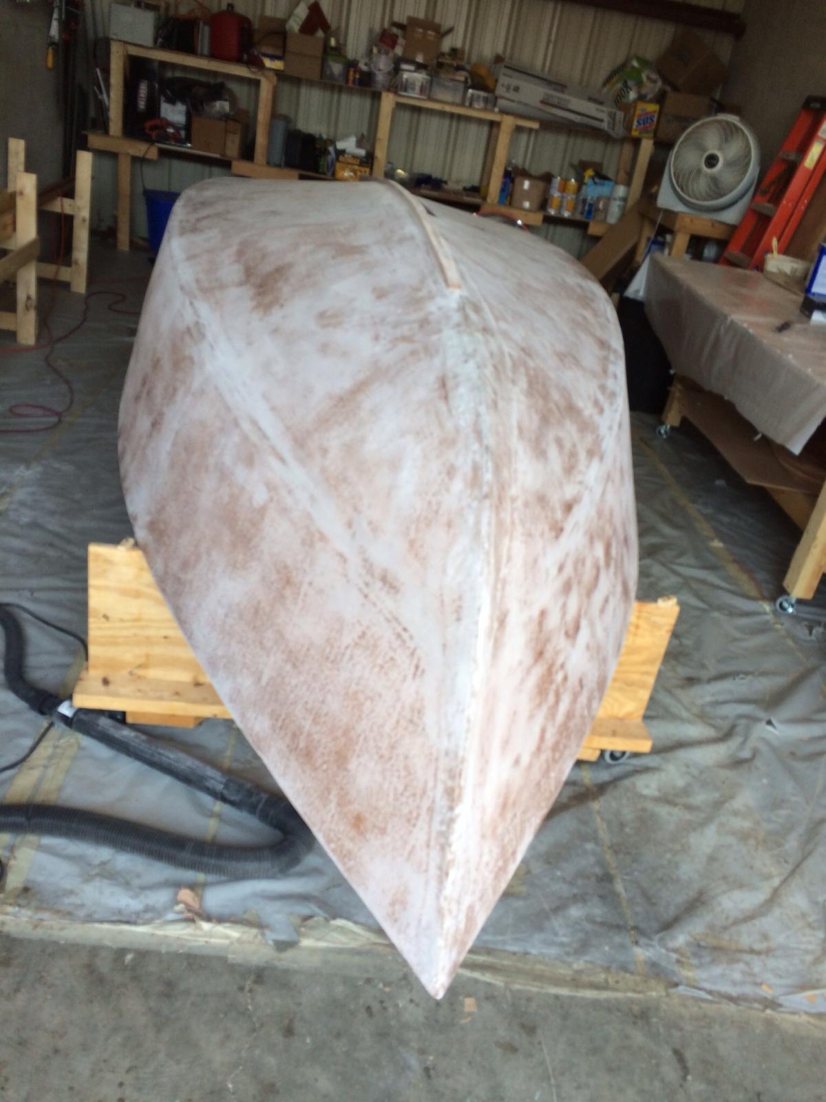

Final sanding done, and ready for paint week. I cannot say enough about the Festool Random Orbital sander. Despite the drudgery of sanding, this tool is worth the extra money and it "hums", it is light and is easy on the hands and connects up easily to a box store shop vac for a pretty much dust free job.

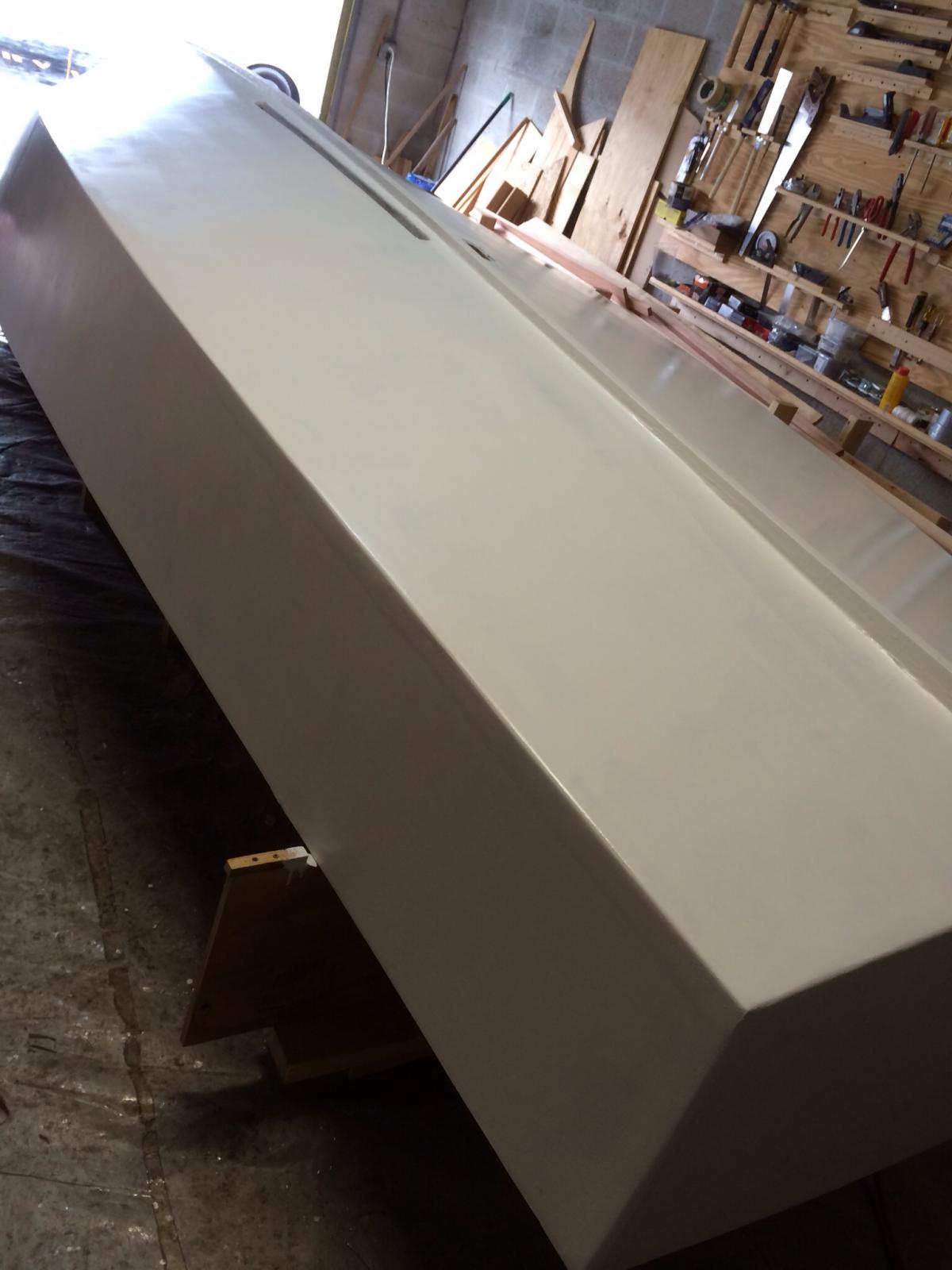

Three coats of primer on, and looking pretty good. One or so to go, then moving on to the enamel.post-3404-0-50162100-1401744383_thumb.jpg

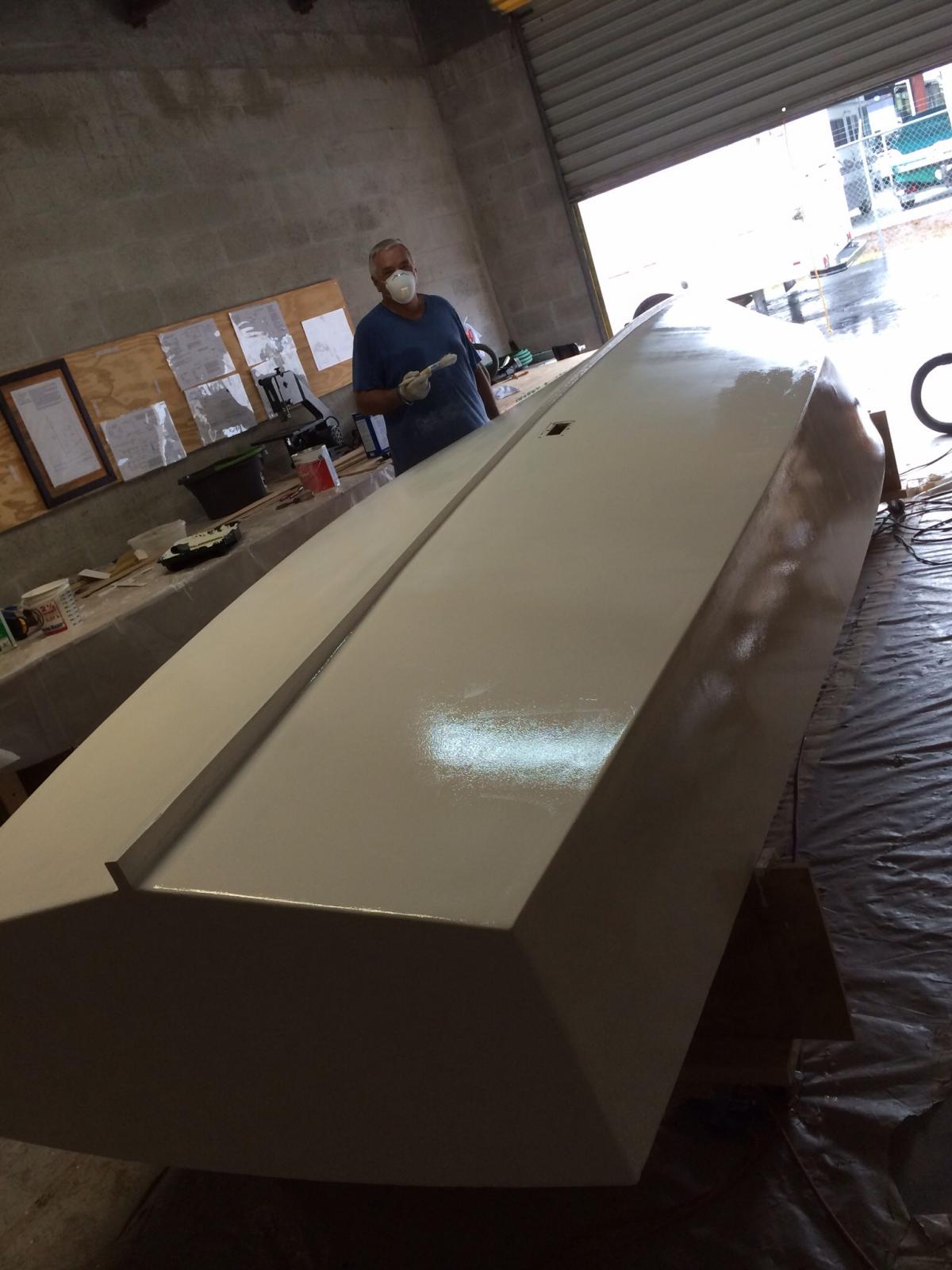

First coat of oil -based enamel semi-gloss (Interlux) is dry and looks ok. Second coat going on tomorrow and third and hopefully final coat (I did four coats of Interlux Pre- Kote primer) will be Monday.
I do see many brush marks. The jury still out on my Roll and Tip skills. Tomorrow's refinement will be thinned paint and lighter touch.post-3404-0-06573300-1402104340_thumb.jpg
