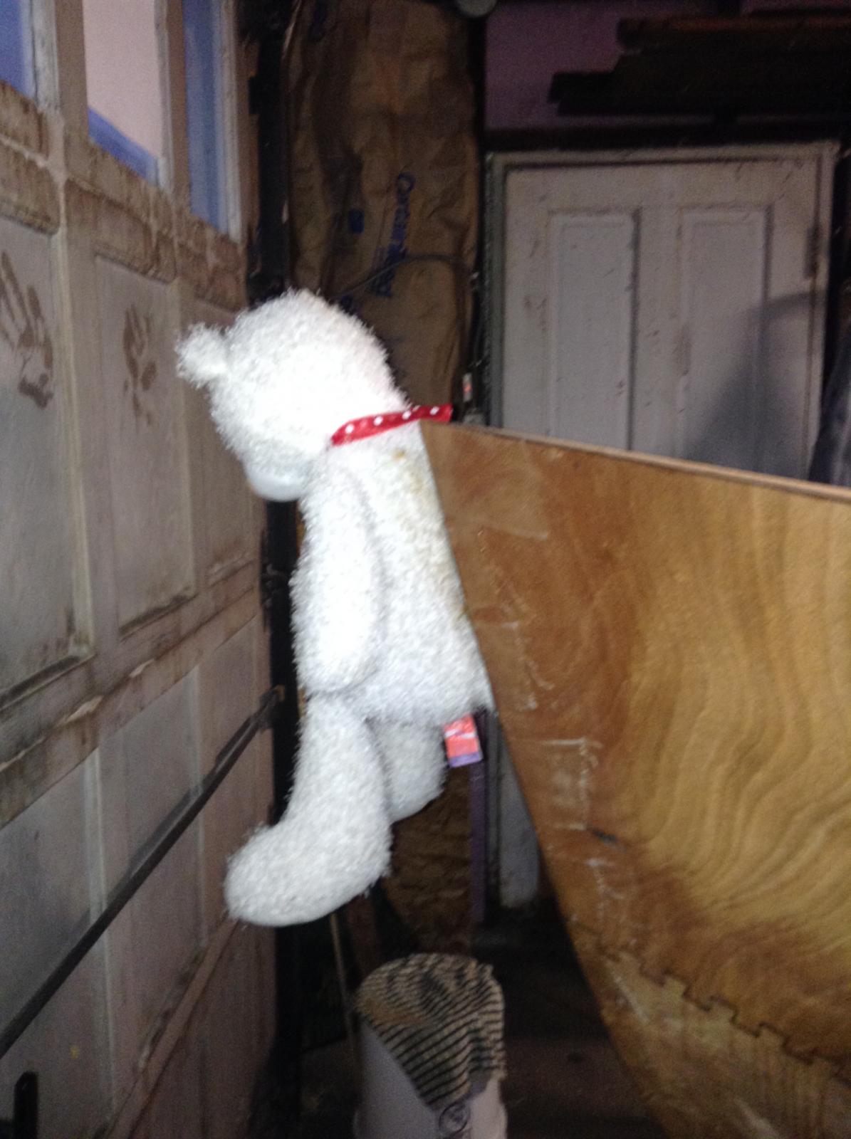

Hi all, Still filleting and taping filleting and taping. We put together the hatch assemblies and will install them next. Still need to do the keel batten We have a white teddy bear designated to be the figure head. He/she will be epoxied with any leftover we have at the end. Tru wants to install a mini-fridge and hard wire a boombox into the forward bulkhead. Still working on the gunk-holer aesthetic with him. We need to paint the insides of the compartments soon so we can put seats in. -M and T, the boss!

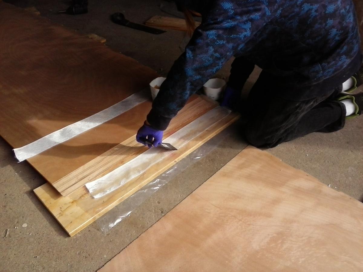

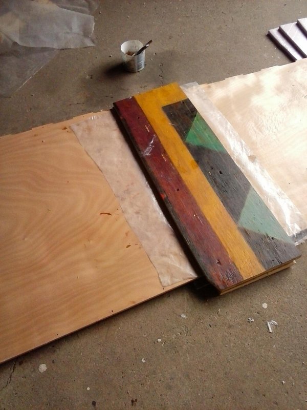

Here is a pic of our inwales going in. went pretty well. we had some old very straight grain fir that was 12 feet long, so we needed a scarf joint but that worked out great. so far so good. transom pieces today perhaps. some taping and filleting.
