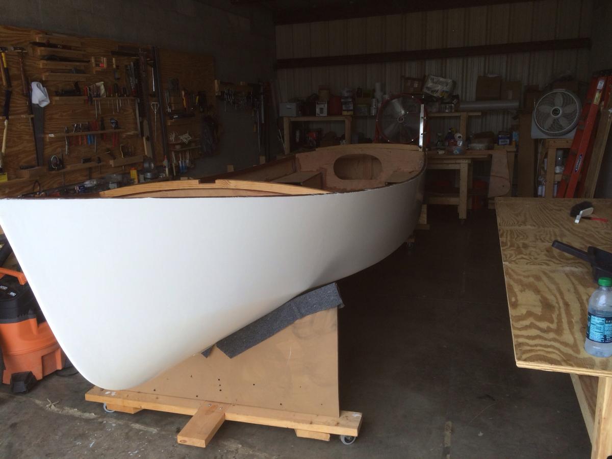

PAR Posted June 8, 2014 Report Share Posted June 8, 2014 You'll have to wait a while (3 weeks), for the paint to fully cure, but you should be able to compound and buff the brush strokes out. I do this on repairs, when I have the time. A rough cut and fine cut compound does most of the work, then regular buffing. You can also do it by hand, starting with 400 grit and working up through 1500, before pulling out the buffer. Basically you block sand (400, 600, 800, etc.), knocking down the humps of the brush strokes, then buff smooth. Quote Link to comment Share on other sites More sharing options...
LennieG Posted June 10, 2014 Author Report Share Posted June 10, 2014 Final and seventh coat of enamel on and looking pretty good. She won't be a show boat due to fairing step, or lack of, but she is really looks ok and glad I used the enamel and thanks for all the advice here on paint. Going to do some projects while she cures for a couple weeks.....paint masts, rudder, source hardware, tiller, tiller extension, new cradle supports, install hardware and track on mast, paint CB etc. Any advice on hardware manufacturer (Ronstan, Harkin etc), material or suppliers? Thanks Quote Link to comment Share on other sites More sharing options...

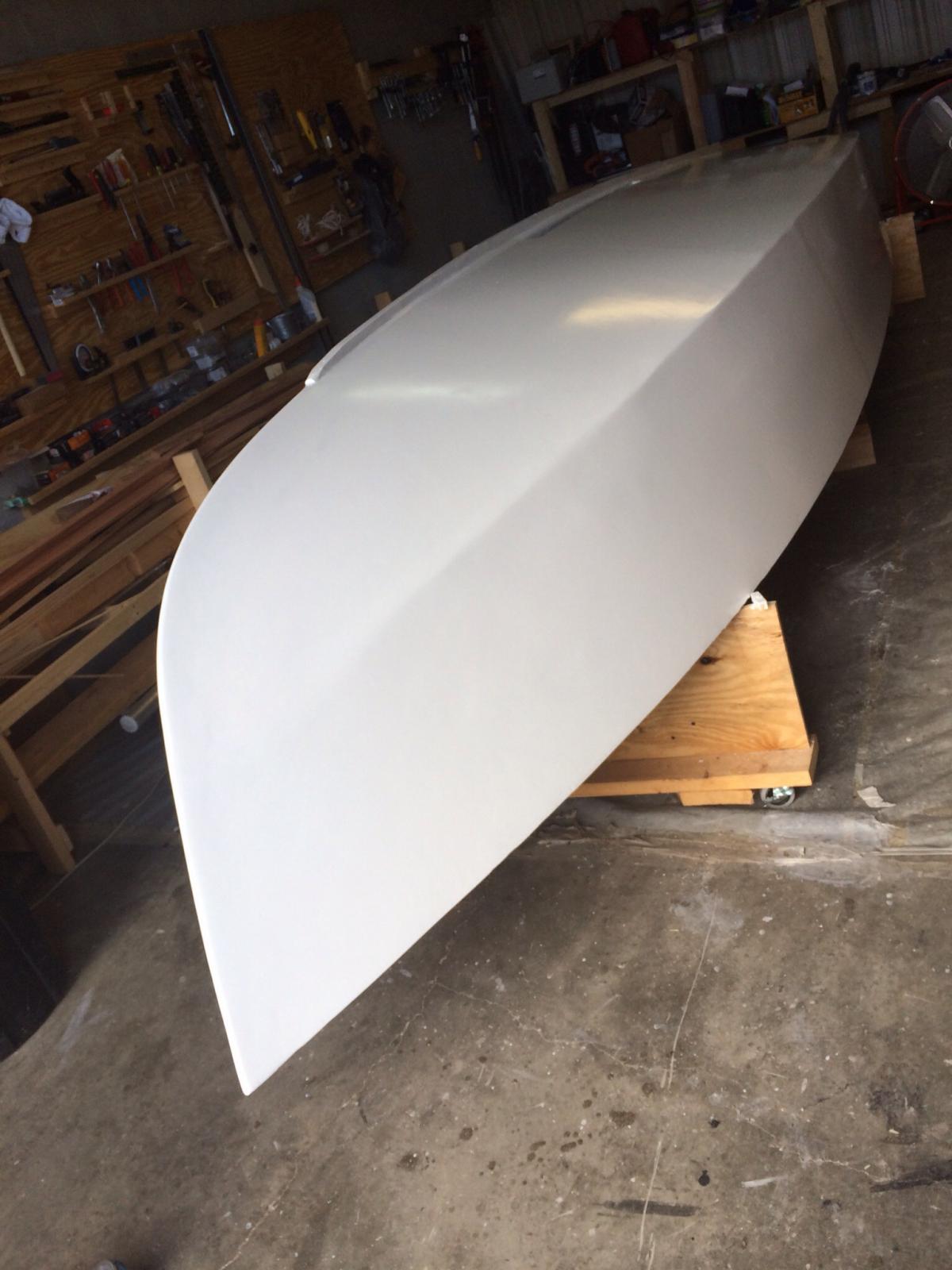

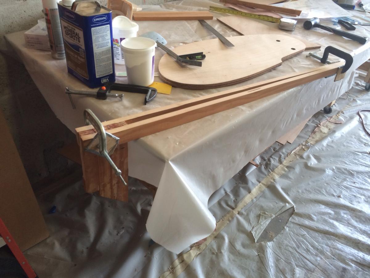

LennieG Posted June 14, 2014 Author Report Share Posted June 14, 2014 Glad to be back at projects involving cutting wood and building things...... Quote Link to comment Share on other sites More sharing options...

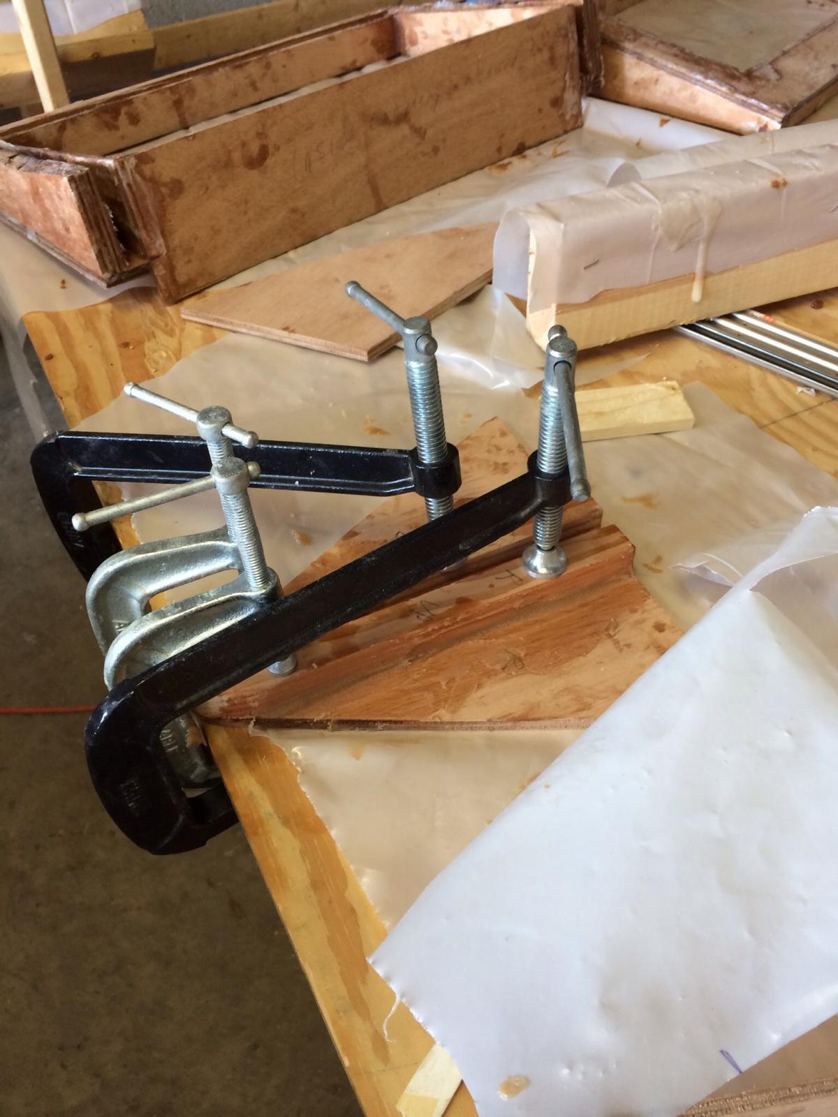

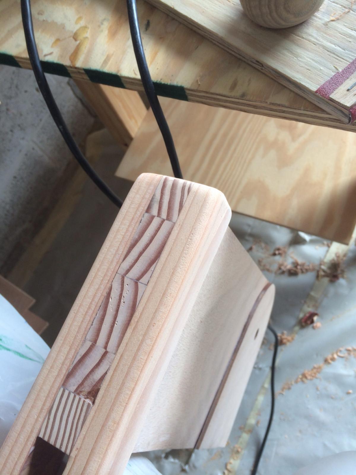

LennieG Posted June 17, 2014 Author Report Share Posted June 17, 2014 Getting the small projects done before the flip. These are the things that are the head scratchers for me (rudder, like the CB trunk had been, or the seat hatch covers). Within a day or so of finishing them up and moving onto the masts and the second flip. Quote Link to comment Share on other sites More sharing options...

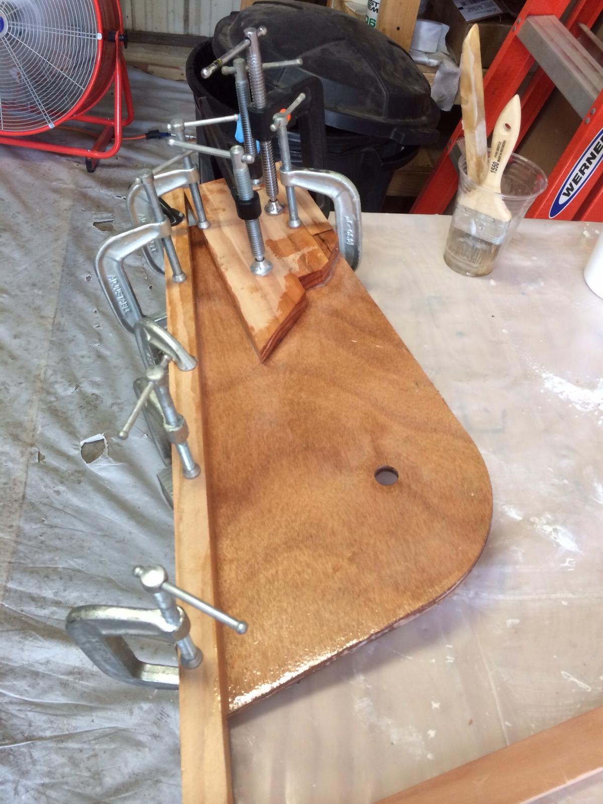

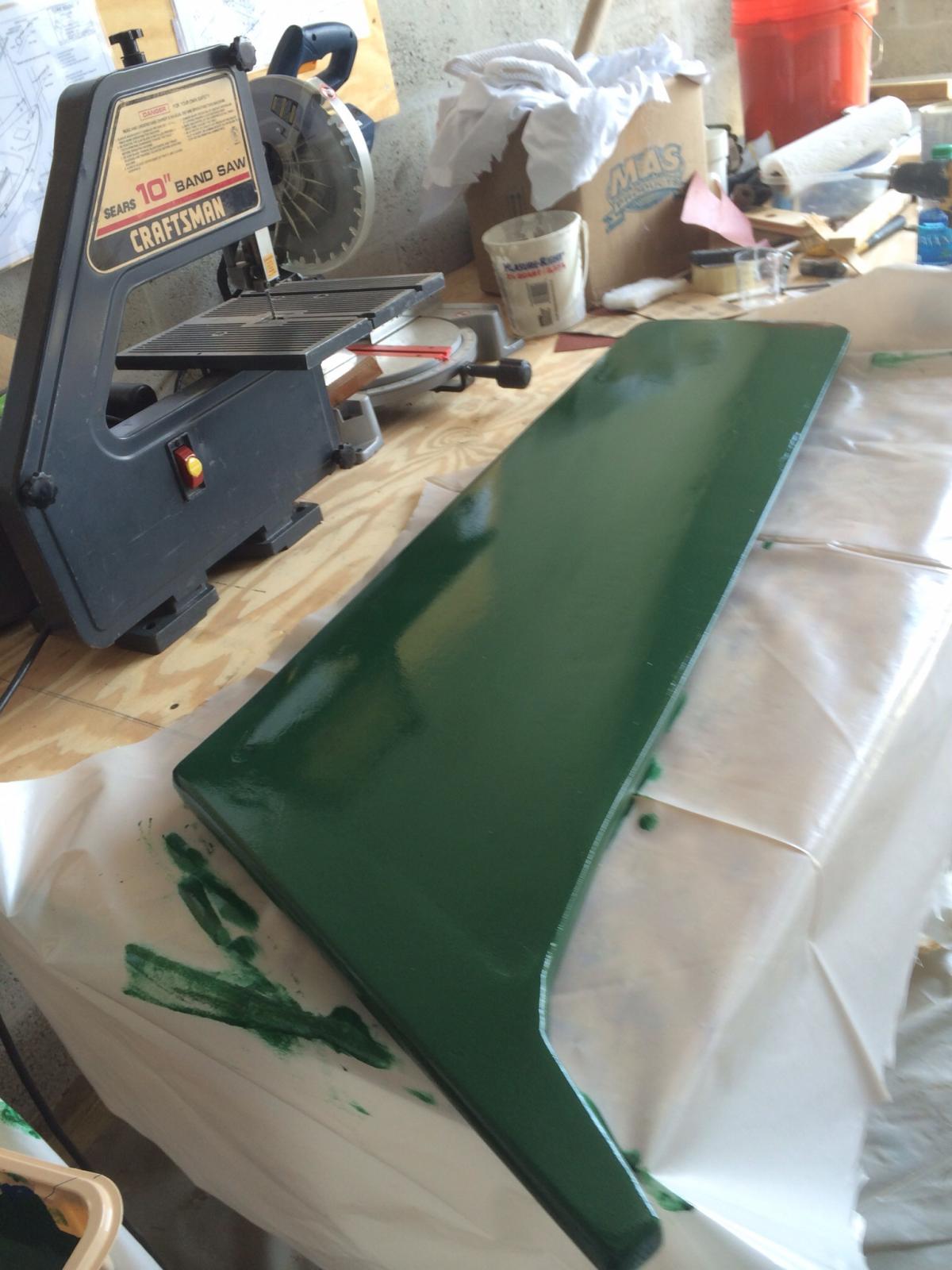

LennieG Posted June 18, 2014 Author Report Share Posted June 18, 2014 Te rudder is looking pretty good.....this photo really distorts it. Quote Link to comment Share on other sites More sharing options...

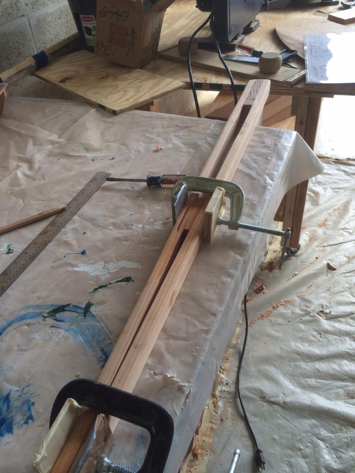

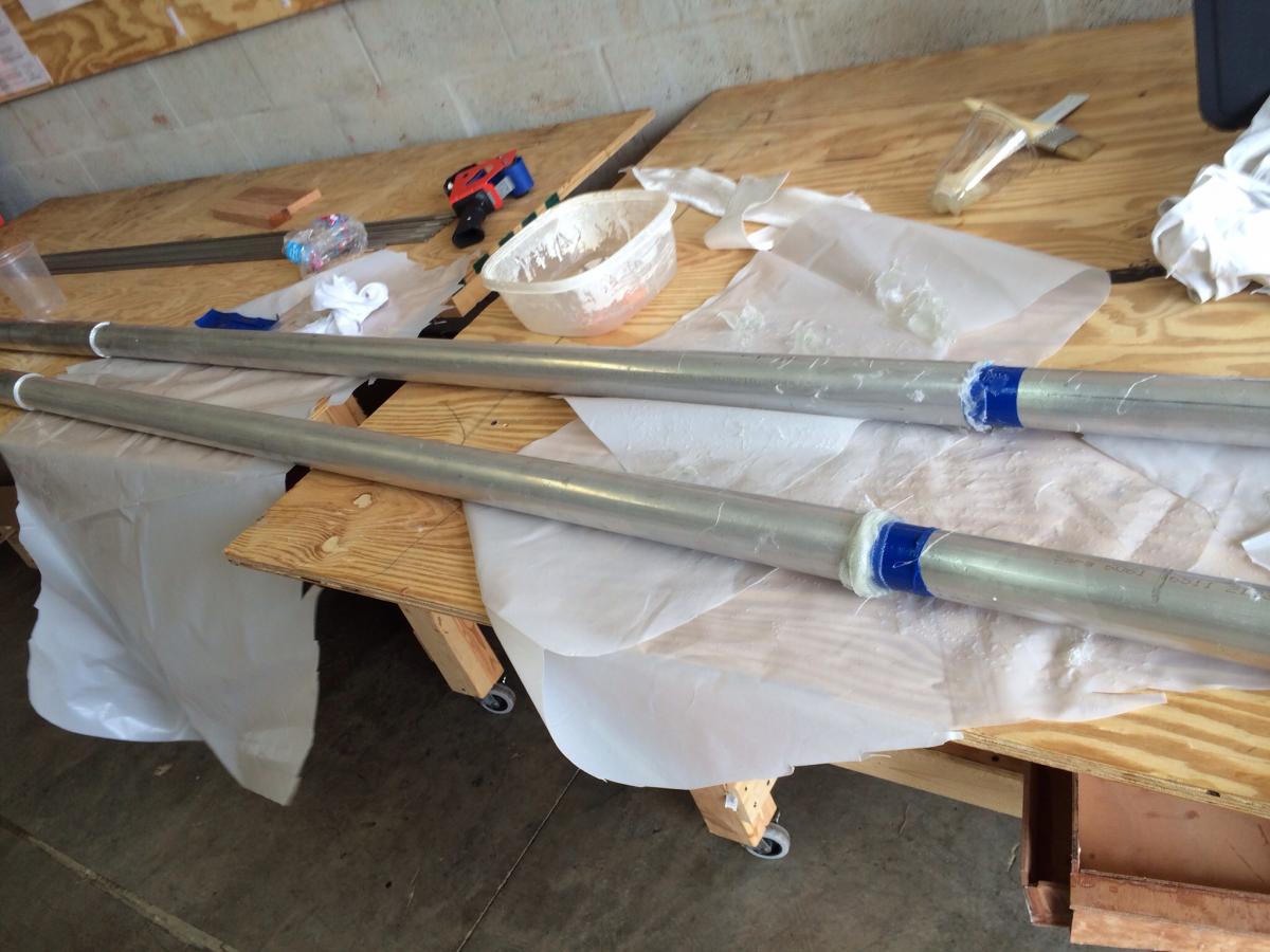

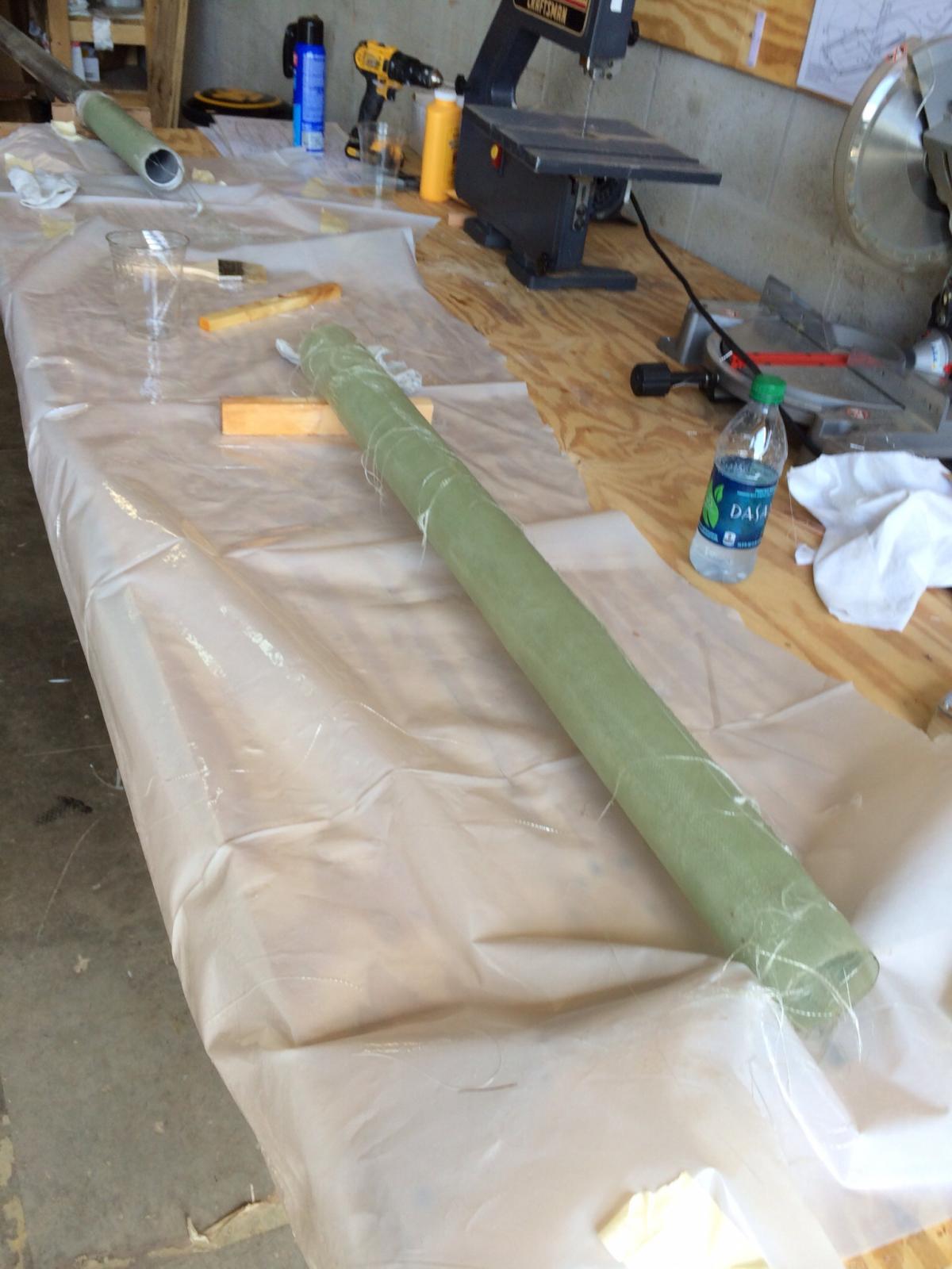

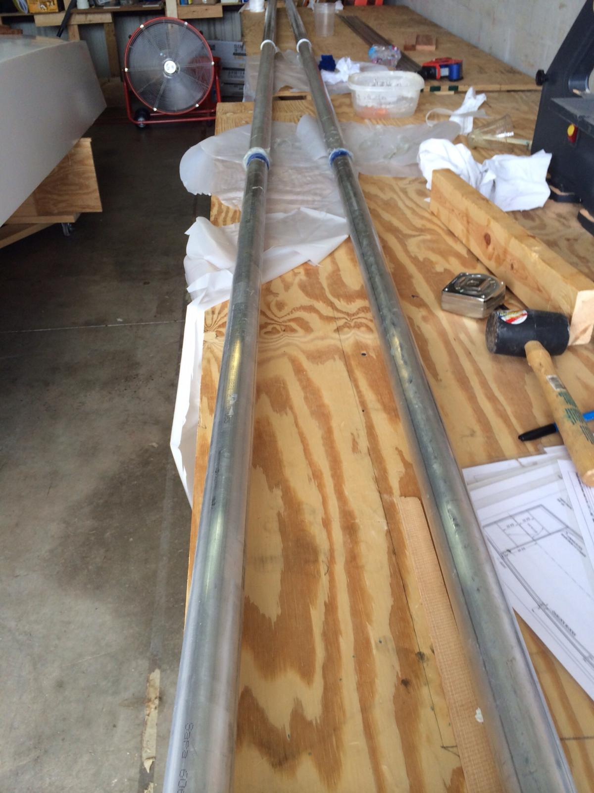

LennieG Posted June 24, 2014 Author Report Share Posted June 24, 2014 Just about finished rudder and tiller last week..... Â assembled mast tubes today....bottom and second one tight but easy to pound in wet no problem. second and third loose but filled with wet tape which got pushed out mostly...hoping it cures with good bond and tape and goo on outside will firm up enough. Will need to add wood sections on top. Quote Link to comment Share on other sites More sharing options...

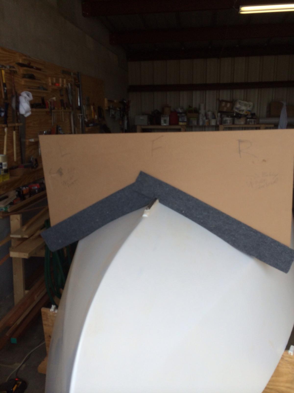

LennieG Posted June 26, 2014 Author Report Share Posted June 26, 2014 Second and hopefully final flip today.....picking up steam. Re did cradle supports which had mostly fallen apart. To future builders. I would recommend you use good solid1/2 " or  3/4" ply right up front instead of  the kit crate box MDF (which I have decided when cutting stands for Much Dust Flying). Hoping to finish by the October Mess-about and thinking of a launch then. This is a ball Quote Link to comment Share on other sites More sharing options...
LennieG Posted June 26, 2014 Author Report Share Posted June 26, 2014 Correction: the crate wasn't MDF ...the MDF was from attempted router jig. The crate was some kind of particle board and fine for its purpose but recommendation stands: Good plywood or MDF( if breathing isn't a priority. ) Quote Link to comment Share on other sites More sharing options...
LennieG Posted June 26, 2014 Author Report Share Posted June 26, 2014 Flipped and leveled today. Had the help of friends and local storage room guys and appreciated their help. boat is looking good! Quote Link to comment Share on other sites More sharing options...

LennieG Posted July 3, 2014 Author Report Share Posted July 3, 2014 Spent last four days looking at boat. No, only kidding....been doing the small jobs that take time: mast, mast step prep, re-do of hatch seat covers, etc. Lesson learned for future builders: the first mast tube I did a couple days ago had no prep on mast. It took literally 45 minutes for me and another guy to pull it off the mast. I didn't think it was coming off frankly but with pulling, twisting, clamping, and grunting we finally got it off. Actually the plastic stayed on mast and we were pulling the tube off the plastic. Second one today I sanded mast, wiped it with acetone and put a small amount of talc on the mast. As I was leaving shop I gave a pull to plastic and it was coming right off mast, so only way to go, unless we have trouble getting plastic off tube. Thanks in part to Rogue Paddler blog Quote Link to comment Share on other sites More sharing options...

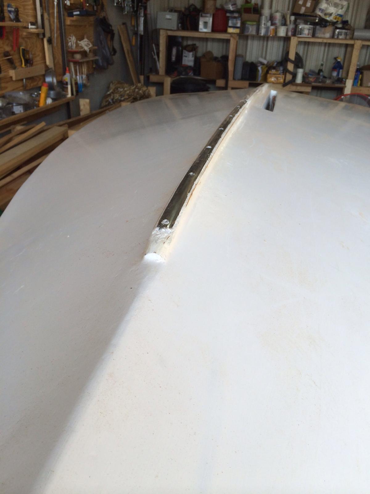

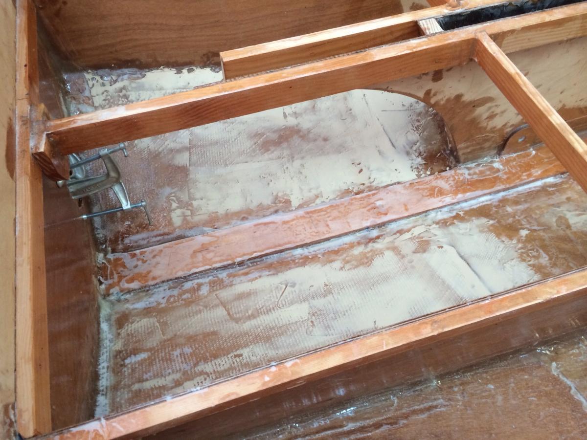

LennieG Posted July 25, 2014 Author Report Share Posted July 25, 2014 Been working on the small stuff for past month and making good progress with the hours I have had available, and the willingness to work in 95 and humid degrees. Will post pics soon when I have some actual noticeable change. i am trying to get good or at east fair at fairing while doing the cockpit so, unlike the hull, it looks pretty and professional. If you haven't read Paul's Tips  (PAR) you really should....they are excellent! So I am practicing fairing under the seats where it won't be seen. Question: i will be using an exterior latex on cabin as per advice here. Can one add a coat of latex to see what you've got, fair and sand, then add another coat without removing the first coat? Another words can you add epoxy/ talc/ fairing powder over latex? thanks Quote Link to comment Share on other sites More sharing options...
PAR Posted July 25, 2014 Report Share Posted July 25, 2014 No you can't fair over paint, you have to take it down to the epoxy coating. This said, you can smooth the paint to refine the fairing, using fine and very fine grits on a long board. Quote Link to comment Share on other sites More sharing options...
