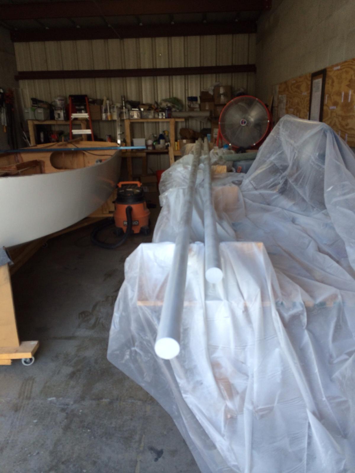

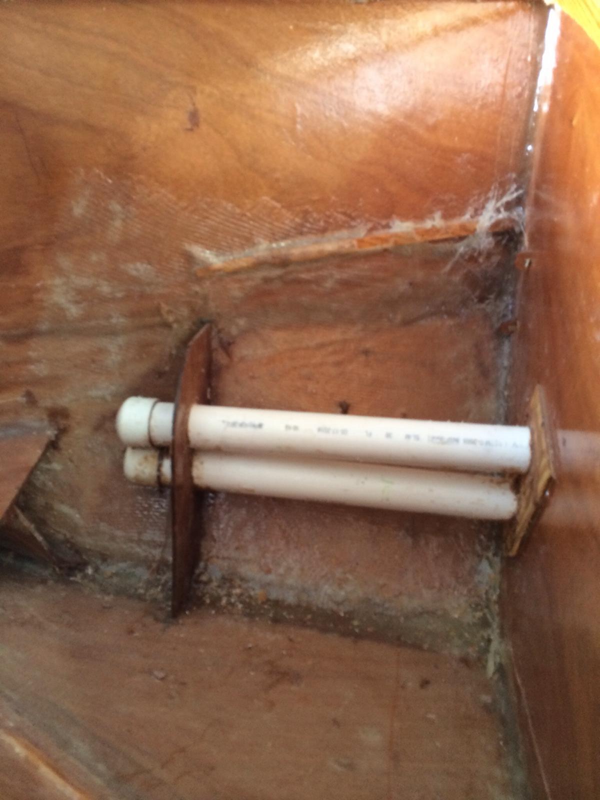

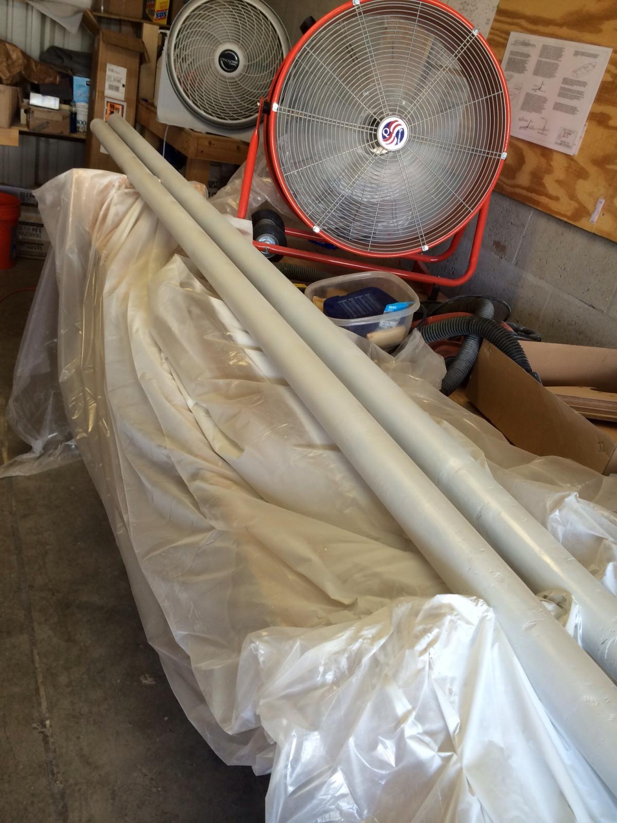

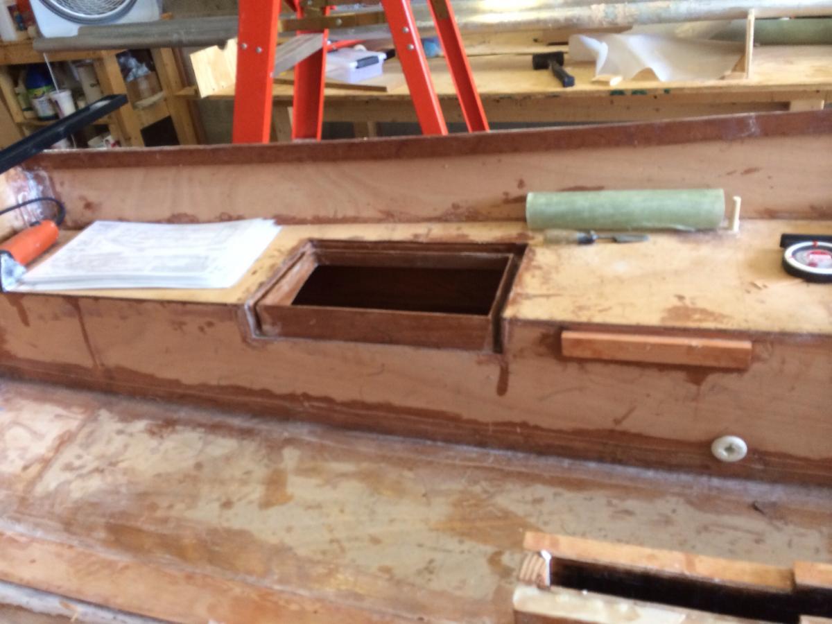

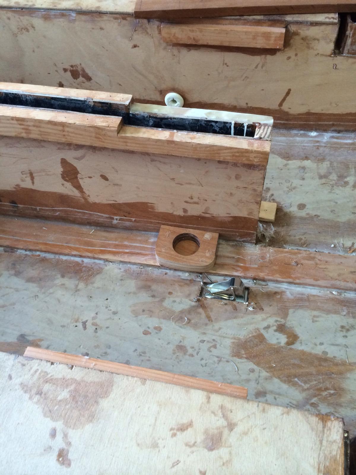

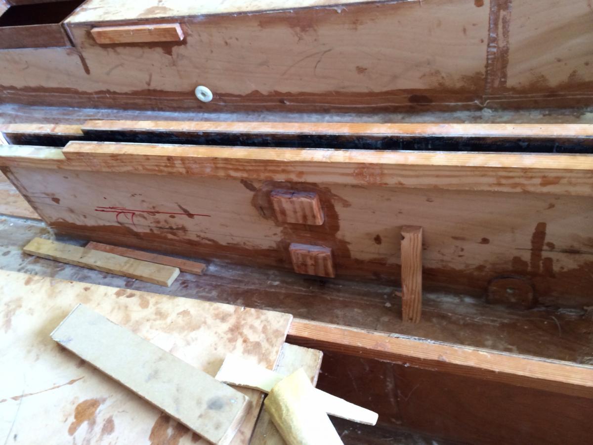

LennieG Posted July 27, 2014 Author Posted July 27, 2014 Here are a few pictures from last months progress: - masts assembled and primed. - oar storage done - seat hatches in - fore mast step in - aft mast step put together - The last picture is me from a beach party Friday night. I had decided to get down to one drink per night. Â Have a good couple weeks! Quote
