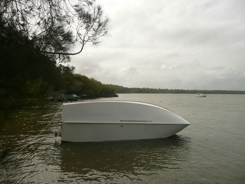

Some photos from my capsize test years ago showing how high the boat floats and how little water is left when righted. Cheers Peter HK

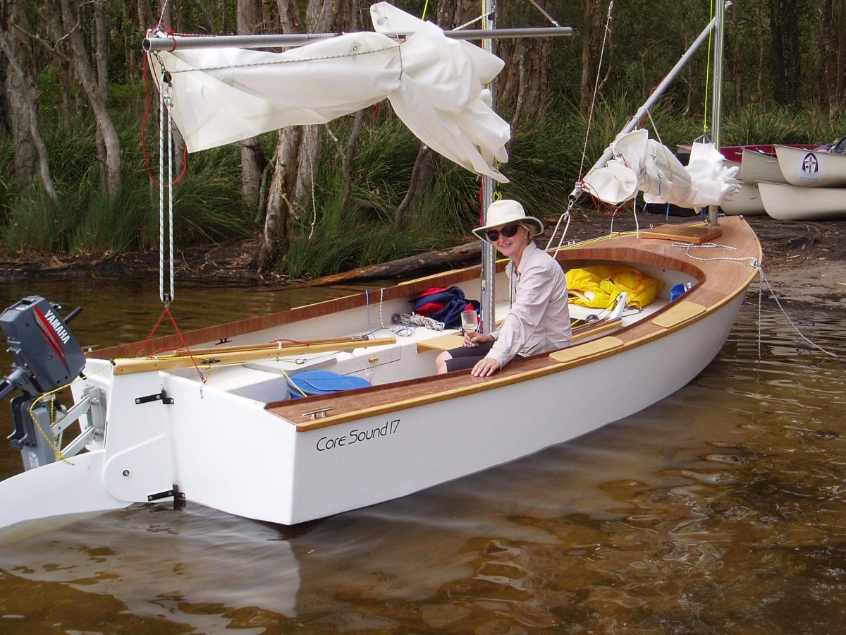

For using the halyard as a "running backstay", I fitted a couple of horn cleats under the coaming in what I felt was a good position to balance the pull of the staysail halyard at the mast top. Fairly quick and easy to use and nothing's caught on them so far. You can just see one in this photo. I also put a horn cleat on the mizzen mast to hold the halyard when not in use. I made the halyard just long enough to allow me to hook the snap shackle over the lower horn of the cleat and cleat off the tail with a couple of turns around the cleat. Cheers Peter HK
