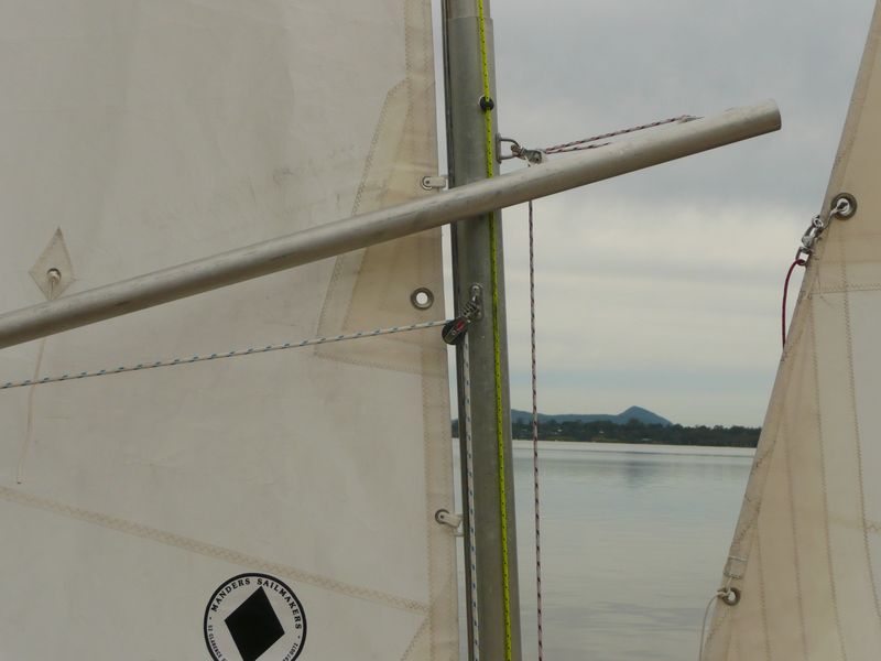

I think you might not have fully understood my explanation. Essentially on a spritboom the sheet can be led to a cleat aft on the boat (as in my example with a block and cleat on the tiller) or a cleat forward by running it along the boom, down the mast and to a block or fairlead with a cleat within reach of the skipper so that he can handhold the sheet when necessary and cleat it when it is appropriate to do so. I generally prefer my sheet to be led forward if I can ...it feels more comfortable to me than reaching aft to a sheet...but either can work. What doesn't work on a spritboom is the sheet led to the centre of the boom and down to cleat near the centre of the boat as the sheet interferes with the sail on one tack. Of course this method works well on a standard boom. Cheers Peter HK -

See above photos The sheet goes from traveler to end of boom , along boom, down the mast and finishes at a swiveling cleat. In a Spindrift 11 you'd have to then run the sheet back aft to a cleat somewhere- not sure how that would work. Cheers Peter HK -

On one boat of mine ...a Welsford Golden Bay dinghy...I ran the sheet from the aft end of the sprit boom to a stand up block on the rudder above the pintles (so as not to bias the weather/lee helm) and then onto a clam cleat on the top of the tiller. It works OK and If needed I can go to 2 purchases as I have a block on the boom end and a becket on the stand up block so I can attach the sheet to the becket. On my CS17 I run the sheet along the sprit boom and down the mast to a swiveling cleat at the mast base. Overall I prefer having a sheet forward. Cheers Peter HK -

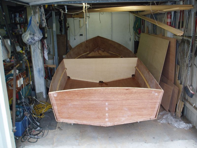

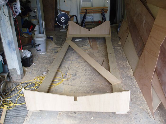

I'd certainly also recommend an hour or 2 of thought into the best building sequence. I built a CS 17 between 2006-2009. I had a small garage in which to build it - length 19.5 ft. You can see why I didn't build a CS20 I also realised that when I had a hull in the garage that I would have little or no space to build all the other stuff- wooden topmasts, rudders, rudder box/tiller, centreboard, hatches etc. I decided to make a decent table out of a couple of sheets of exterior half inch ply to do the lofting and scarfing of the hull panels on and then build the cb/rudder etc on it. When that was done I used some of the half inch ply sheets to build the mobile cradle which held the hull until completion. I remember that a good table and work area was great for the little stuff and it was also a good feeling to pull all the pre-prepared stuff out of a corner and just fit on the hull when it was ready. I know a spindrift 11 is a much smaller project and maybe you have oodles of workspace but I'm sure a bit of careful thought will save some time/energy and frustration (why didn't I do that before!) Have fun with the build...I love the finished product but really enjoyed the journey. Cheers Peter HK

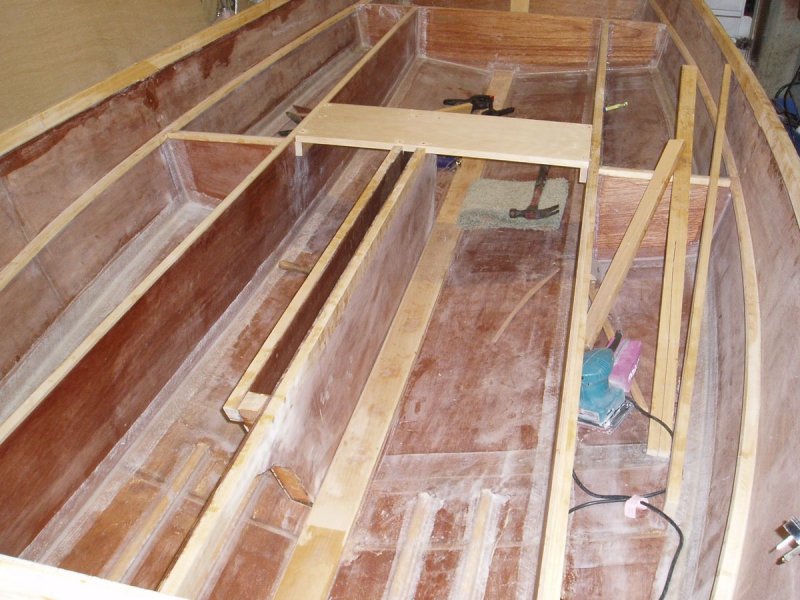

I fitted the centrecase by cutting a hole large enough to fit the case through then scribed with a pencil (which took about 30 secs), cut off the excess, and was ready to glue/glass it in. As you can see from the photo at this stage the seat uprights, keel batten and bottom stringers were all in place so the hull was very rigidly held. I'm sure the hull didn't move/shift or distort to any detectable extent. I'd do it the same way again. Cheers Peter HK -
