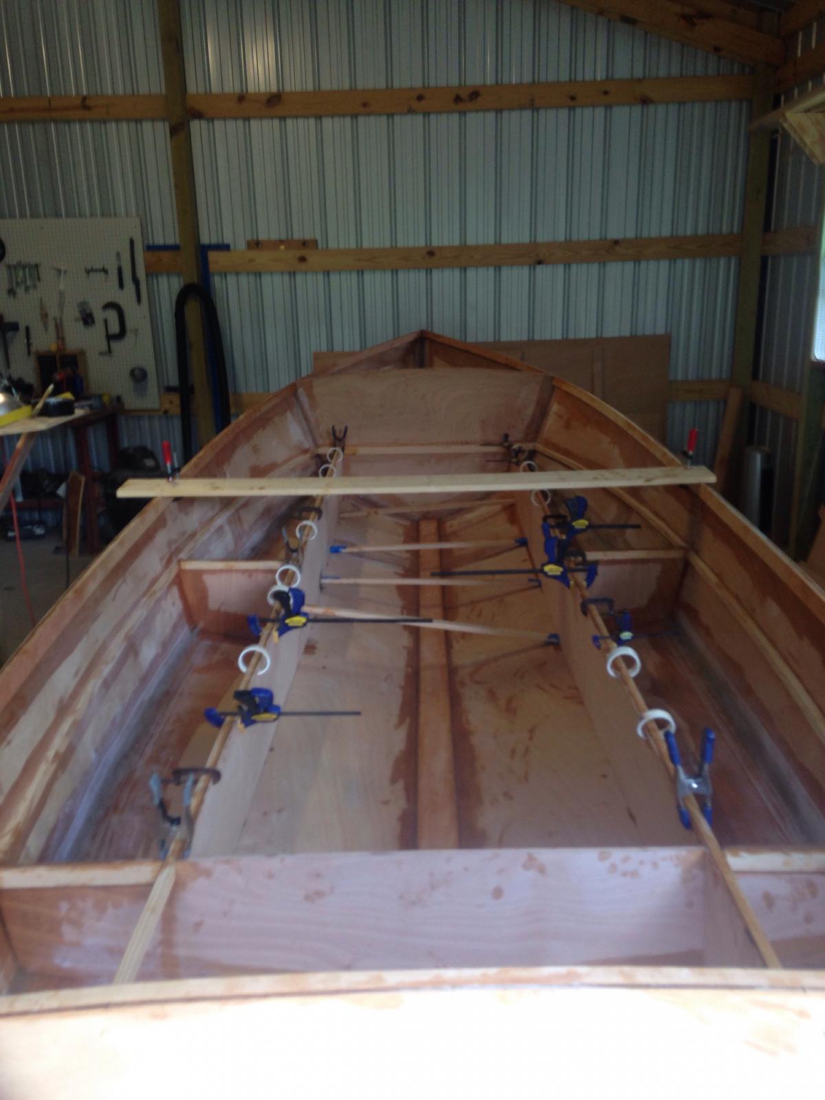

  7. Ken is correct. I am talking about the parallel bottom stringers. So my options are: Set them in at an angle - they seem to lay flatter that way. Scribe them to the shape of the hull. Or, order some 12 oz. biax. The stringers forward of the bulkhead are already glued in. I would include pictures but I keep getting an error message when trying to attach. I think I will order the biax cloth. Thanks for everyones help. Looking at everyone else's pictures keeps me motivated.
  8. I am having a tough time with the bottom stringers just aft of the forward bulkhead. With the curve of the hull, the taped seam where the two thicknesses of plywood meet and the curve of the filet on the bulkhead, I can't seem to get the stringers to lie flat. Even after an hour of sanding, planing, and filing to try to get it shaped correctly. Wondering what others have done. Are there other options? Thanks for any input.
