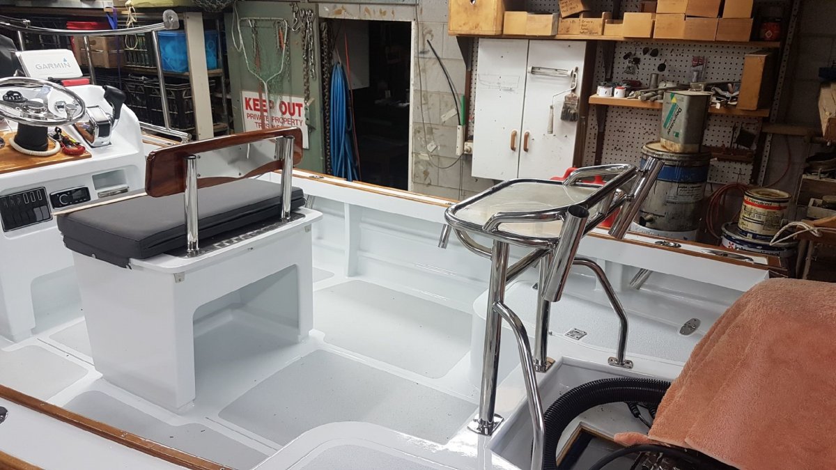

  4. Hi Guys, Thought you all maybe interested in my version of a fold down shade canopy for the timber tub... the front and back stays, once unlocked via hinged tube fittings, fold up and then after the nut on the rear of the gunnel plates are undone, the whole thing pivots forward to rest on the bow plate. A bit confusing at first, but the only way it will fit in my shed. it looks a tad tall but with the low sides of the OB-20 and the fact that I am 6'-9"........ ? I have no say in the matter! Stay safe Trev
  5. Hear hear....looking great mate!
