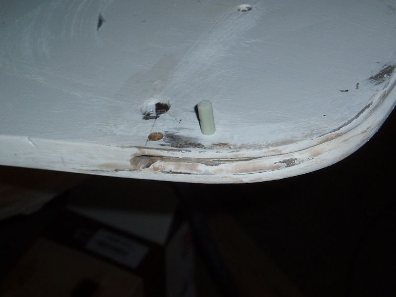

I've had this happen also. The low stretch 4mm downhaul line cut straight though a centre veneer of the rudder blade when the adjustable auto release cleat didn't fire (and I was only going slowly with a 2 hp outboard on idle in a dead calm). I rinsed and let the blade dry, then wedged the crack apart and squeezed epoxy into it and clamped it. Since the problem was the line cutting into the ply veneers at the bottom of the groove that had been cut into the rudder to accommodate the down haul line, I decided to reinforce this point. I drilled a hole through the rudder blade where the downhaul exits and turns to lie in the groove and glued a piece of pultruded fibreglass rod in. The downhaul now bears on this and won't be able to wedge the veneers apart. You can see the rod here and the hole into which it was glued. I don't think that point will fail again. Cheers Peter HK
