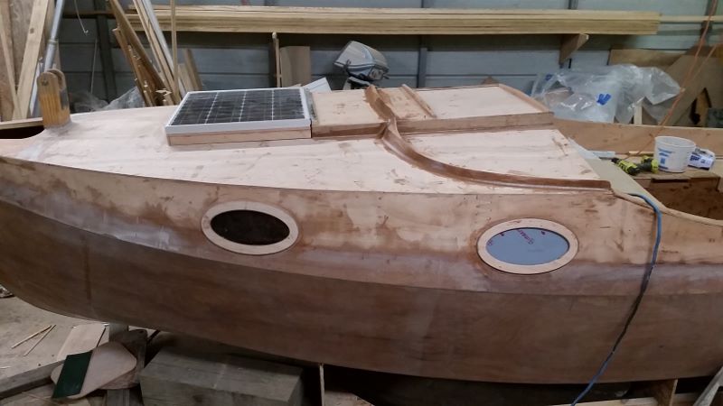

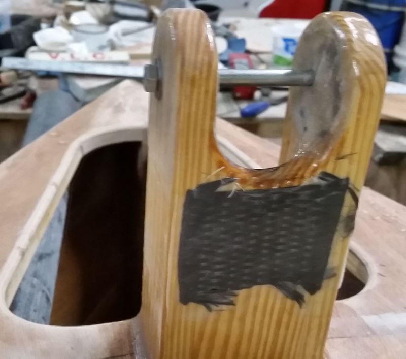

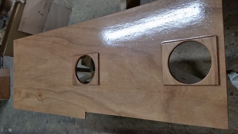

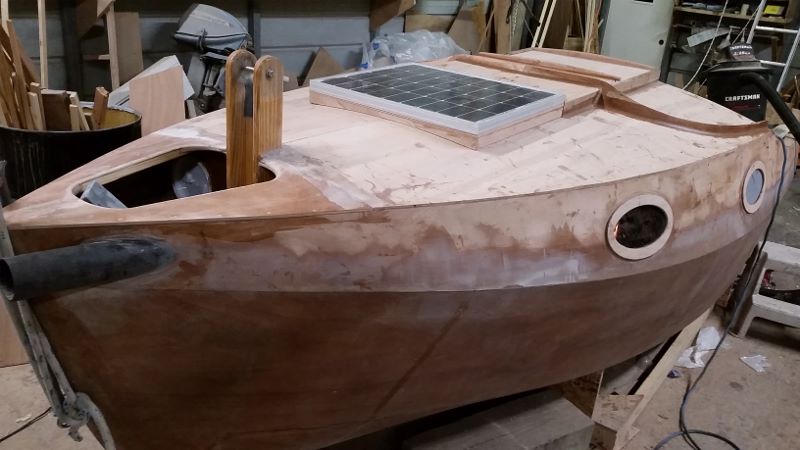

Designer Posted February 4, 2016 Author Posted February 4, 2016 Just thought that I should update. The cold weather set us back a bit but the weather has been great this week. When it got too cold to epoxy I switched to metal work. You know that it is cold when you go to dip a piece of hot metal in the water to cool and the water was hard. I left a hot piece on top of the ice, it slowly melted a hole but when I picked it later it was stuck. Most of the epoxy work is done now except for coating the outside of everything above the hull. The centerboard and rudder are glassed or coated. The cockpit sole is about ready to go in, I have 5 coats of epoxy on the underside. You can see in the picture that I added another port for the compartment aft of the ballast tank. Tom came by for a visit and asked me if I was going to put some glass across the top of the aft center part of the tabernacle. He said that Southern Skimmer developed a vertical crack which I glassed. I cannot remember the incident but after I thought about I am convinced that he is right. After seeing it happen on Travis's P22 I had been recommending that builders add a bit of glass across the vertical grain. Don't freak at the carbon that I used. I was intending to use glass but I had a piece of carbon that was too small to keep so I used it. The masts sections are joined. I ended up choosing an Aqua Signal LED tricolor masthead light. It was a lot cheaper than Jay's, which got a lot of bad reviews for reliability. Our light was a bit more bulky but had a cute way to quickly remove the light from the mast. After examining the construction, we stripped all that away and go rid of the bulk, I probably destroyed the warranty, I did test that it worked first. I opted to not get the anchor light option as it was a fair bit more money and bulkier. Jay's light was definitely cleverer. Another positive thing that I found after pulling it apart is that the three LED clusters were all potted in epoxy as well as circuit board. It should be reliable. The last positive is that there is about an inch of separation between the red and green light which allows my Wind indicator to be mounted on center without compromising the light. It is very bright. 1 Quote

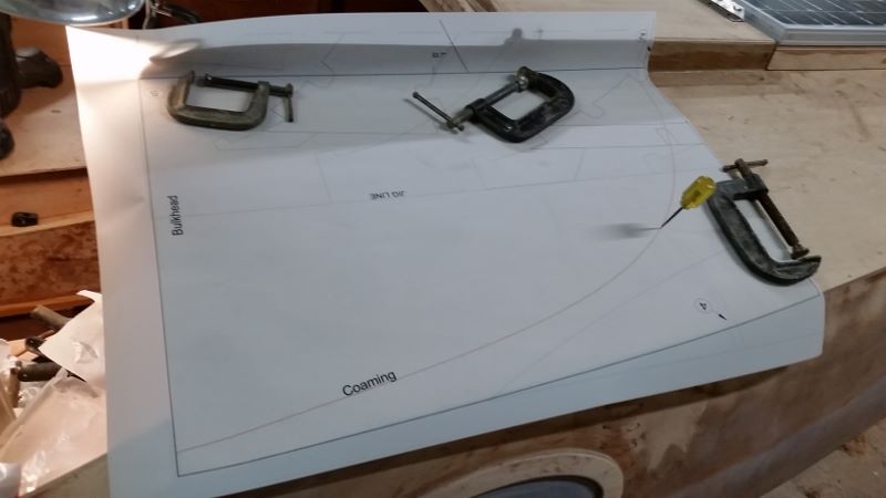

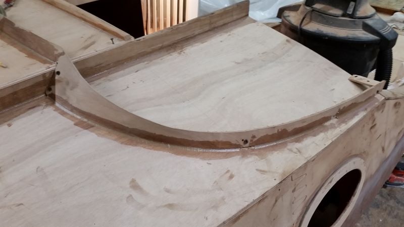

Designer Posted February 10, 2016 Author Posted February 10, 2016 I have installed a coaming for the dodger. The first picture shows the mylar printout. It is on used mylar so there are some extraneous lines, the main lines show the bulkhead, deck edge, hatch rail and the coaming curve. There is an angled line showing the 53 degree slope of the coaming at the hatch rail near the middle clamp. The curve was marked with an awl onto the deck. The coaming is made from 6mm ply. I marked the shape on to the ply with the awl as I did on the deck. I am happy to report that the shape fitted perfectly, what you see is right off the bandsaw without any trimming. I made the first one with the grain running vertically, thinking that it would bend easier but it was too brittle and broke. Experimenting with bending the broken half, it broke again. Using the broken pieces as a template. I cut the next one with the grain lengthwise, it worked fine. I did use the heat gun on the wider section to give it some pre-bend. The second picture shows it glued in place. The third and forth pictures show the finished coaming at different angles. Quote

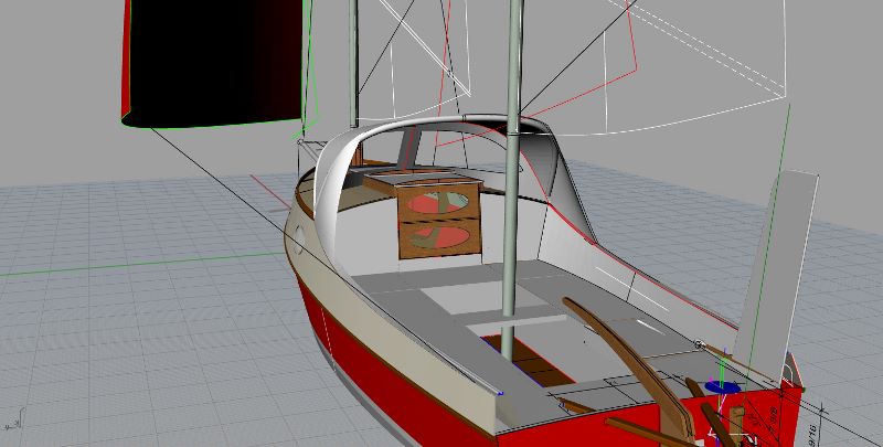

Designer Posted February 13, 2016 Author Posted February 13, 2016 Here is a rendering on how I am going to do my washboards. There are two boards made of 12mm ply and will have 6mm tinted Lexan rabbeted in the back side with a 6mm ply trim ring on the inside. It will match the ports. By mosquito season I will make a screened version in one piece. There is a drip groove on the top edge and the joint between the two halves will be rabbeted. I prefer washboards to doors but that is just a personal preference. Quote
Pete McCrary Posted February 13, 2016 Posted February 13, 2016 Very nice, Graham. On the CLC Pocketship similar boards were made of simply Lexan cut to fit with a wooden drip edge bedded on the bottom of the top board. My solution for stowage was to glue 1/4" battens under the forward end of the "carlins" that supported the roof around the companionway's outboard edges. The battens provided a "lip" or narrow shelf upon which the outboard edges of the boards could be supported. The head-room was reduced only by the 1/4" thickness of the battens. The separation of the Carlins was identical to the companionway opening -- so the fit was perfect. On my "Tattoo" the width of the carlins was about 1.5", which was plenty for the stacked 1/4" boards (1/2" total width). That even left space (above the boards) to place a map, magazine, notebook, etc. They could be easily stowed or retrieved from the cockpit. Maybe the same arrangement could work on a CS Mk3 under the roof between the two hatches. Later, on another post, I'll show the setup on "Tattoo." Quote
