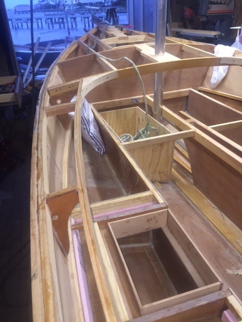

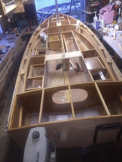

I have been working on my CS17 for a few weeks in a row after a long unplanned break. The framing is finished and it was a good excuse to drive down to Bayboro and pick up the new masts. This was my second trip. The first was to pick up the kit. I was able to spent 2 hrs with Graham. The shop is unheated and he had on his carhartt overalls and jacket. He is a wealth of information and freely shares it. I always learn something like in answer to my statement about bubbles in the epoxy he says "use a heat gun and they will disappear". He was happy to give me the "Carlita" tour. The hull is almost the same as the CS17. He has won a lot of races in the CS17 and he is also a cruising Sailor. So Carlita is going to be a fast cruising boat. It looked so well built that it inspired me to tighten up my work, slow down and spend a little extra time to do a good job. Graham talked about a lot of his designs and his experience sailing them. We looked at Alan's UFC canoe which at this point weighs just 40 lbs. Both he and Alan like to win. How great is that to have these 2 guys designing the boats we are building. I mean.. if you are out on the water and there is another sail boat don't you put out your best sailing effort. Anyway I'm sure Carlita is going to be the boat to beat in Florida.
