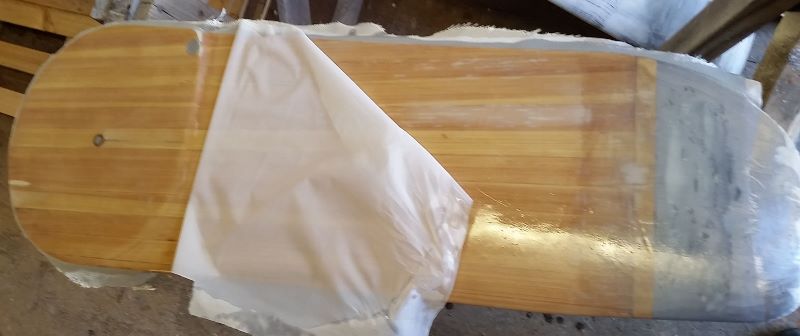

Designer Posted March 23, 2016 Author Report Share Posted March 23, 2016 Chick is right, reducing sail area will not solve the problem. Here is a picture of my board. You can see that it has been glassed and the the peel ply is being removed from left to right. I felt that the board was under sized and I maxed out the length that my trunk would take. You can see the 7/8" spacer between the lead and the board. There is room to increase the chord which I did not do under the press of time. It is a very good foil, being machine cut, so we can rule out that question. You could also increase the chord so that it was maxed out in the trunk plus you could allow a couple of inches to always protrude from the bottom. That would increase the size of the board a fair amount without cutting into the trunk. Par is right that deepening the outside keel will not help a lot. I had a 3/4" deep sacrificial keel on the outside. I did not have time to put on the SS hollow back and it looks pretty scruffy now, but it did it's job. Alan will be back in a few days, after he recovers I am sure that he would like to help me do some on the water testing of some ideas that I have. I can screw on a temporary keel extension to see how much it helps. Quote Link to comment Share on other sites More sharing options...
PAR Posted March 23, 2016 Report Share Posted March 23, 2016 For the non-racer there are a few options to fight excessive leeway. Bilge runners and a deeper chord are what I think are the easiest ways to go, in this regard. Moving the pivot would help offer some room too. Quote Link to comment Share on other sites More sharing options...
