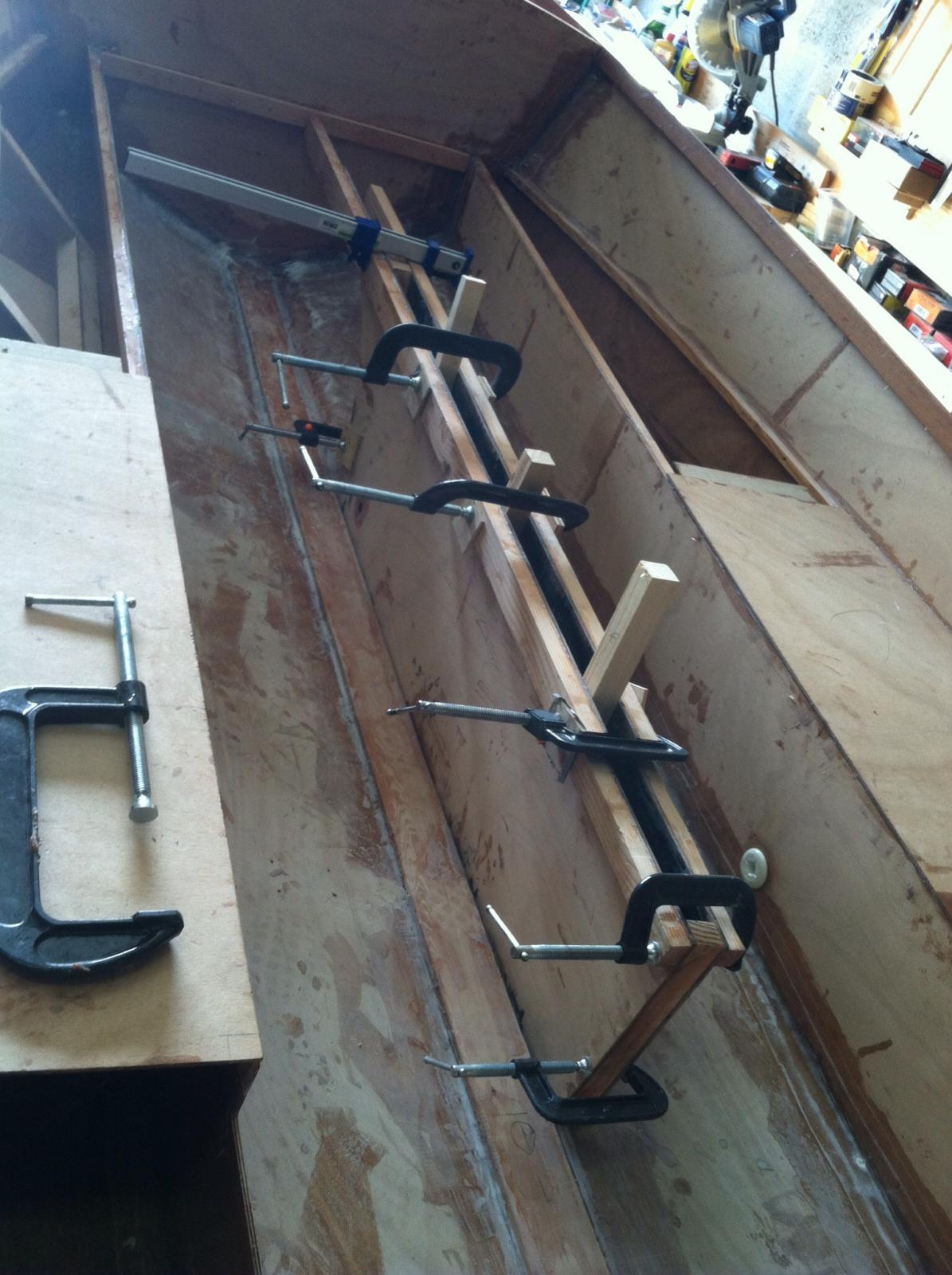

PAR Posted February 6, 2014 Posted February 6, 2014 I'm not sure how you intend to cut your slot, but I free handed it with a laminate trimmer and a straight cut bit with a bottom bearing. I drilled a couple of holes to get the bit through and tried hard to keep a reasonably square relationship with the case sides. The changing deadrise in this area will make the trimmer (or router) bevel the slot opening, if it's permitted to ride on the bottom planks. Once you've roughed in the slot opening, it's fairly easy to clean it up square with the case sides, then round it over for sheathing into the slot. Quote

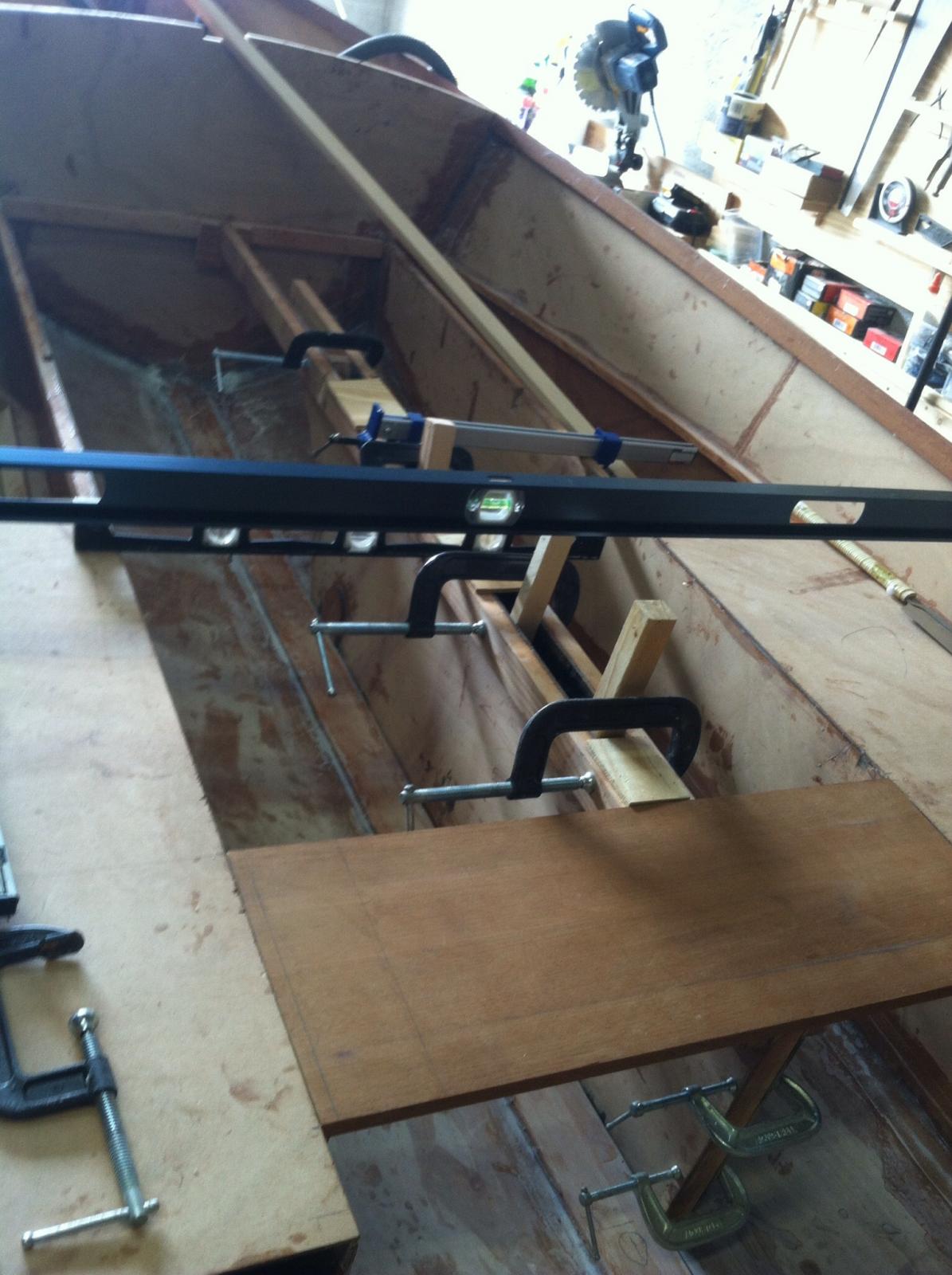

mattp Posted February 6, 2014 Posted February 6, 2014 For me, cutting the slot was pretty complication and stress free. I just measured over from the CL, drilled a large enough hole to get my pull saw in, and cut out chunks until I was within 1/8" from the case. Then I sanded it close to flush with a drill and sanding disk, and finish sanded by hand to get a good radius. Whole operation probably took an hour and was quite satisfying. Quote
LennieG Posted February 7, 2014 Author Posted February 7, 2014 All sounds good. I bought a "palm"router today which actually will be useful for several steps moving forward. Bought the Ryobi (?) and it feels good in the hand....I always strayed away from my 35 year old Craftsman clunker. I need to line up the temporarily clamped trunk tomorrow and establish cut lines. Have re-read the plans 10 times I swear. It keeps saying "glue and screw" components of the trunk. I haven't used a screw yet and confused where they would go, other than the center thwart. The king posts are glued to the side, the rails are glued to the side.....do I add screws to those components to add strength? Also, do I understand correctly that you install one side at a time, first one being the one butting up against keel batten? I believe the plans say to screw it to the keel batten.....where/how? Thanks for your advice. Quote
mattp Posted February 7, 2014 Posted February 7, 2014 I think the screws are for the port side of the case, alone, into the side of the keel batten. Then you would attach the starboard side separately. If you shaped your batten to fit the V bottom like I did, then the side of the batten is quite narrow and trying to hit it with screws, at least for me, seems a little unnerving. So I said screw that (pun intended), glued the two halves together outside the boat, fitted to the bottom, ripped some spacers to jam down between the halves to hold the appropriate gap for the CB, then tacked the whole thing in place. I held the bottom in place by jamming some scrap pieces against the starboard seat side and made a jig to hold the upper aft end in place. I also pre fitted the forward cross members to hold the spacing right at the forward end. Quote
LennieG Posted February 7, 2014 Author Posted February 7, 2014 Matt- Thanks- not just me and that is good to know. I reread plans this morning and I will say it is clearing up a bit. The screws every 4" off center thru trunk side and into keel batten seems like a stretch and I worry that the head of a screw protrudes and nicks the CB as well. I also shaped the keel batten and there is not a lot there to screw into. Not to mention that I did a poor job of cleaning up after installing keel batten, so the goo accumulated and beside the keel batten it is a bit high, raising the the trunk sides, and providing less area to screw into. I'll go back it it with aggressive sanding today. One more question. The 3/4" X 1 1/2" beam at seat height from cockpit side to trunk.......did you simply use a butt joint with no notches? Don't see where you would have notches so thinking of building a wooden bracket around and under the " butt" joint. Thanks- can't wait to be past this stage. Quote

mattp Posted February 7, 2014 Posted February 7, 2014 Yes, I made my notches 3/4" deep, half the depth of the material, and made a matching notch on the cross members. I don't know if this was necessary for strength but it made everything easier to drop in place when gluing. Quote
mattp Posted February 7, 2014 Posted February 7, 2014 And I should note that when we "tacked" it in place, we put a thick bead of goo along the batten to make sure that that was a good, strong joint. Quote

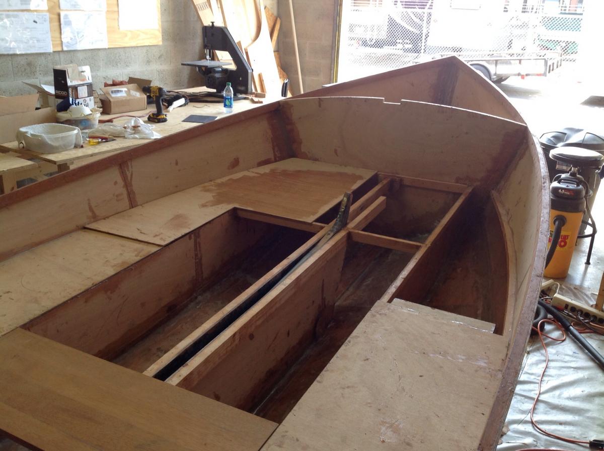

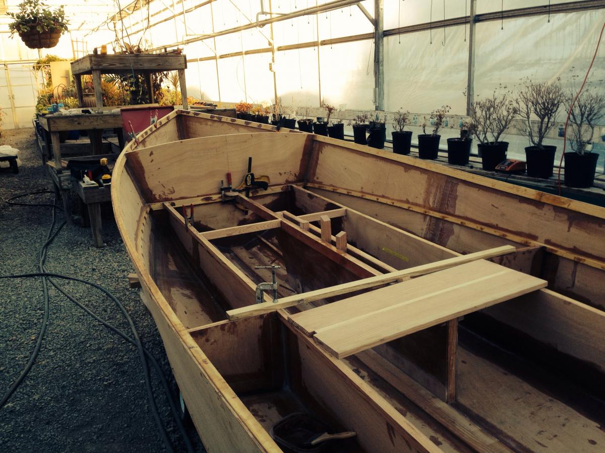

LennieG Posted February 13, 2014 Author Posted February 13, 2014 Limited time this week but within two hours (when I can find the time) of completing fit of CB trunk, cutting hole and installing. Cut the angled notches and making forward progress....first big use of new chisel set! Quote
LennieG Posted February 25, 2014 Author Posted February 25, 2014 Completed CB, CB trunk and miscellaneous stuff. Long stage for me but VERY satisfying, and all indications very good as far as alignment, height, width and all. Will be out of town for three weeks then ready for the big flip. Quote
