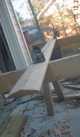

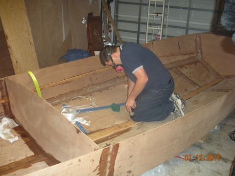

ecgossett Posted September 11, 2010 Author Posted September 11, 2010 Had some friends over today and flipped the hull to work on the bottom... In the process had to drill out some busted screws that had held the inner keel while epoxying... On the good side, discovered with the hole drilled that my job of planing the inner keel to fit was a very close match, with almost no filler gap in-between. Quote
