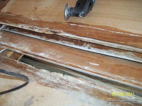

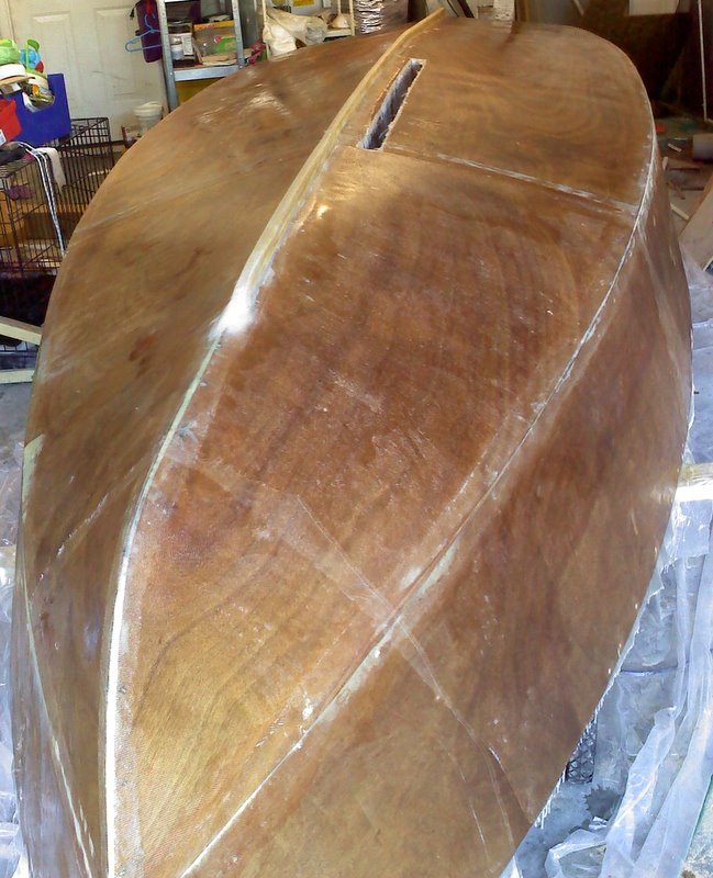

I decided to just cut the trunk out and move it, epoxy fillets and tape should fix any difference in height... Here are some photos.. I used the Ddremel multi-max with a half circle drywall-wood blade... This was my first experience with this tool and it was great. After trying unsuccessfully (painfully), use some other tools including a hand Japanese saw this turned out best and easiest.
The reviews said that you can go through blades fast but I didn't see this problem and the entire job took under 10 minutes, after I bough the dremel.

I think you made the right decision Edward. Better to fix it now than to find out later that it compromises performance in a way you can't readily compensate or live with. A small setback, but soon to be back on track. Looks like you chose a good tool for the job, also.
I've got the Craftsman version of that tool and it has been a lifesaver on the big boat and the Gar Wood project we are working on. The thing has paid for itself a couple of times already. Your use to cut out the CB trunk was similar to one of the cuts we did on the Gar Wood. It's a very cool tool!
