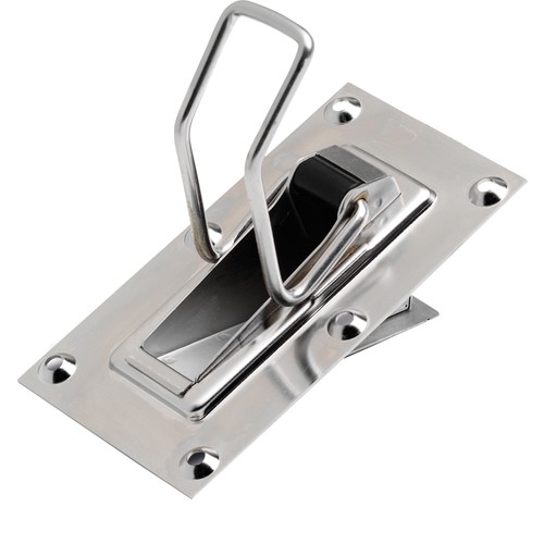

  21. Plans for my CS 17 call for the large Andersen bailer. Any thoughts on whether the inside or outside mount is preferred? This is the original 17 (mk I?), so the bailer is for actual bailing, not for filling water ballast. Photo is of outside mount. Thanks. --paul
