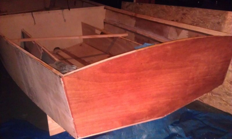

  22. Here's a photo of my transom. It's just epoxy, no stain, like Graham said; spar varnish will follow, and that can affect the color. It's the ply from the kit. The color is more even, not splotchy. I guess that's due to the flash.
