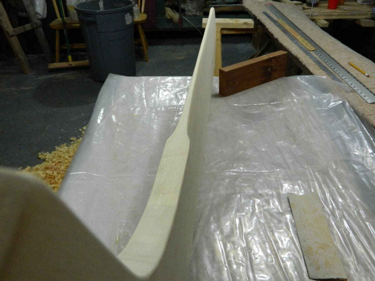

Hirilonde Posted January 6, 2015 Author Posted January 6, 2015 Lennie has it right. The rope soaks up the epoxy and the result is a tough leading edge that can suffer some abrasion without exposing the wood to water. Exactly Another problem with the brass strip is that hitting a rock can not only bend the strip, but shear off or break the screws holding it on. And this could allow water to get through the screw hole into your board. (Yes, I know you would pre-drill the screw holes and saturate the holes with thinned epoxy or Gluvit. Or would you?) Yup. With the saturated rope some distortion may occur, but the wood stays sealed. Now I can finish the sailing season and pull the board in the winter if it warrants repair. Shaped with block plane and draw knife Belt sanded, then random orbital Trailing edge 1 coat epoxy detail of line Quote
Steve W Posted January 7, 2015 Posted January 7, 2015 That looks nice. One of my favorite steps was shaping the centerboard and rudder the same way. Quote

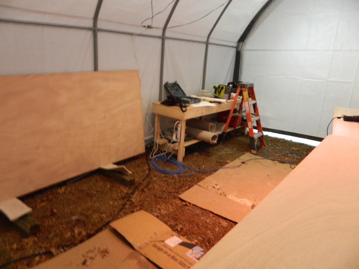

Hirilonde Posted January 20, 2015 Author Posted January 20, 2015 Well, my boat shed arrived in a 300# box. All I had to do (my favorite expression) was set it up. When the boat is finished it will become the boat garage. I want putting the boat away to go something like this: 1. rinse boat 2. open bailer 3. open hatches 4. back into garage and close the door A couple days later my plywood showed up. It isn't very warm in there, but it is quite roomy. I will be borrowing a space heater so I can scarf plywood and other epoxy work on the 16'X4' bench. My shop is in the garage attached to my house right next door. My equipment will stay there. Now it is cut out pieces and parts, assemble components in preparation for setting up for planking. Unlike the butterfly boats, this one has a ton of stuff to do before it begins to look like a boat. Quote
Steve W Posted January 20, 2015 Posted January 20, 2015 In the summer, moisture from the ground will make it damp in there. Get yourself a heavy duty tarp, and make a floor. I had a pole barn that had an open floor and things would rust faster in it than out of it. I finally realized it was the high moisture content. I put a plastic floor and covered it with gravel. you could feel the difference immediately. Take Care, Steve Quote
Dale Niemann Posted January 21, 2015 Posted January 21, 2015 Looks like a great space for building your boat. Nice and cozy. Keep the photos coming. dale Quote
