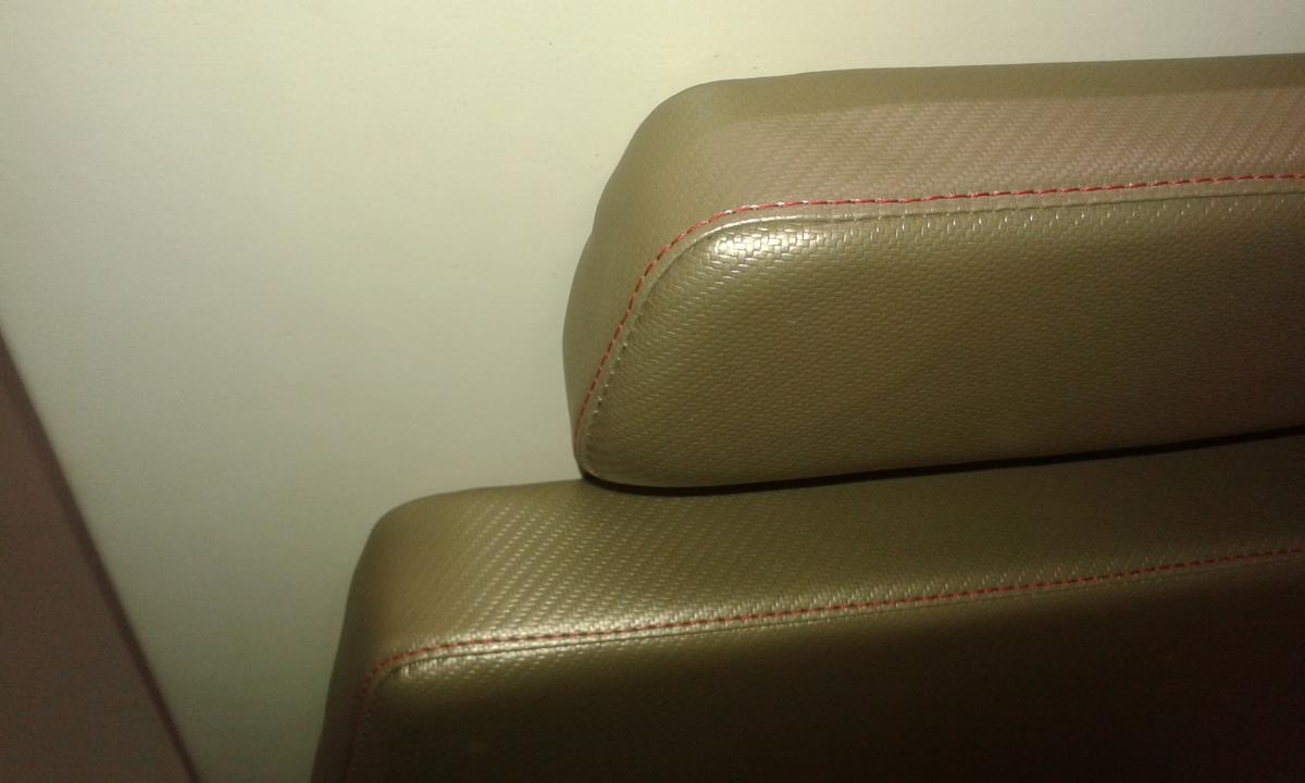

Lotus Posted February 16, 2015 Author Posted February 16, 2015 Thanks Graham , rely appreciate you feedback ! The upholstery is almost done ( not the perfect upholsterer but it will do , at least for now ! ) AND STILL WAITING FOR THE REGISTRATION DOCUMENTS . This is taking more time than the built itself !!!!!!!!!!!!! Hope that this week all be settled and will take her for a test drive . Quote
