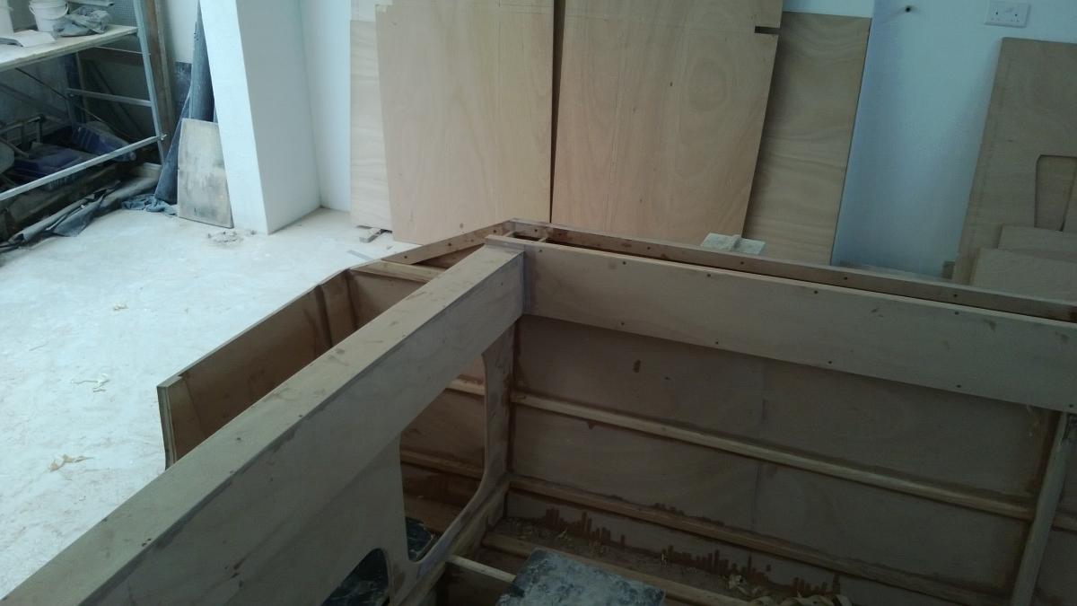

I've bought all the plywood and wood needed and started with my project last May 2014 and as you can see from the photos attached here is my progress !!

Planning for some alterations on the deck and transom.
Would like to have more freeboard to give her that Mediterranean flavour !
Any ideas ??
The planks added are temporary hardboard just to see how she will look.
In fact when I spoke to Graham about this idea he told me that it looks better than he thought that it would . He told me
' the only concern I have is raising the centre of gravity and increase windage.'
He told me also
' The increased freedoard will increase the down flooding angle.'
which in my opinion this will be better for our waters !

Ive decided and the increased freeboard  plank is cut out of plywood  and attached permanently
Now need to extent the frames to the new hight and re design the transom.
Your work looks great.  I like the lines.  I just have a question about the transom.  Aren't the topsides decks over each side of the motorwell structural?  I wonder what effect changing that structure will have when you're running a 60 hp outboard in rough seas.  Are you planning some additional reinforcement?
I've thought about installing a white oak knee on the keel to transom joint on my boat. I don't think it's necessary but all the outboard powered boats I owned when growing up (all wood) had them.
Hi Mike, yes the top sides are structural infect I am going to lower them about 2 inches and make them parallel to each other . I have then transom pictured in mind and yes I added some reinforcement too.
I like the idea of adding some material  to the keel, it will surly help . My only concern is that white oak  is a hard wood and has a different density than the other wood you're using . This may result in  different movements than the rest of the boat with climate changes . I would use the same material you used for the keel.

Today I finished the new designed transom . It gave her a new look and I am very happy with the lines .
We can say that now Marissa got a ' facelift '  ;)

I noticed that you went through one of the longitudinal stringers with the PVC chase.  Are you planning on moving the console more forward?  Also, what is the size of your fuel tank?  I was thinking I'd go with the one Graham suggests but he said that a 50hp may be better off with a larger tank.
Also, what are you planning on sealing the deck to chase joint with?  I noticed some grey substance on the chase pipe where it passes through bulkhead 2 on your boat.  I tested epoxy on a piece of PVC that I roughed up and it didn't stick very well.  I want as water-tight deck as possible.
Mike
Thanks Mike,
Yes I am planning to move the console about 16 inches forward so that there will be more space at the back and if possible I will fit a folding seat to the transom. According to Graham moving the console forward dosent make much difference. He told me that with his smaller motor, the GPS would show about 1knot drop off in speed when  putting  too many people forward.
About the fuel tank the only tank I found in my country that  fits in that space is  a 72 litre. Personally I preferred a 90 litre but every outboard dealer told me that 72l is more than enough  for a 60hp as the new 4 stroke engines are very economical .
The deck to chase gap will be filled with that gray stuff . Its a kind of marine sealer that bonds with almost every surface including pvc. The brand is ' sika ' a very good product manufactured in Italy. They manufacture a lot of construction related products.
If you look for marine sealer that contains fusion polymer it will be good for pvc. Always test a sample.
