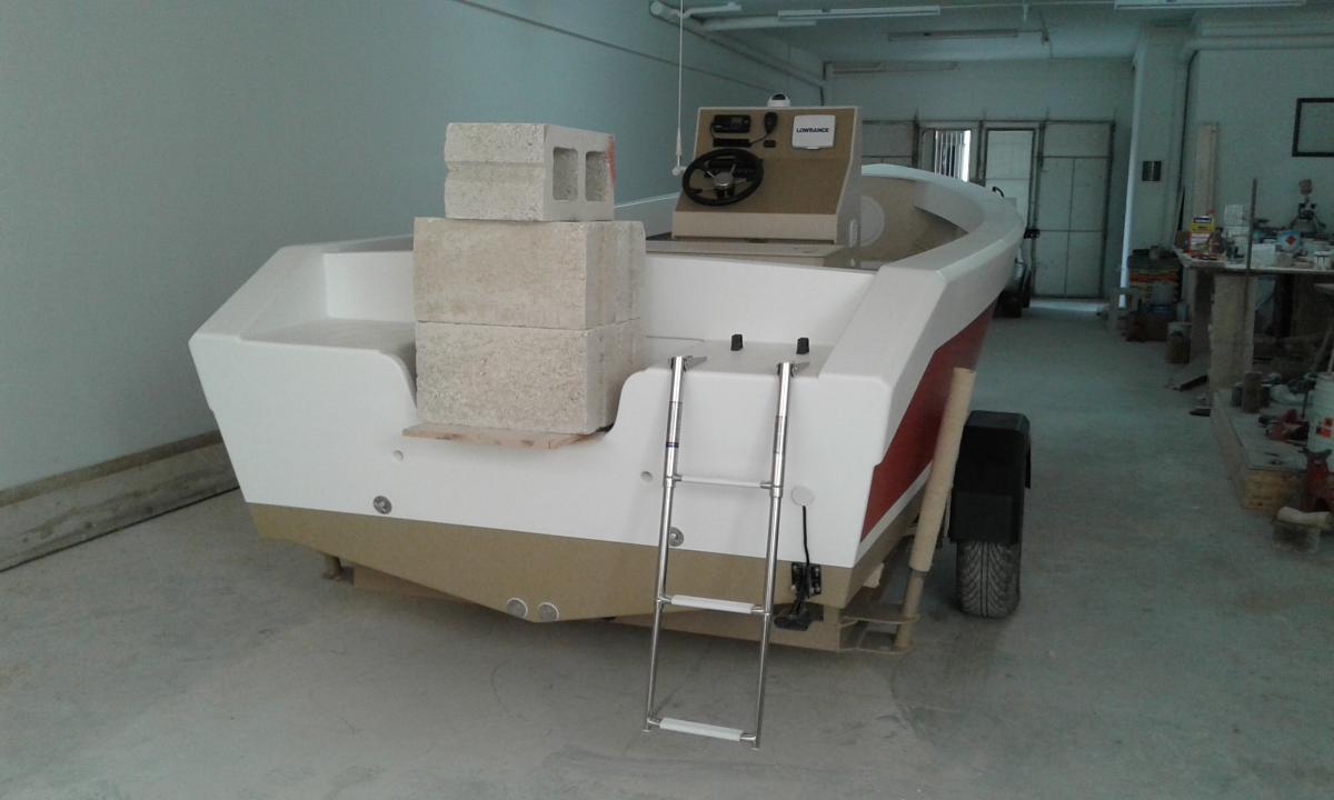

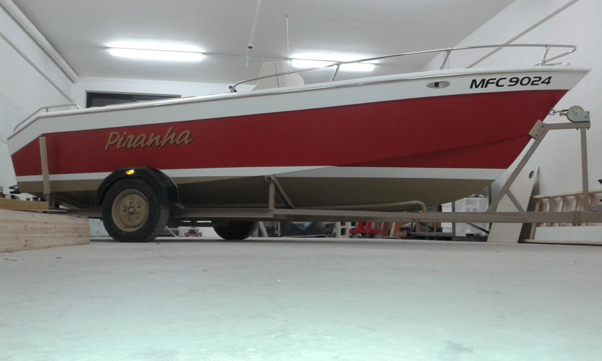

Lotus Posted November 30, 2014 Author Posted November 30, 2014 Finally the boat is on its trailer and on board is the latest technology most fuel efficient out board ever build, in fact it is built out of bricks !!! Quote
MikeLTour61 Posted December 1, 2014 Posted December 1, 2014 Looking great Lotus. You should have no problems with your motor but you might want to install oarlocks. Quote

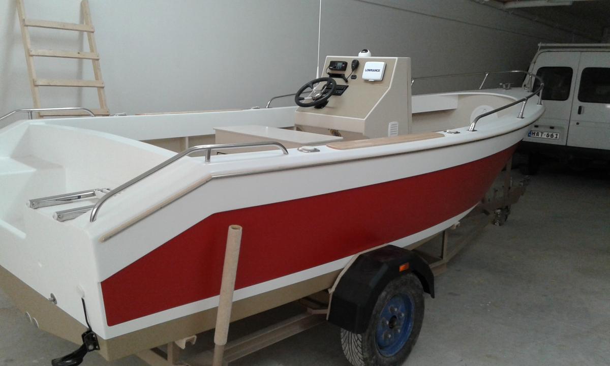

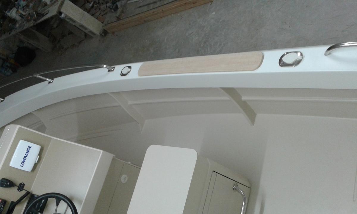

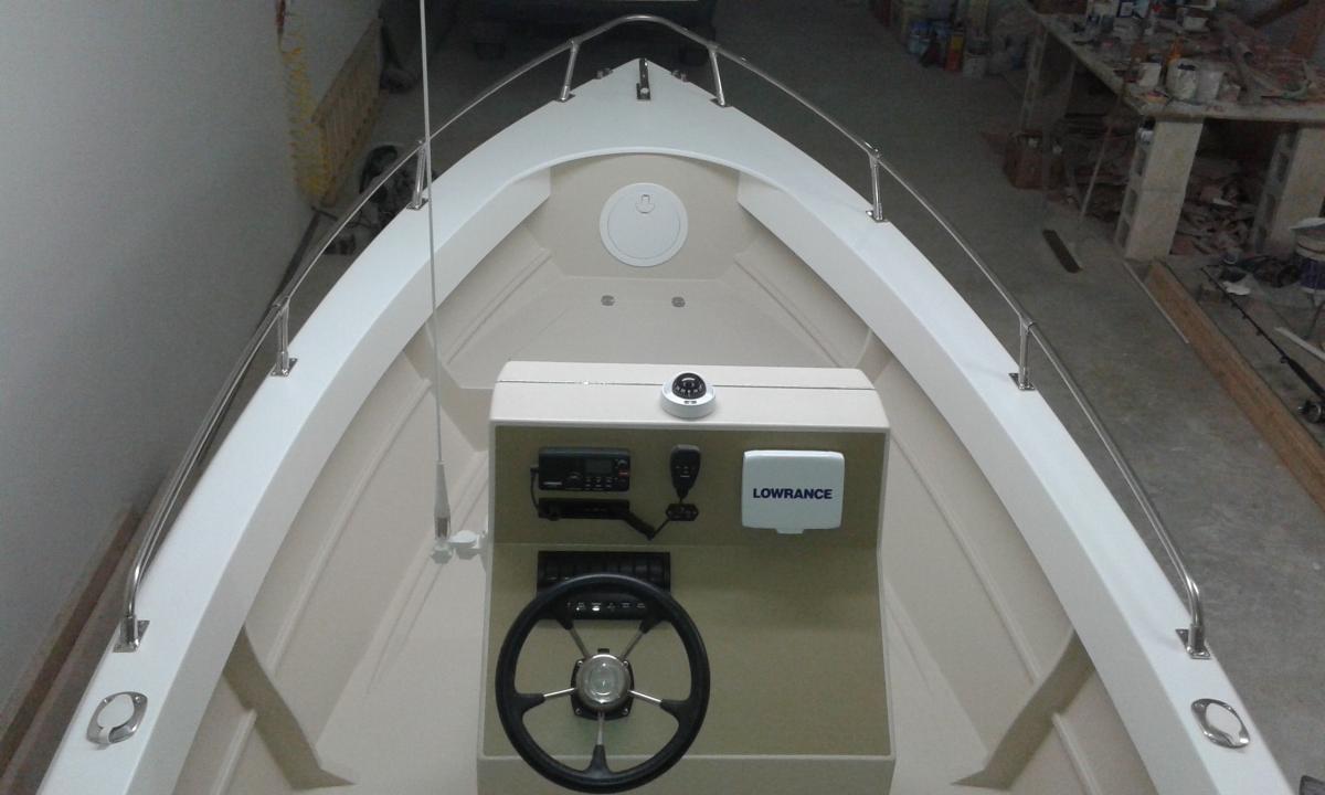

Lotus Posted December 7, 2014 Author Posted December 7, 2014 Stainless steel railing custom made and fitted , some fishing rod holders and a touch of solid maple wood as foot steps ! Quote
SteveVa Posted December 7, 2014 Posted December 7, 2014 Nice craftsmanship, nice boat. You must be really proud. Quote
makenmend Posted December 8, 2014 Posted December 8, 2014 Extremely well done, must be frustrating waiting on the motor, but I'm sure the wait will be worth it. MM Quote

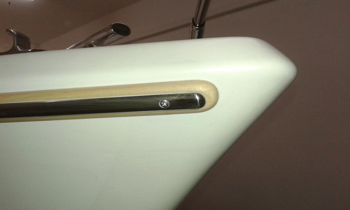

MikeLTour61 Posted December 8, 2014 Posted December 8, 2014 Great job Lotus. I was wondering if you were going to add a rub rail or is that built into the higher sides you added? It would be a shame to scuff that great paint job. Mike Quote

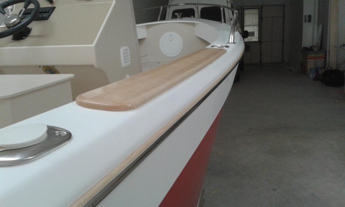

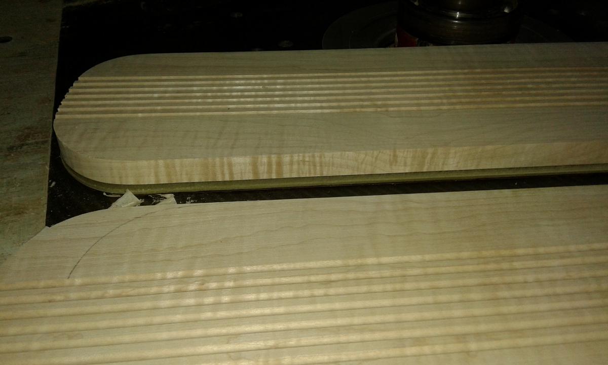

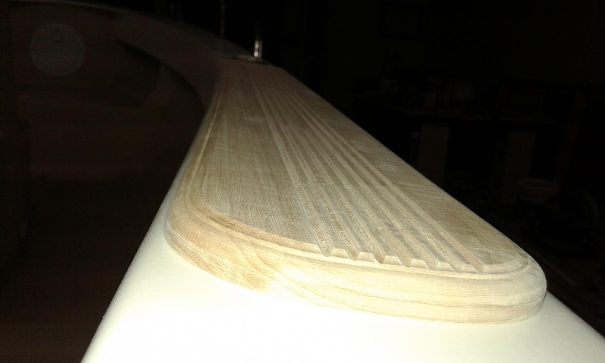

Lotus Posted December 8, 2014 Author Posted December 8, 2014 Thanks every one for the nice compliments , and yes MM it's very frustrating waiting for that motor seems like it's taking ages to be shipped !! Mike looks like you were reading my mind . I am still confused about what rub rail I will put. My first thought was a 40 mm white rubber but when I got a sample it didn't look elegant on it. Now that I have added a touch of wood grain ( the foot steps ) I am thinking of making the rub rail of maple wood. I'll make a sample tomorrow and see how it looks. Quote
MikeLTour61 Posted December 11, 2014 Posted December 11, 2014 I really like the light colored wood! I'm not used to seeing maple used on boats but I really like the way it looks on your boat. I wonder why maple is not typically used.. at least in the U.S.. Is it just a traditional thing or something more? Maybe someone can provide some insight. Maple (especially hard maple) is very dense and tough. I use soft maple exclusively when making drawers and hard maple for making drawer slides. For marine applications, I typically see teak, mahogany, cypress and white oak. I think those woods are less prone to rot than maple, which may be a factor. How did you attach your rub rail? I've read about a method where a large hole is drilled and then filled with thickened epoxy. That epoxy 'plug' is then drilled and tapped for a machine screw which can also be epoxied in place or not (depending on if you'll ever want to replace the rub rail). It sounds like a lot of work but from what I understand, it's much stronger than wood screws alone. Quote
Lotus Posted December 11, 2014 Author Posted December 11, 2014 Hi Mike , I don't know how to answer you about hard maple and sea water . I used it just because I love its grain and wanted a light colour grain too. If its prone to rot than they will be replaced as they are easily screwed out. Thanks for that info , to be honest I didn't made any research about maple and boats ! About the rub rail it is fitted with screws that hold the stainless steal trim it self. The screws are visible . I've have heard about the method you mentioned but I don't think its necessary for a small rub rail Quote

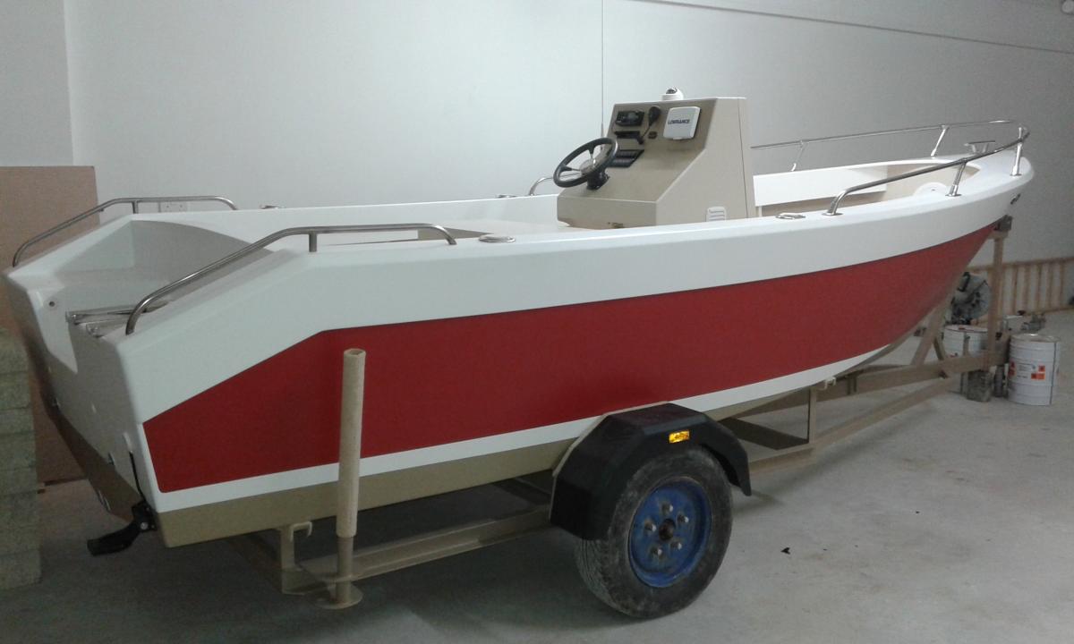

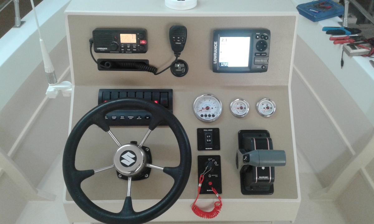

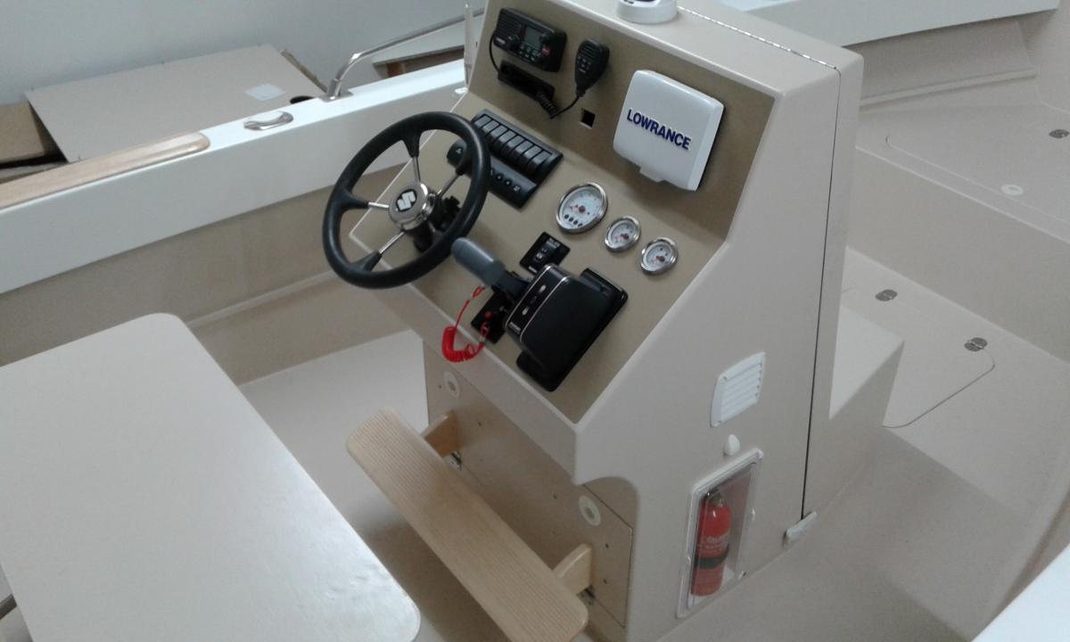

Lotus Posted January 22, 2015 Author Posted January 22, 2015 Decals ready and now she's got a name !! Quote
SteveVa Posted January 22, 2015 Posted January 22, 2015 Not only is your boat awesome, that is one good looking console. Increased carburetor sizes are used to increase HP...all else remains the same within a certain size as I understand it. Quote
