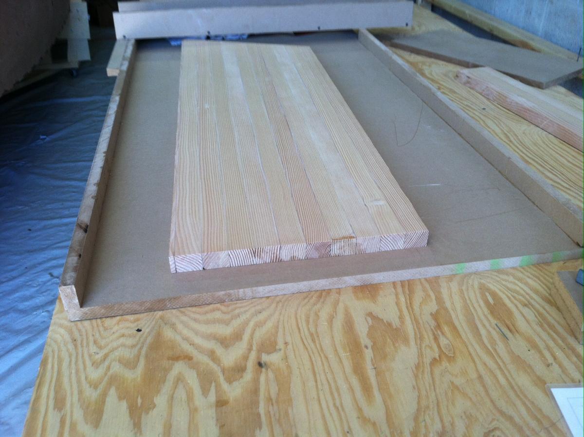

LennieG Posted November 21, 2013 Author Posted November 21, 2013 Great day today. Been stuck for awhile.....tired of fillets, scared of next steps with CB. Anyway, after much good advice on center board advancement ( getting the blank down to approx 1 1/8" , flat and true) after gluing up the blank, decided to go with the router jig method. Built a nice jig for $30 and five hours work....see below....and have been wrestling with the fact that it rocks a bit when on the flat surface of the MDF box .......push one corner, the other goes up 1/4" inch. Been operating on the theory that the hovering of the router over the jig should true up the top nice and flat regardless of the bottom, particularly if it is secured down with screws. Was ready to dig in, stop fretting and take the dive, and had the thought that the millwork place I bought the dimensional lumber from would have the right equipment for the job. Bingo. One phone call and a 15 minute drive. They put it thru a dual belt sander machine (80 and 120 grit) which was awesome. 24" wide, 8 foot tall and five passes later had a smooth 1 1/8" blank. It does still rock a bit....push down on one corner, the opposite corner goes up 1/8" but with hand pressure on both corners both will stay down. Any thoughts....should I try something like wetting whole blank and clamping down all corners to try to flatten, or just not worry about and proceed and hope for the best? I am inclined to do latter. Quote

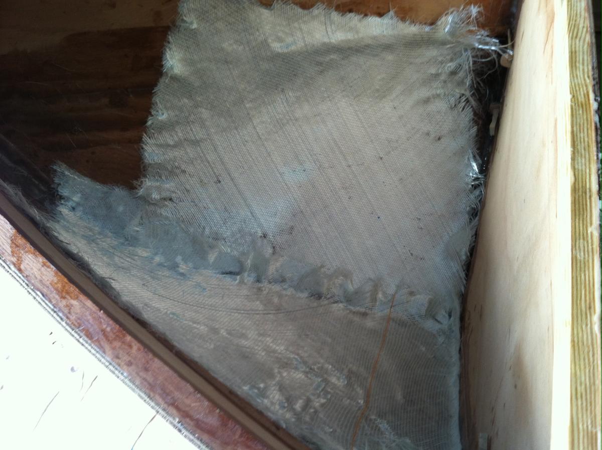

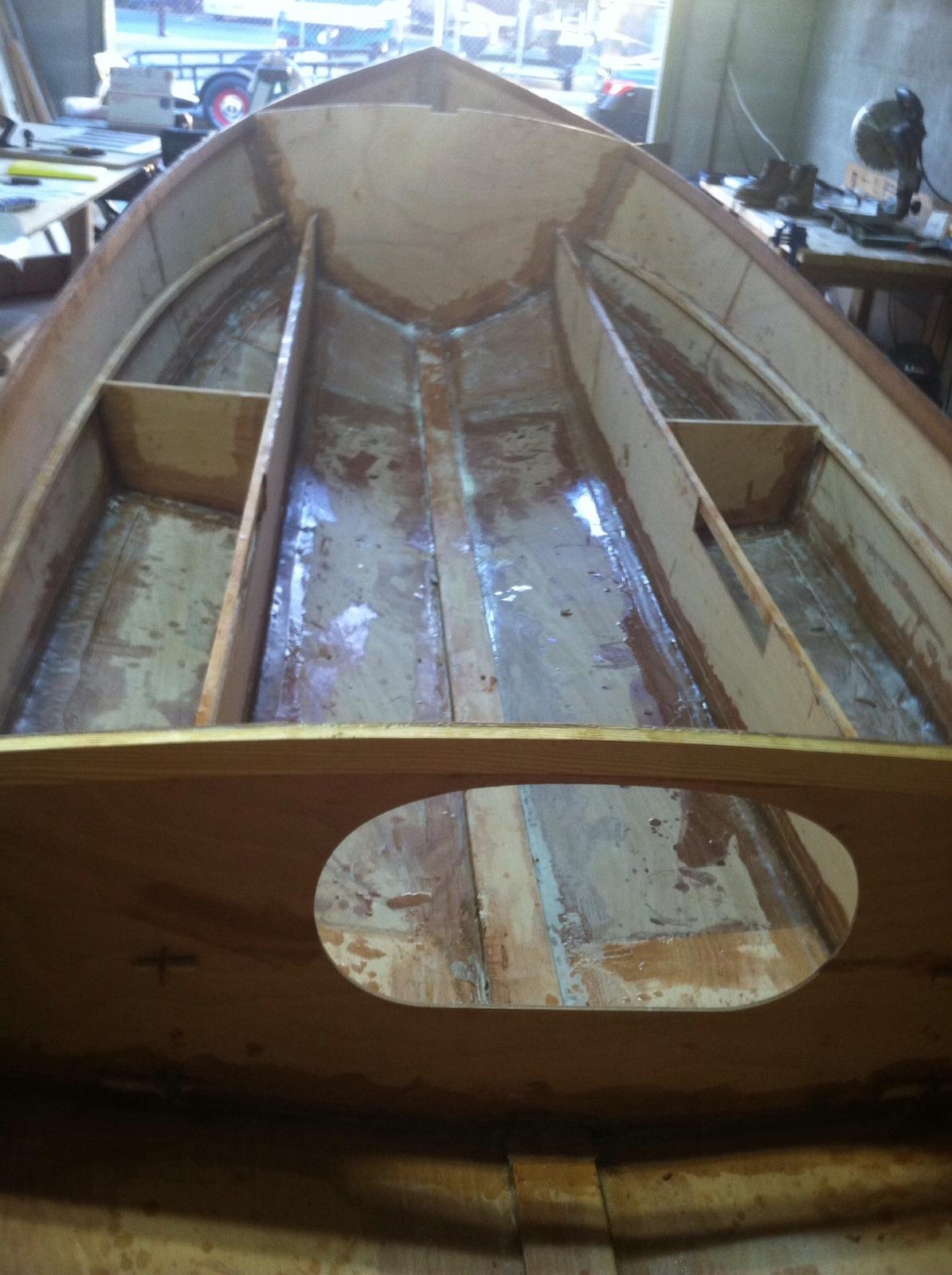

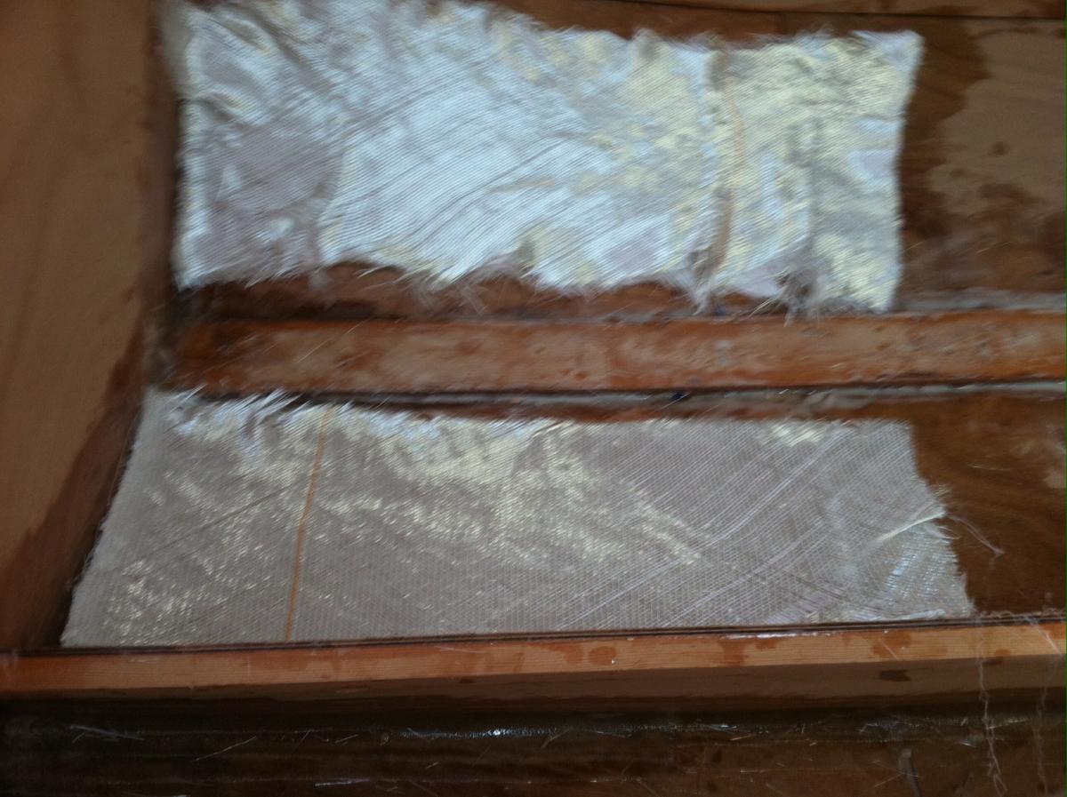

LennieG Posted November 21, 2013 Author Posted November 21, 2013 Also reinforced bow section and fore section of cockpit with 12oz biaxial glass , filleted fore side of aft bulkhead, and started a sharpening station for my bench to be able to have all the stuff right there when I need to sharpen chisels or planes etc so I will actually do it. Quote
mattp Posted November 21, 2013 Posted November 21, 2013 I've been pondering the bow reinforcement options. I am curious: How many squirts of the "liquid gold" did it take to wet out the that biaxial fabric (assuming you are using the pumps)? I think that method would make for a nicer finished job. Also I wonder if sufficient strength could be achieved with 2 overlapping layers of regular 10oz cloth set at 45 degrees? Quote
Dnjost Posted November 21, 2013 Posted November 21, 2013 With the bow stringer in, the forefoot appears to be sufficiently supported to prevent oil canning and adds much rigidity to the area. Â If the issue is a concern over puncturing, then perhaps ensuring there is sufficient foam flotation forward and aft, in addition to the side tanks may the the better option, as even an entire layer of glass outside would not prevent a puncture if going fast enough. Â Â I only plan on a short layer of glass on the bottom where I think there will be several encounters with rocky beaches in the not too distant future. Quote
LennieG Posted November 22, 2013 Author Posted November 22, 2013 Matt- I cannot speak for the "engineering" type difference between the two although I'll say Graham does support either method. I will say it came out very good. The photo you see was not the final cut before I glued it in. I did not go with the 12oz biaxial for technical reasons but simply because I had never used or seen 12oz biax and wanted to experience using something new. I called US Composites,where I ordered the product from and asked some questions like which side goes down (A- the swirly side goes down, woven side up) and in that conversation I was told I should plan on 1 qt of epoxy per yard of glass, and that is about what it came out to (I use MAS slow). For that qty I take out the pump and pour the resin and hardener. I am pleased with result but will note it cost me some bucks when you consider the amount for the epoxy, glass, shipping etc. vs a couple sticks. us composites could answer your question about two layers of 10 oz. Ph. 561-588-1001 Quote
Alan Stewart Posted November 22, 2013 Posted November 22, 2013 Thought I would add another link about shaping foils. Over on the Outrigger sailing Canoes site they are mostly into leeboards with constant foils but the idea is still there. http://outriggersailingcanoes.blogspot.com/2013/07/perfect-foils.html  Also, I definitely wouldn't worry about 1/8" of rock or twist or whatever it is. That will easily be lost in the shaping process. I would lay it on a flat surface and use a gauge block to draw a centerline all the way around the edge after you cut the blank to the finished profile shape. That will give you a "flat plane" reference line to shape to. Once you start planing, grinding, or belt sanding it will be a good double check that its even both sides. Quote
Phil Garland Posted November 22, 2013 Posted November 22, 2013 Re; stiffening the 1/4"bow panels. Â On CS17 #351 we used a biax carbon material (left over from a mold project) instead of the stringers which I thought was cleaner and stiffer. Â Using two layers of 10 oz glass diagonally should be fine and will probably use less epoxy to wet out. Â Are you guys using peel ply over the glass? Â If not you should consider it as it really smooths the laminate and eliminates lots of extra sanding. Â Quote
Dnjost Posted November 22, 2013 Posted November 22, 2013 Having been to Phil's business site Hall Spars in Bristol RI where they specialize in working with these materials. Â I should take his advise. Â He knows way more than I about biaxial cloth, and laminates than I. Â FWIW. Quote
LennieG Posted November 23, 2013 Author Posted November 23, 2013 Phil- Thanks for weighing in. I am not using peel ply but do have some as I bOught it as part of my original supply purchase. I think of it as a cosmetic tool where it helps minimizing future sanding. So, I don't see it applying forward of the fore bulkhead which will be under deck and never hopefully seen again. I guess the fore part of the cockpit it could have come in handy...missed that,application...darn. Will keep my eyes open for future use Quote

Dale Niemann Posted November 24, 2013 Posted November 24, 2013 Lennie, I agree with Allan that 1/8 th inch will not make much difference.  However, did you try it on several flat surfaces or just your MDF box. I would try it on your granite counter tops in the kitchen. This will also be a true test of your wife's committment to the boat construction project.  dale Quote
LennieG Posted November 24, 2013 Author Posted November 24, 2013 Honey, I made a new cutting board for you . Dale- Thanks for thoughts. Will get a chance to dig into it now. I haven't actually bothered to do basic checking into the detail of high spots/ low spots. Will take a metal straight edge Monday and see exactly where the problem, if there is one, lies ....maybe it is a quick fix and not a big deal like you say. It is a little proud of 1 1/8 inch so maybe some selective sanding solves "the rock" or maybe it is within the area that will be removed anyway for the foils. A little haunted by thought that a well built house starts with a level foundation but realize this is small potatoes and will be ok. Is your Marisa floating yet? Quote
PAR Posted November 24, 2013 Posted November 24, 2013 Use some chalk, like that to refill a chalk line thingie and find out where the warp or hump is. If it's in the middle, you might want to take different steps then if it's along one of the edges, which will likely get whacked off in the shaping process. Quote
LennieG Posted November 24, 2013 Author Posted November 24, 2013 PAR- Let me make sure I am clear.....you're saying to snap a chalk line across edge, or some other use of the chalk itself? Thanks Quote
LennieG Posted November 24, 2013 Author Posted November 24, 2013 Never mind-think I've got it. Thanks Quote
PAR Posted November 25, 2013 Posted November 25, 2013 The idea with the chalk is to butter up the back of the board, then place it on a known flat surface and see where the marks are, once you lift it off. Any place there isn't a mark is high (curled away from the flat surface). Quote
