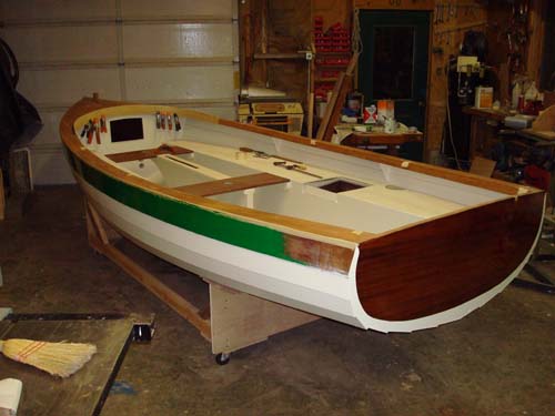

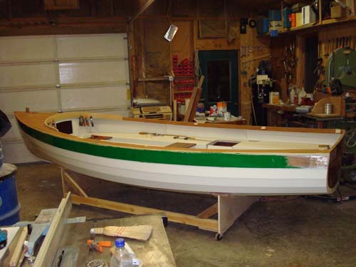

Tom Lathrop Posted June 25, 2008 Author Posted June 25, 2008 After a bit of disappointment in not winning the Summer Solstice race with Southern Skimmer last weekend, I got back to some work on Lapwing. We missed first place by a bit over 1 minute :-[ We won last year and no one has ever won more than once since the handicapper puts a big penalty on the winners for later races. Good fun and food anyway. Here are a couple photos of some new work. Quote

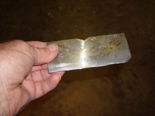

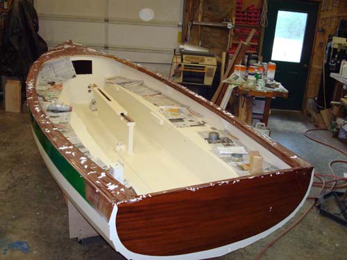

Tom Lathrop Posted July 4, 2008 Author Posted July 4, 2008 Mahogany deck has two coats of epoxy and has been scraped. I often use a scraper to go over an epoxy coated surface before it is sanded and then varnished. I think it helps level the surface more than sanding will. Less dust too. This scraper was made from an old 7 1/2" carbon steel saw blade, the common kind used on a skilsaw. I don't take any specal effort to sharpen it if the surface is to be sanded later. I just hold it up to the side of a grinding wheel and don't bother turning the edge. Makes a tougher edge this way. Quote
Dale Niemann Posted July 9, 2008 Posted July 9, 2008 Tom, What color is the cockpit? I used white and it is too much. Yours looks like a cream color maybe? What brand and type? Thanks, Dale Quote
Tom Lathrop Posted July 9, 2008 Author Posted July 9, 2008 Dale, You are right about white on an open boat interior being too bright in the sun. I often use epoxy paint for my decks and interiors, especially where a tough finish is needed. I buy it from Glidden/Devoe/ICI (same company) (product # 4508) although I'm sure other suppliers have similar stuff. It is intended mainly for industrial use on watertanks and steel bridges. About the same stuff used on concrete garage floors too. I roll it on with a small short nap roller which leaves a semi gloss pebbly finish that doesn't glare and is a tough as nails. The only way to get a smooth finish with it is to spray it and I have done that also. It costs about $30/gal so the minimum outlay is about $60 for the two parts. I keep it on hand at all times and find regular uses for it, like on centerboard and daggerboards. It's been on the cockpit sole and decks of my powerboat for 8 years with no maintenance and is still good. In the sun it does chalk a bit and get dull but that is fine with me. It comes in white only but I tint it to whatever color I like at the moment, usually a shade of gray but, in this case, a traditional cream for Lapwing. Quote

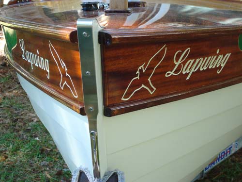

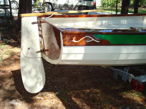

Tom Lathrop Posted September 28, 2008 Author Posted September 28, 2008 The deck is finally varnished on Lapwing. Weather has been terrible for varnishing as I have been trying to get it done for over two months, interrupted with other events also. Anyway Graham and I spent several hours yesterday carving the bow trailboards with the Shopbot. The machine time took only a few minutes but worrying with the computer program took hours, not to include the hours spent trying to find and import a suitable font. The smaller aft trailboards will get a curlicue of some kind also. Quote
Tom Lathrop Posted September 28, 2008 Author Posted September 28, 2008 If there is not a better library of fonts that can be imported into Graham's program, there will be a lot of tailoring to be done each time. It took a lot of fiddling to get this one acceptable. The Bird was easier. All he had to do was copy my drawing and digitize it. It all takes time and effort. The trailboards were my work and are not a part of the Lapwing design. I don't know if Graham will be willing to incorporate anything like that or not. Of course anyone can do that for themselves. Quote

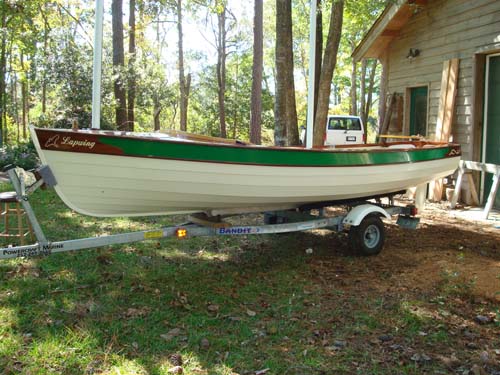

Tom Lathrop Posted October 16, 2008 Author Posted October 16, 2008 Lapwing is on a trailer, if not her own, for the trip to Georgetown. Not really finished but going anyway. Will definitely be at the messabout, barring uncontrollable circumstances. Quote
wkisting Posted October 16, 2008 Posted October 16, 2008 Terrific work, Tom! She's a beauty. Your work looks impeccable in the pictures, and it looks like a top-quality finish on the transom. I'll look forward to seeing her in person if we can make the meet. Quote
Designer Posted October 16, 2008 Posted October 16, 2008 I just got in from visiting Tom and the Lapwing and it looks even better in the flesh. Quote
Hirilonde Posted October 17, 2008 Posted October 17, 2008 Wow, looking forward to next week even more now! Quote
Charlie Jones Posted October 17, 2008 Posted October 17, 2008 Graham, that's hard to buy, 'cause it's absolutely gorgeous in the pictures ;D Quote
lbrewer Posted October 17, 2008 Posted October 17, 2008 That is definitely going to be an attention getter! Nice work Tom. Quote
Dale Niemann Posted October 17, 2008 Posted October 17, 2008 Tom, She is a beauty!!! I love the curved transom, color scheme, superior workmanship, name, etc. etc. You and Graham have combined to produce a fantastic boat. Please deluge us with photos of her at the boat show and sailing at the messabout. Hope I can do half the quality workmanshop you exhibit when I build my Lapwing. Now I am really sorry I will not be at the messabout. Dale Quote
jollymon258 Posted October 18, 2008 Posted October 18, 2008 Tom Saw the boat today in Georgetown. She is beautiful (even when soaking wet). Well Done! Very Well Done! Quote
