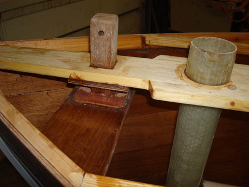

There a few things done since the last post.  First there is the mast tube in the bow with the overboard drain fitted.

Now you can see that some work has actually been done.  The holes in the forward bulkhead are for the oars.  Graham came up with this storage idea and it allows a decent length oar to store alongside the centerboard trunk with almost no interference with space in the boat.  There are PVC tubes, capped on the end, that are inside the forward area.  This is water based epoxy paint that I get from the  Devoe/ICI store.  Liz complains abut the smell from the fancy stuff with lots of VOC's.  The final color will be darker since I did not want to use all the tint on the first coat.  I like to roll on the paint for the interiors of open boats which leaves a slightly pebbly finish which I like.

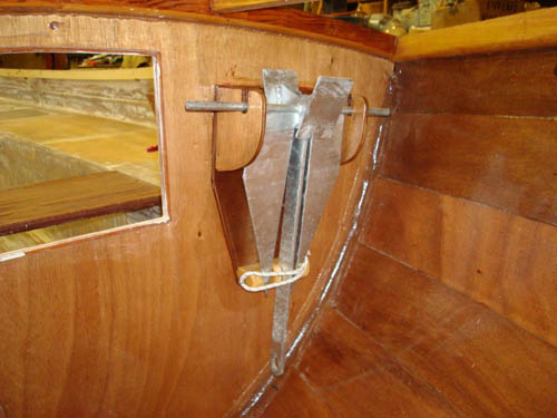

Some work has been done since the last post.  Here is the anchor storage inside the bow compartment and the samson post with underdeck reinforcement.

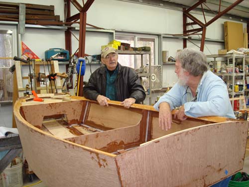

Progress on Lapwing has been on hold for quite a while.  First I was committed to designing and constructing a mold for building 12 Optimist prams for local kids.  Then I had back surgery in February that put me in a hard plastic brace from sternum to crotch for over 6 weeks.  The doctor would not let me do any work during that time.  Next I am into a soft back brace and limited activity until the doc gives more freedom.  Then I had to make 12 daggerboards and rudders for those Optis.  I am almost finished with them now after working on them a limited amount each day.
Next week I hope to get back to the Lapwing.  Next job is to prepare and paint the outside.

Second one is John Burritt and me discussing some critical issue that I don't remember.  John is the one with the hair.

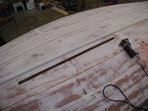

Finally got a little work done on Lapwing.  Cut out the centerboard slot in the bottom and sanded the primer.  I drill two holes near the end of the slot before installing the centerbord case and epoxy it in place.  To control any warping or twist of the CB trunk, I insert a plastic wrapped board of the same dinension as the width of the trunk.  This piece is knocked out later.
The opening in the bottom is opened by a saw cut of about half the width of the inside of the trunk. as in the first photo.  A router with a bottom bearing straight bit is then used to finish the slot to the exact dimension of the trunk as in second photo..  Works good and no need to measure anything.

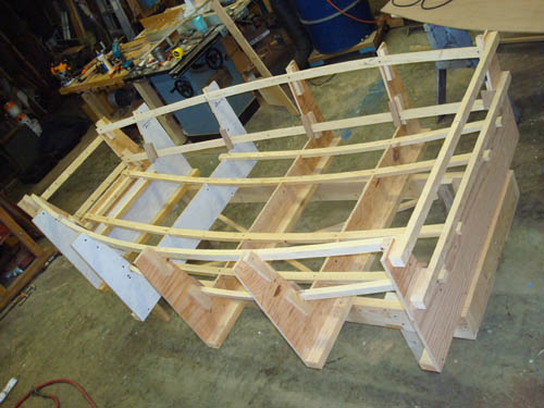

We are working on the CNC version of the Lapwing. John Burrit has been coming over 2-3 afternoons a week and we are into the planking now. It is going very well and have been well pleased with the rigidity of the structure with no building jig and I think that it is very feasible.
I have expanded out all of the plank shapes but I am spiling the planks off of the boat because there can be some variation between as drawn and as built and I want it to be as accurate as I can make it. You can see in the picture how the whole structure goes together with the middle frame and aft bulkhead sliding along the longitudional bulkheads, with tenons passing through the forward bulkhead and held with wedges until the epoxy dries. The transom has a pair of 1/16" deep grooves milled to position the longitudional bulkheads and keep it aligned until the epoxy cures. The stem has the maim mast step integrated and it butts into the forward bulkhead. You can see where the centerboard trunk will be cut through the mid bulkhead where it is left in one piece until the hull is built.
The main advantage in building this way is to save the cost and time to build a jig. A pair of 32" high sawhorses and a couple of cleats to keep the bulkheads straight is all that is not part of the finished boat. The mid and aft bulkheads are trimmed down to seat height after the hull is built.post-0-129497639507_thumb.jpg
