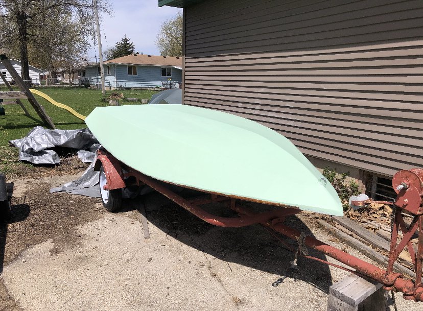

MEANWHILE, my son sent me a couple photos of his boat project today. He has been fixing the boat I built in high school and painted the bottom of the hull today a new color.  His son is helping... just like my son helped me repaint the boat 25 years ago... generation to generation.
