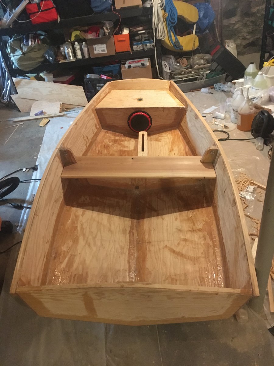

  4. Bon voyage Graham! Hoping we might yet see you out there. Also hoping your luck is better than ours! (We're currently laid up in Belhaven with a wrecked prop)

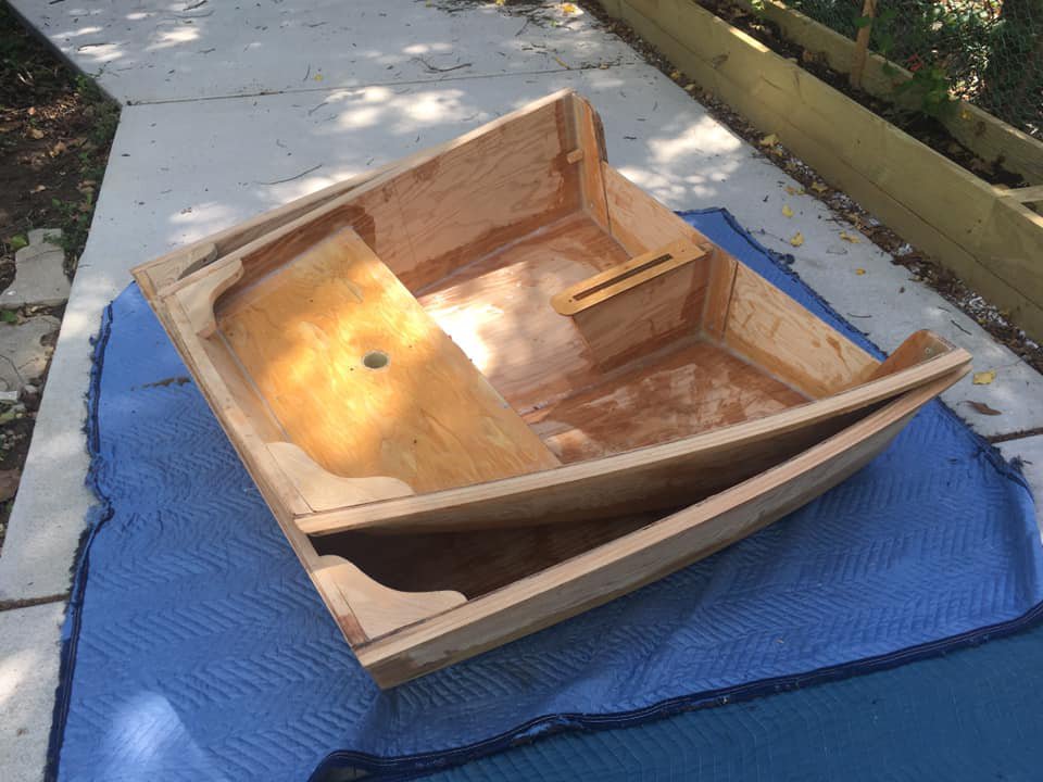

  13. No calls to my wife but I'm sure my neighbors were watching since they're always outside and have commented (positively) on progress several times. I have to say, I expected it to be fun but I was genuinely unnerved seeing the two halves separated for the first time. I felt better once I bolted it back together. She's structurally complete, I added the quarter knees, the keel and deadwood, and extended the gunwales around onto the transoms (not pictured.) Now it's on to epoxy, and then sanding and painting. There's a push to finish by the end of June for a planned sailing trip so I'm putting off the sailing hardware for now, although I have everything I need to finish.
  14. I almost did the same thing, Don, but then I realized since she'll spend most of her life upside down anyways it's probably not necessary. I am concerned with getting some paint down in there since I don't want the epoxy exposed to UV. Either that or make some kind of cap for when I'm not sailing which will realistically be most of the time I'm using the boat.
