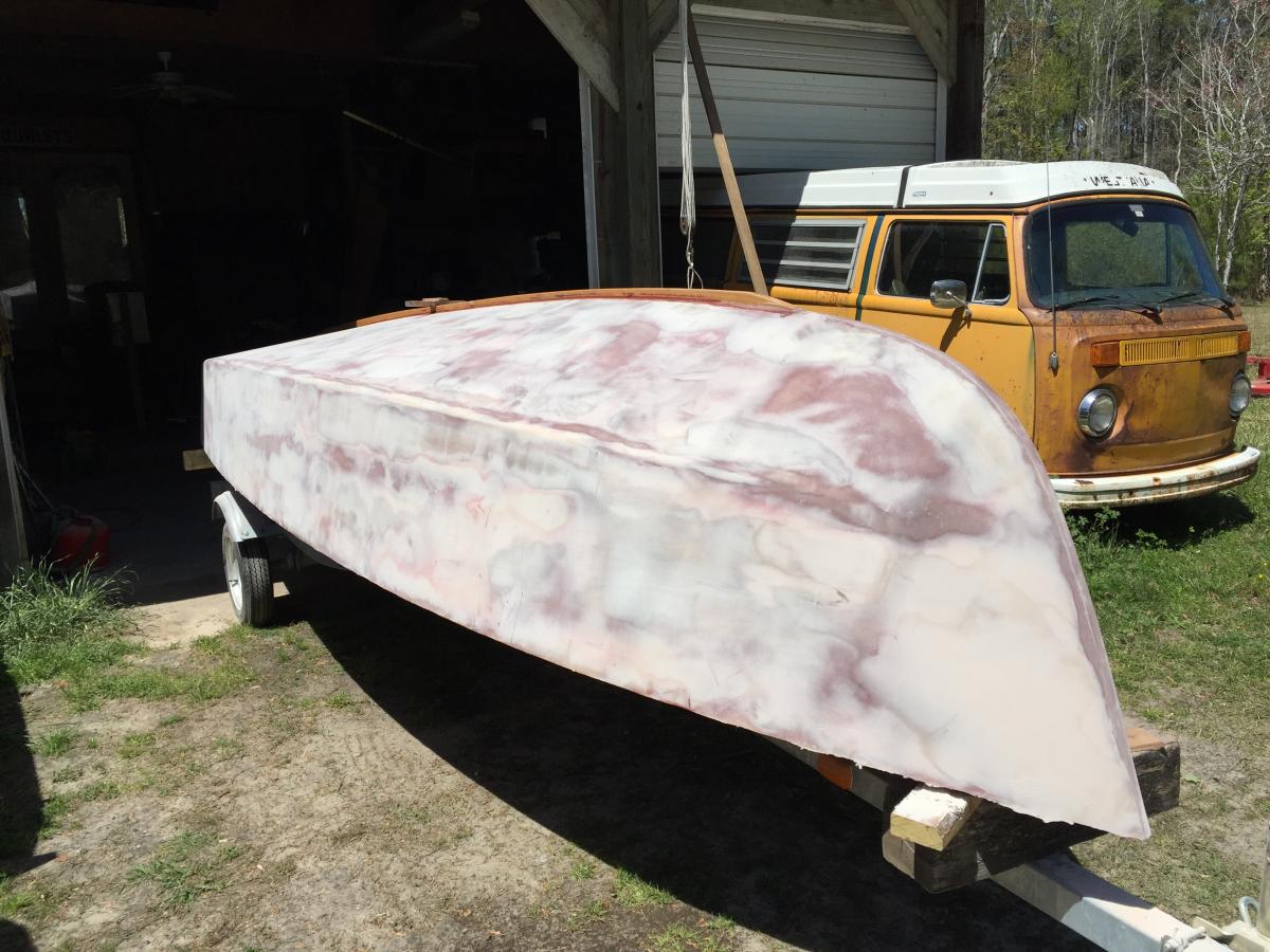

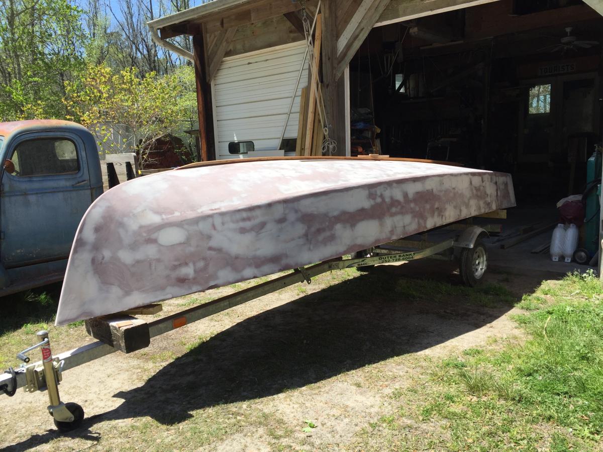

JPower210 Posted April 13, 2016 Posted April 13, 2016 Hey Y'all- Since I have not been seeing any posts on the "classic" 17's i thought I would give a quick update- Number 323 has been progressing steadily, if somewhat slowly- amazing how much time a 3 yr old and a 1 yr old take up I have been fairing, and sanding, and fairing, and sanding for what seems like forever. I have become a huge fan of System 3's QuikFair. The skeg went on last night and I hope to have paint on the bottom by the end of the weekend. Then I will flip her back over and finish out the inside. I have also been working on other projects at the same time- the masts, rudder, centerboard, hatches, etc. are done. Before I flipped the boat I completed all of the framing, seat tanks, etc. So, when I flip her back over, I will have the carlins, coaming, forward seat tops and decks to complete. I am leaning towards a painted deck, (I am a fan of horizontal surfaces being painted for maintenance reasons), but we will see how the ply looks when I get it laid down. The tiller, coamings, thwart and seam covering board on the forward deck will be bright. I am also planning on some rubrails, with stainless half rounds, out of mahogany that will probably be finished bright. I finally feel like the end is in sight and I am looking forward to having the boat done in time for the July 4th race here in Beaufort. Fair Winds- JP Quote
Blkskmr Posted April 14, 2016 Posted April 14, 2016 JP, You are right we have been very Mk3centric. This looks very nice. Sounds like you have a plan once you flip it. I hope it goes well. Regards Quote
Chick Ludwig Posted April 14, 2016 Posted April 14, 2016 Lookin' good. Summer Breeze and i look forward to seeing you at the B&B messabout. Quote

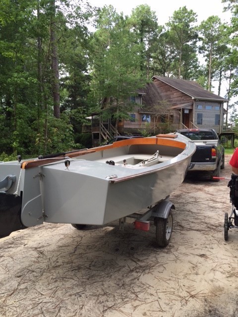

JPower210 Posted July 12, 2016 Author Posted July 12, 2016 Well- in spite of the title, we haven't been too MK3 centric lately, but a "classic" update anyway- Shooting for putting the boat in the water for the first time this coming weekend- still need to put the front hatch hardware on, the aft hatch and the hold downs for the seat hatches. And my wife, the artistic one in the family, is going to paint the name. I am pretty happy with how everything is turning out. There are some little touchups and things to do, but that will be this winter after a sailing season- or at least part of a sailing season. I'll update with launch pictures, but a heartfelt thanks goes out to all on this board for the support and encouragement! JP Quote
Action Tiger Posted July 12, 2016 Posted July 12, 2016 Oh, pleasepleaseplease tell me you plan to tow it with that Westy! Gad, my wife and I, and later the first two kids, must have driven 6,417 miles with a 20 foot guide canoe I built on the roof of a beetle. Then we "upgraded" to a 68 Westy to tow with. Whatever you tow with, enjoy that boat. Quite a pile of work you should be proud of. It looks just perfect from the aft quarter, like that. Peace, Robert Quote
JPower210 Posted July 12, 2016 Author Posted July 12, 2016 Oh, pleasepleaseplease tell me you plan to tow it with that Westy! Gad, my wife and I, and later the first two kids, must have driven 6,417 miles with a 20 foot guide canoe I built on the roof of a beetle. Then we "upgraded" to a 68 Westy to tow with. Whatever you tow with, enjoy that boat. Quite a pile of work you should be proud of. It looks just perfect from the aft quarter, like that. Peace, Robert Well funny that you should mention that... the Westy is in the process of getting new heads....and a trailer hitch. Definitely planning on towing the new boat with it. And thanks for the compliments- Quote
frowley Posted July 12, 2016 Posted July 12, 2016 JP, It looks to be an absolute treasure! Great work and congratulations. Fred Quote
Action Tiger Posted July 12, 2016 Posted July 12, 2016 JP, Ooh, color me a little jealous! Man, that van, and that boat are a recipe for some great times. Change the oil every 1,500 (it works HARD!) and keep a steady eye on those head nuts, check torque every oil change. Oh, and slow down. Mindset vehicles. Ha ha. Oh, good times, indeed! I hope you have the little sleeping hammock/loft. As for the compliments, they were all related to the beautiful thing you made, that cool boat. You earned them, and you are welcome. Peace, Robert Quote
Chick Ludwig Posted July 12, 2016 Posted July 12, 2016 Great job! We'll look forward to seeing you at the B&B messabout! Quote
