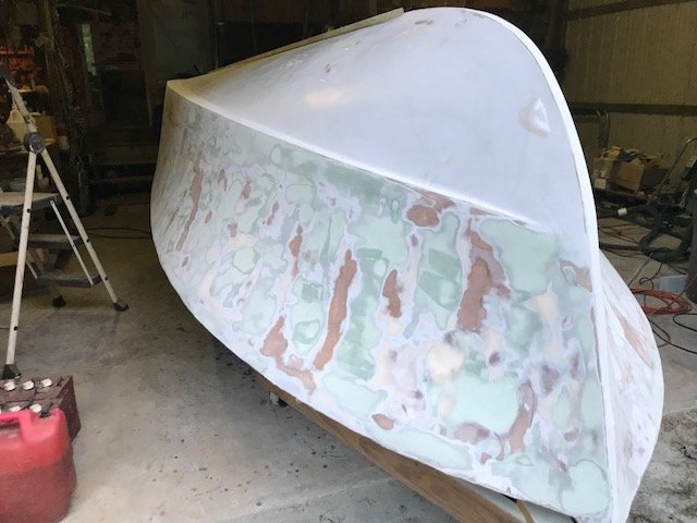

Sprayed the first coat of primer this morning- plan is to get two/three more coats on today and then sand and spray the finish coats this weekend-

I figured a bit of an update was in order- I started my build quite a while ago, but competing projects have taken priority- full refit of a Westsail 32, etc... But I am back at it. I have spent the last couple of weeks spending quality time with the long board. Or as the case may be, the sorta long board with the flare of the OB's topsides at the bow. I think I have hit the end though. Plan is to spray primer later this week, block sand it, and then spray finish coats by this coming weekend. Most of my time is in the evenings, after the little ones are in bed, so I don't get long blocks of time to work. If all goes to plan, I'll let the paint cure next week while we are out of town and flip her when I get back. It's nice, (with the exception of longboard sanding) to take a break from the repair/refit on the Westsail and work with new construction.
