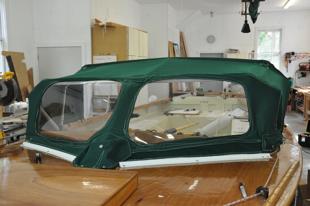

ChrisObee Posted November 22, 2009 Posted November 22, 2009 Yes very much like that but extending all the way to the main mast. I think I would call this a dodger. Perhaps a little higher as well but then I'm rather on the large size. Quote
Hirilonde Posted November 22, 2009 Posted November 22, 2009 I could see a dodger similar to the one Chris shows, but with some clear panels in it. Then an add on section that would create the cabin for at anchor. I can certainly appreciate why some people choose the hard cabin, but I would not want to give up the open daysailor option as day trips would be my most common use of the boat. Quote
