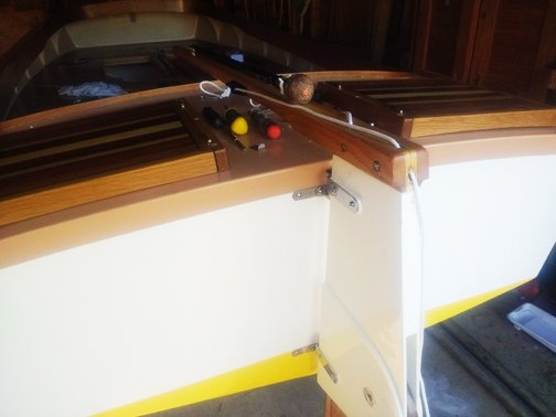

I have an aft deck with two deck hatches, so I won’t make a motor well cut into the deck (I see lots of pretty ones on the forum). I think I need a really long motor bracket (to provide clearance from the transom to raise the motor) or a lifting motor mount? Is there something on the market that would work, or do you have pictures of a custom solution? (This is with a Suzuki longshaft motor).

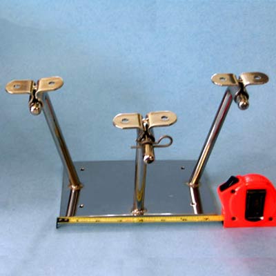

You could do something like this- which is readily available-  I have a long shaft as well and with careful measurement, was able to figure out how low I could mount the motor and still leave room to tilt.  So far it's worked out well-  I also mounted as far outboard as I could to give me more room to work with.  I haven't had any adverse trim effects from that.
10 years myself with no motor, but there are times it would sure be nice.  Does that three legged thing seem solid once mounted and can you tip the long shaft motor up and keep the propeller out of the water?

Many thanks for the different solutions and pictures! (I like the simplicity and cost of a 2x8 bolted to the transom, but unfortunately the motor would get in the way of one of my deck hatches.) I have a CLC NE Dory I can row, and I can always remove the motor later if I decide it's not necessary. However, my wife was on a crew team in college and she's not enthusiastic about rowing anything but a rowing shell - everything else is too slow.
This was Roger Peterson's boat, which was started in 2003. I'm hoping to launch by early July.

The "three-legged thing" is quite stiff when mounted, yes.  I tip my short-shaft Suzuki up.  I did some fussing with the mounting location so that it would both reach the water and have room to tip up and lock.  I'm thinking with the long shaft you could mount the bracket a little higher so have plenty of room to tip up.  See foto.
Many, many thanks for all the replies!  I looked closely at the Duckworks bracket - but it didn't seem it would extend far enough to tip the motor 90 degrees (and the Suzuki motor only locks at 90 degrees). I also liked the lifting style brackets - but all the ones I saw I would need to buy online, and I wasn't sure how well they would fit.
In the end, I really liked the idea of pressure treated lumber (2x10), so I built one to fit. I saw something similar in an online Scamp build blog. I don't like the stress created on the transom by how it extends so far aft (~11 inches) - I suspect the biggest threats are potholes bouncing the trailer. (I need to add a safety cable.)
