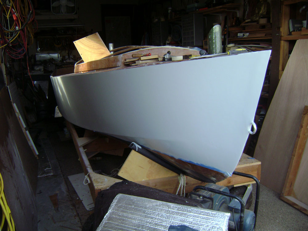

This is one way to do it. I just used fiberglass tape and criss crossed it both ways over the "step". Then I wet sanded the joint with 40 grit paper (really cuts smooth and fast that way...). Followed that up with some micro balloon filler for the final finish, and then primed and painted it all. I think the last picture is where the joint was, but I can no longer tell....

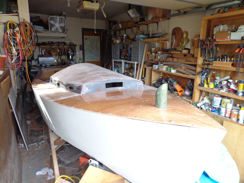

"Lost" most of the Spring due to back issues, but have just dumped the crutches and am back to trying to finish her up this Summer. Finally got the cabin built, and glassed. Used one sheet of 1/8" marine ply for the base layer, and then rolled a layer of 5.7 oz carbon fiber cloth on top of that. Immediately gave the base sheet rigidity. Spread thickened epoxy over the carbon fiber and then laid a second sheet of 1/8"ply on top. Used a gazillion staples (3/8"galvanized) with bamboo skewers to keep them from burying completely onto the plywood. Pulled the staples, faired each layer. The cabin will already hold my weight. All of this will get covered with a top coating of 10 oz cloth. All other deck components have been cut, and glassed. It's just a matter of being able to build up the endurance to keep up the pace.

Dave, Just before the Winter set in I used it to get a few coats on Petunia (CS#204). I've worked with many topcoat systems before but none were as easy, or pleasant to deal with as the System 3 stuff. I HAD to go water based as my build has largely been done in the "stealth mode" due to local community restrictions on keeping a boat on the premises. Therefore most of my work has been done without the use of power tools, and using conventional marine paints would have brought out the blood hounds in most of my neighbors. The primer and paint both rolled on SO well ( white 4" "finish rollers" from Lowe's....) that most people who have seen the hull think the finish was sprayed. I used their application schedule of adding the catalyst to the final coats, and while she's still a few months from being wet, she can handle a lot of banging around in the garage without dinging, or scuffing . Time will tell how well the paint holds up in the sunshine, but since we haven't had much of that I'll have to wait until this Summer for real feedback. -

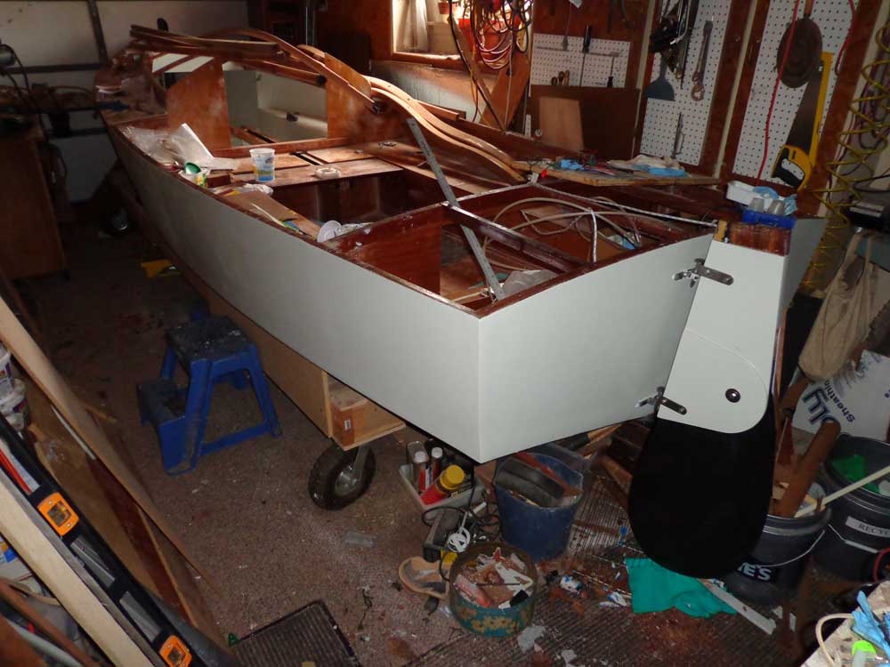

Been a loooooong time. Lots of 'medical issues' and speed bumps, but I'm back to working on Petunia. Finally got my head wrapped around "3D space"and sorted out the framing for her cabin. Did a test fit on top of the cabin frames with an old piece of Masonite, and it looks like it's going to work... She's got Kevlar chines, and edges on her board and rudder, pool noodles in her masts, 7 cubic feet of foam flotation stashed into compartments, HDPE mast bearings, etc., etc. She's over built,(probably) over weight, and certainly over due, but I'm still shooting for this year's Messabout.....

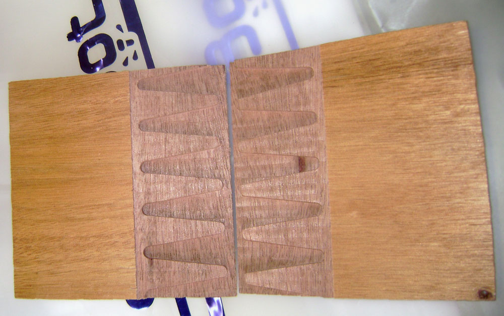

Here is a picture of the CNC finger joint which Graham came up with last year. He may have even modified it further since then. As you can see it incorporates the true fit on the edges, with an "anti slip" finger so the joint can't move sideways when pressure is applied in the gluing process...
