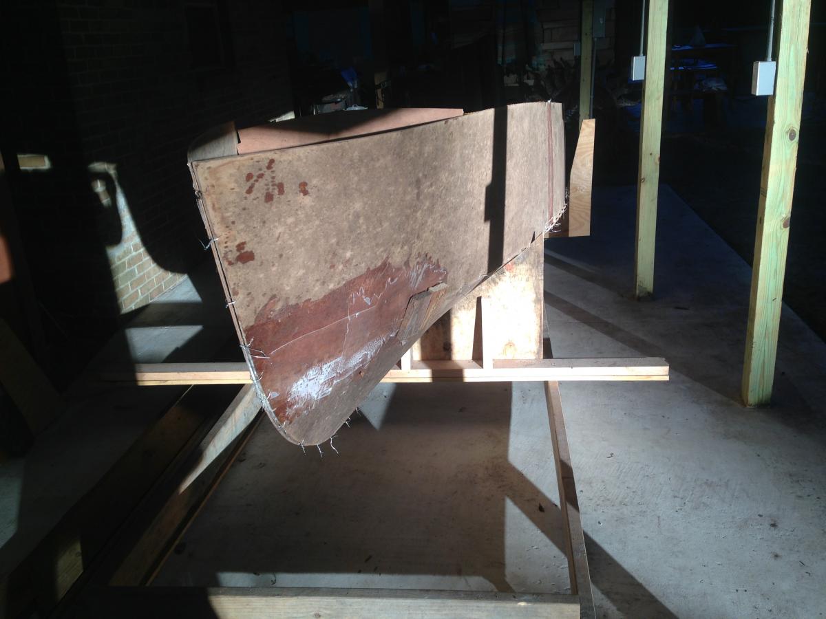

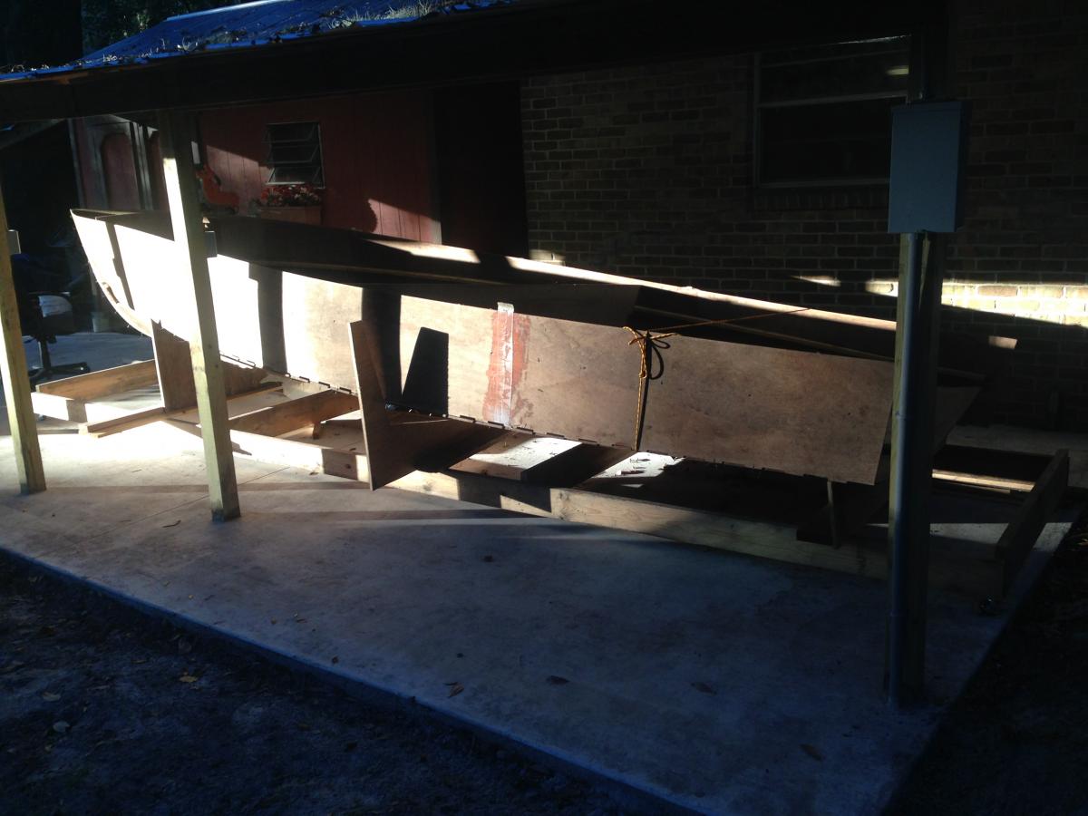

  2. Thanks... that is good advice. I used as cradle supports pretty much exact copies of 3 different bulkheads (I took a bulkhead and traced it onto plywood and cut it out and used the opposite piece as the support). One thing I haven't done yet is level it out. It appears that the front of the boat is way too high as compared to the back of the boat, so that front support will probably need to be lowered. I can take some more detailed pictures. Tom

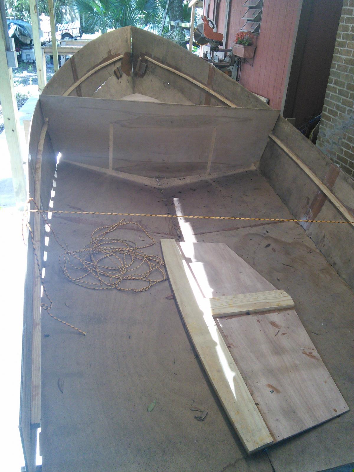

  3. You can see here that I don't quite have the sides attached just right to the bottoms. Kind of gappy. Maybe moving the bulkhead around a little. Ideas??? Sorry to be so slow about this build.

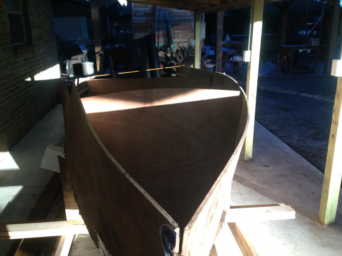

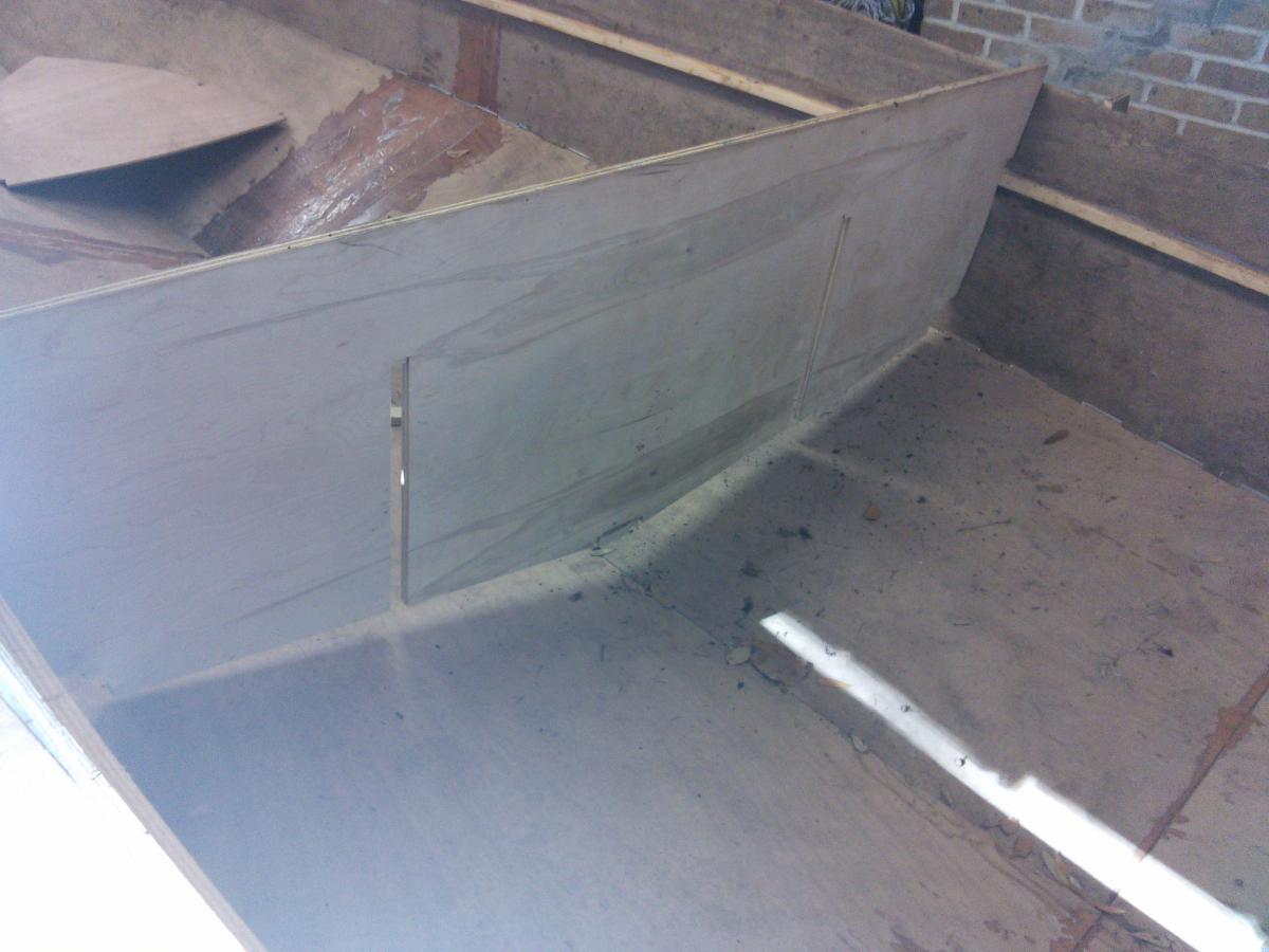

  4. I finally have the boat refolded out and kind of have the temporary bulkhead wedged in.

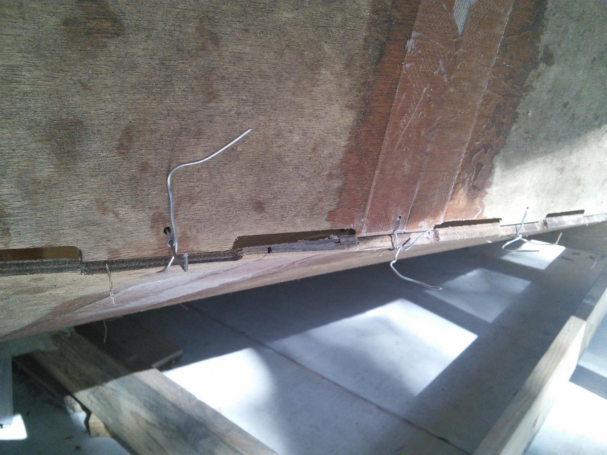

  8. The joint was not starved. This was a tear in the wood at the finger joints. I am gut sure that the number of times I moved the 20ft bottom piece before unfolding was probably the culpret. No worries... I will take it apart, fix the joint and do the unfold process again. This will afford me the opportunity to get some video and photos of the unfold process, since it happens so quickly. I wasn't sure if I could avoid the taking it apart and re-unfolding, but I guess it is the right thing to do.

  10. Actually, this is not a case of torn holes. As a CNC cut kit, the bottom pieces have cool puzzle joints to join the front bottom to the middle bottom to the aft bottom, done with thickened epoxy and no fiberglass tape (actually, those same pieces on the sides were joined using thickened epoxy and fiberglass tape, the way you would do if you did not have a cnc kit boat, and had actually scarfed your plywood, but I didn't read the directions enough and did the tape in addition to the thickened epoxy) Again, those bottom pieces were done without the benefit of tape. So, it appears that the finger joint actually tore. Center line of the two bottoms is fine where the wire ties are. It is the starboard bottom between the front stbd bottom and middle stbd bottom. It only tore halfway, from center keel line (where the two bottoms are wired together) halfway up that bottom join. So that means where the stbd bottom and stbd side meet is fine, because that part of the bottom join is still together.
  11. Hello....it has been a while since I last worked on my boat. The "unfolding" process has been more than a one person job, and life got in the way. I just unfolded the boat, and during that process, part of the stbd side bottom came unseemed. That is to say, all the bottom panels were put together per the plans, starboard bottom forward, attached to starboard bottom middle to starboard bottom aft, then same for port side bottom, then side panels, same. Then, the side panels were partially attached to the bottom panes, at the nose of the boat, then the bottoms wired together, tighter at the front, but a little looser at the stern. Well during the unfolding, the bottom stbd, at the first seem between front and middle section seem of bottom panel, came apart, halfway. I now have the plywood supports under the boat, on top of the build cart I made. The sides and bottoms are lined up and ready to be wired and the boat is now stable, kind of .... Now, I need to figure out how to fix the starboard bottom panel were in tore. Any thoughts before I screw this thing up even more? Thanks Tom
