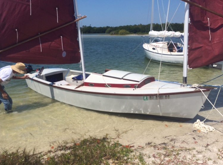

  6. The folks at the West Coast trailer sailing squadron just posted some shots of the 26 boats that showed up for their Cayo Costa weekend- Here's a few they took of 'Petunia' as Lennie,Margie, and I visited..... To see ALL of the boats that made the trip here's the link- http://ftp.ij.net/wctss/wctss/photos128.html

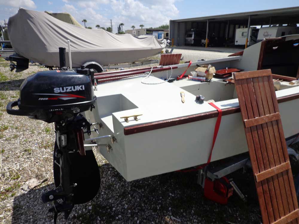

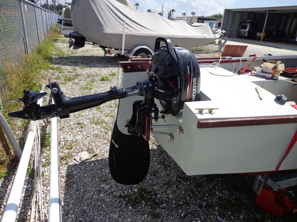

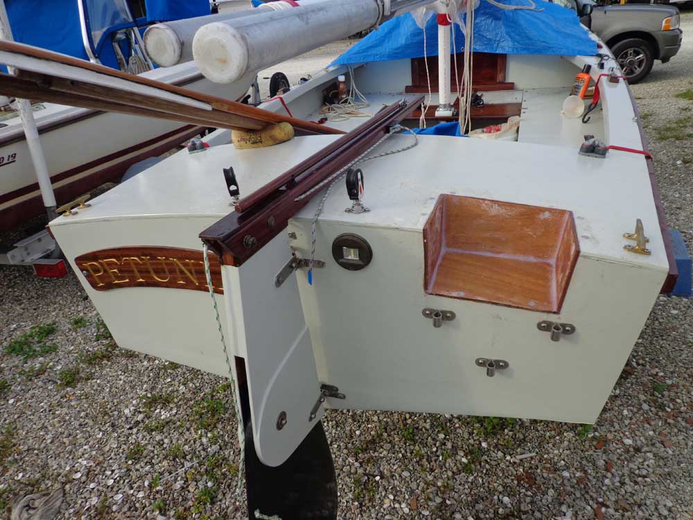

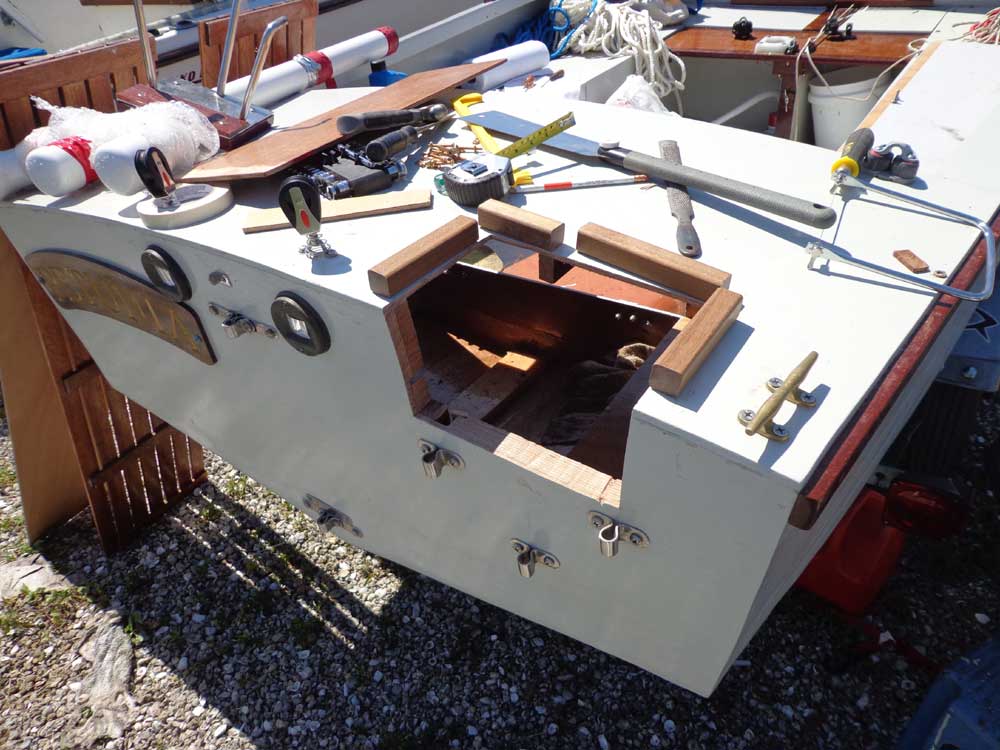

  9. As mentioned in an earlier thread I was having issues with my new 2.5 HP Suzuki outboard and the removable Duckworks bracket. I wasn't able to fully tilt the motor into an "up"position to keep it out of the water while sailing. When we sailed to Cayo Costa last week I experimented with a large cut out to see if it would be large enough, and it worked fine,SO I enclosed the cut out area and epoxied/painted it. It is now working beautifully and it lets me raise the motor easily and securely. I just through bolted some cleats under the deck, cut out pieces of plywood to the proper sizes, and "hung" them from the cleats. Then I ran triple fillets of epoxy (each being fatter than the prior one) to lock all the pieces in place. 4 coats of paint later, and it's done.
