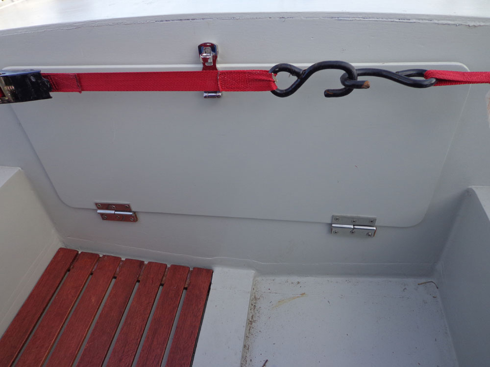

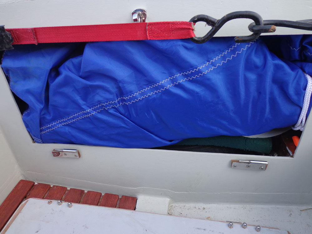

Chick, I got them at- www.marinepartdepot.com http://www.marinepartdepot.com/ststpuhileha.html Left handed hinges are-MPD_6630a Right handed are_- MPD_ 6630 Let me guess, you're going to buy the hinges and design a boat to fit them (?)

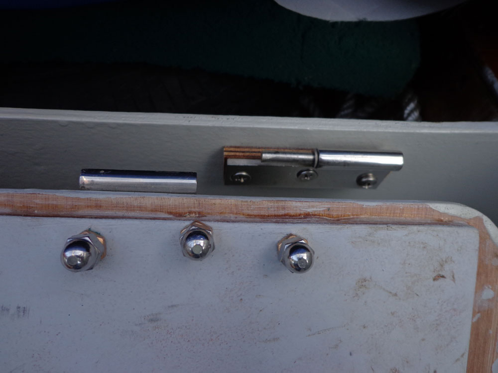

Len, Here are the take apart hinges I used on Petunia. You need at least a few inches on the hatch which will be straight to allow both hinges to work in tandem (unless you decide to go with only one of them). I had bought a few sets over the years (major advantage of taking SO long to complete a build is you occasionally forget what you have previously bought...). I gave Doug Cameron a set down at the Messabout, and if you'd also like a set let me know and I'll drop them off while I'm in the area this week. It is a nice feature to be able to get the hatch out of the way when you want access to the aft compartment....

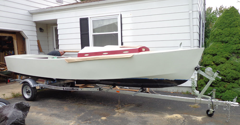

Finally found a trailer. After going through all of the Craig's list scenarios ( "great trailer, needs some work, NO paper work or registration, etc.,etc" ) I bit the bullet and found a new one to be a lot less expensive than I feared,( $650 in NJ...). Got her almost fitted to it, and am now frantically trying to button her up ( hatches,etc.) in time for the ride South to the Messabout. Still somewhat limited by a bum leg/nerve damage so I'm going to be finishing her AT the Messabout it looks like. In the attached picture you can see that I need a little help with striking a real waterline, etc., but unless the leg falls off completely Petunia, and I WILL be there this year....

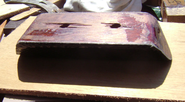

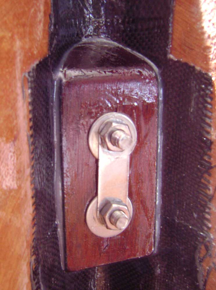

Belt and suspenders technique: use a fitted backing plate which is shaped to the interior of the stem. This adds some "meat" to your backer and as suggested above means you will have strength in almost any direction. This is just a piece of Purple heart saturated in epoxy.
