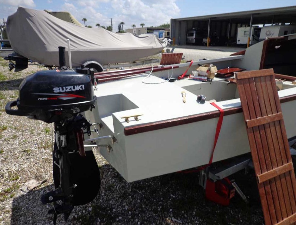

  16. Mine is on the starboard side so I would have easier access to the controls, particularly the "kill switch". I'm not sure there would be any more/less issue with the mizzen either way since the sheets usually foul on the motor's cowling rather than the handle.

  19. Isn't the cockpit on a Mark 3 self bailing/draining? If so it will serve the same purpose as another hole in the hull.....
