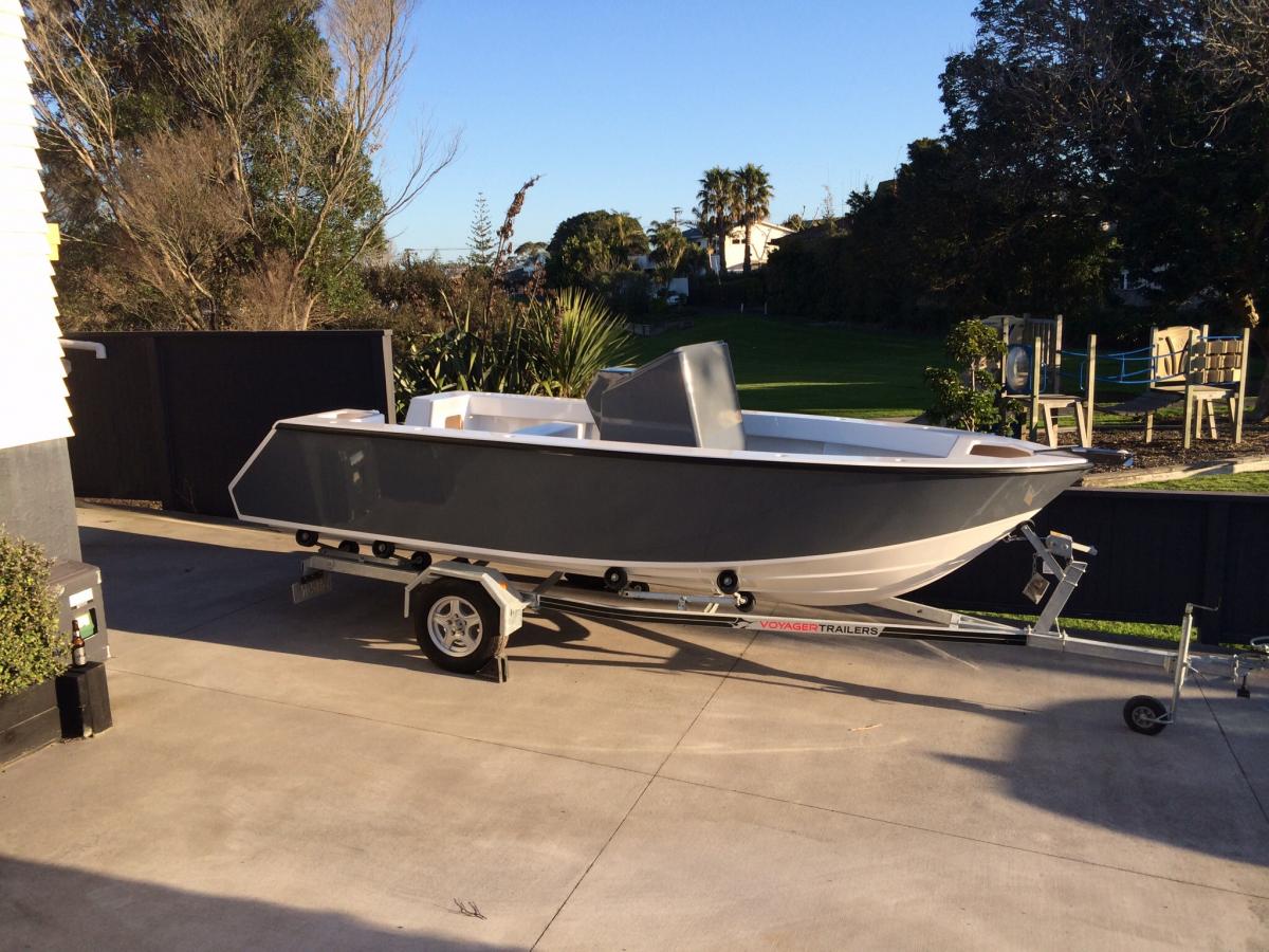

Dave! Bloody hell she's all done. Congratulations mate. What a beauty. Absolute top job. I bet you are a proud owner. Still trucking over here in little ol NZ. Built another boat. ..... Have to do something in the evenings. Hope you enjoy your craft. She's looking great. Regards Lance boardman
