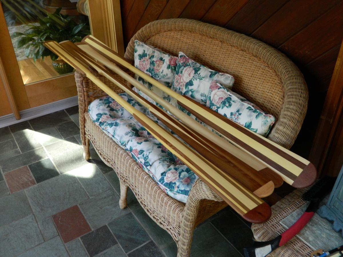

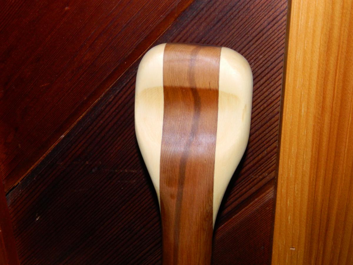

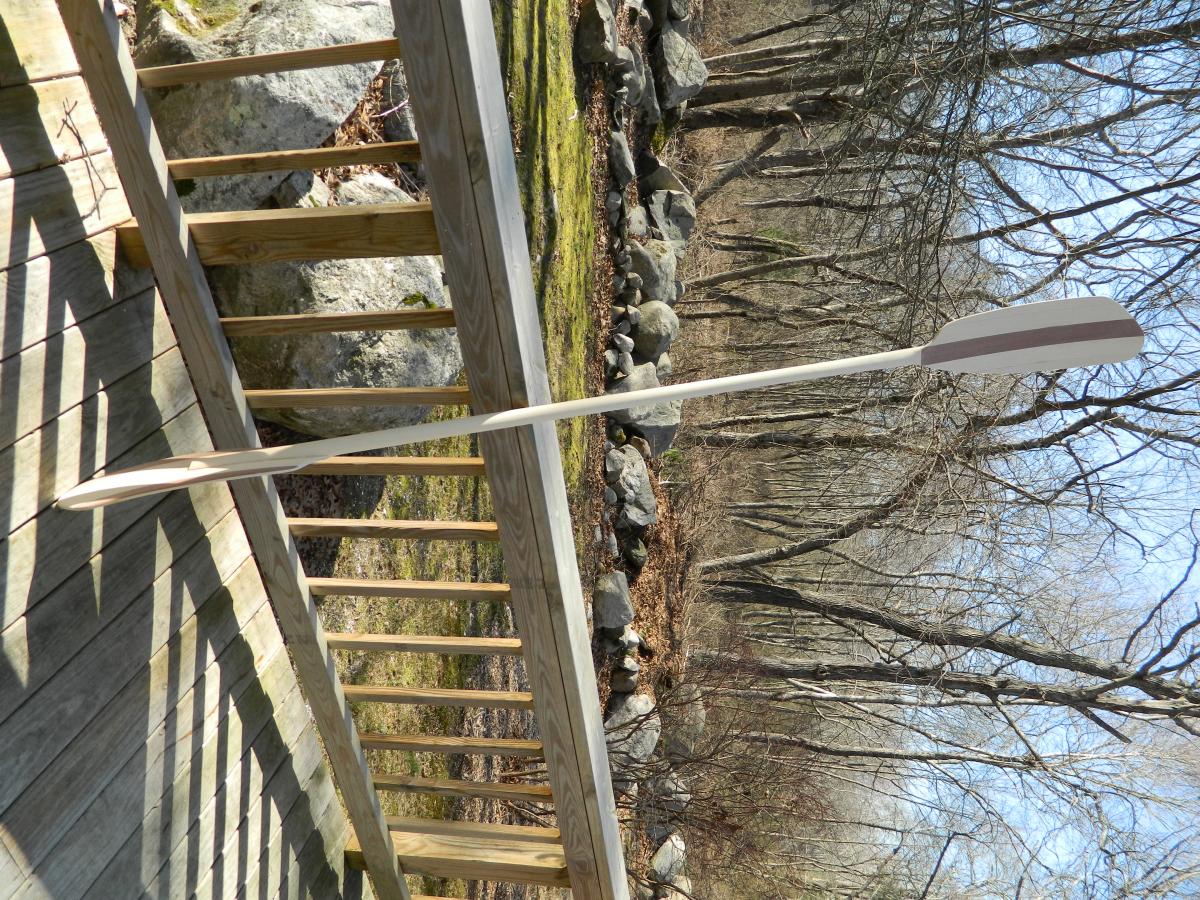

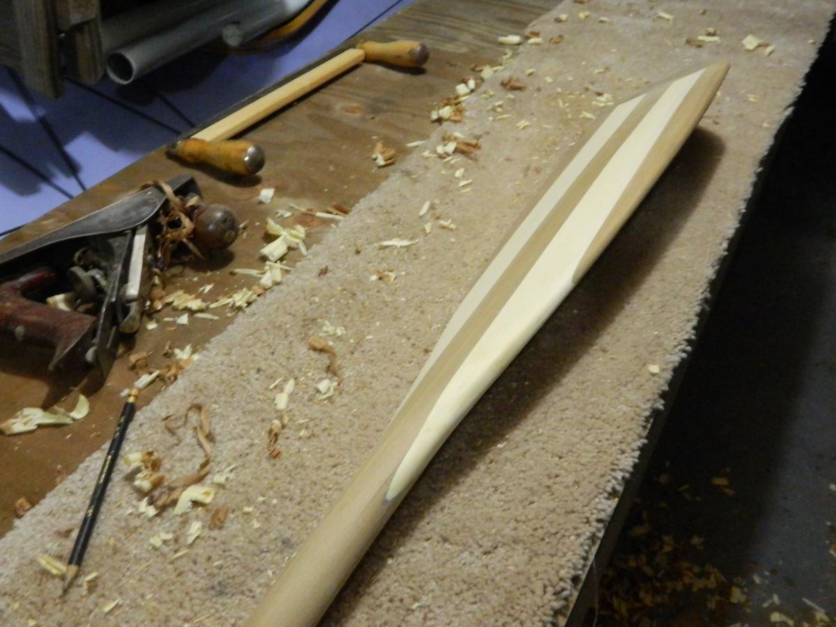

I intentionally left the rowlocks off my Lapwing.  No matter which rowing station I considered setting up I did not like that the row locks would be in the way of on deck seating.  So for the first season I just brought a canoe paddle with me.  I found the Lapwing sails so well in light air that I can't imagine many times I will not be able to sail back to the ramp, even if slowly.  I use the paddle only for getting off a lea shore ramp or to come in the last bit of a weather shore ramp.  I carry a teeny back up paddle in the forward storage (under the fore deck).  But I wanted a proper paddle for maneuvering  near the ramp and if I did get caught in absolutely no wind.  I decided the best place to store the paddle was along the centerboard trunk on the port side (trunk is off-center to starboard).  So I designed and built a paddle that is as long as possible and fits there without getting in the way of the fore hatch.  This meant it was a few inches shorter than ideal, but quite fine.
post-442-0-47435000-1447194547_thumb.jpgpost-442-0-52017400-1447194559_thumb.jpgpost-442-0-87935800-1447194568_thumb.jpgpost-442-0-10876800-1447195530_thumb.jpg

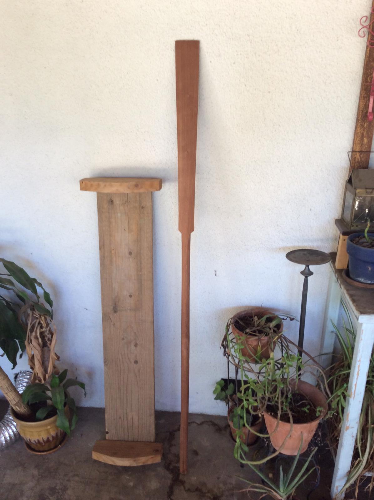

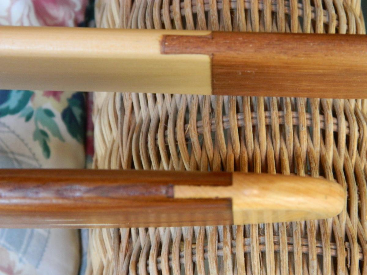

post-442-0-88207500-1447194578_thumb.jpgpost-442-0-21561100-1447194586_thumb.jpgpost-442-0-09380200-1447194594_thumb.jpg
Just need to make a couple brackets to hold it along the trunk now.

if you ask a cook what they make scratch soup out of they say they just cleaned out the refrigerator.  That is what i did in my shop Bob.  The paddle is Alaskan Yellow Cedar and Western Red Cedar scraps laminated and a Teak tip mortised in to protect the soft material when pushing off and other abusive practices.

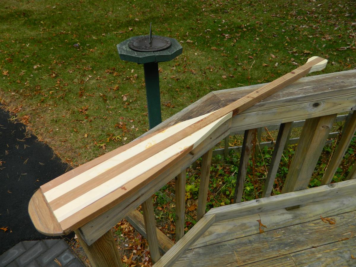

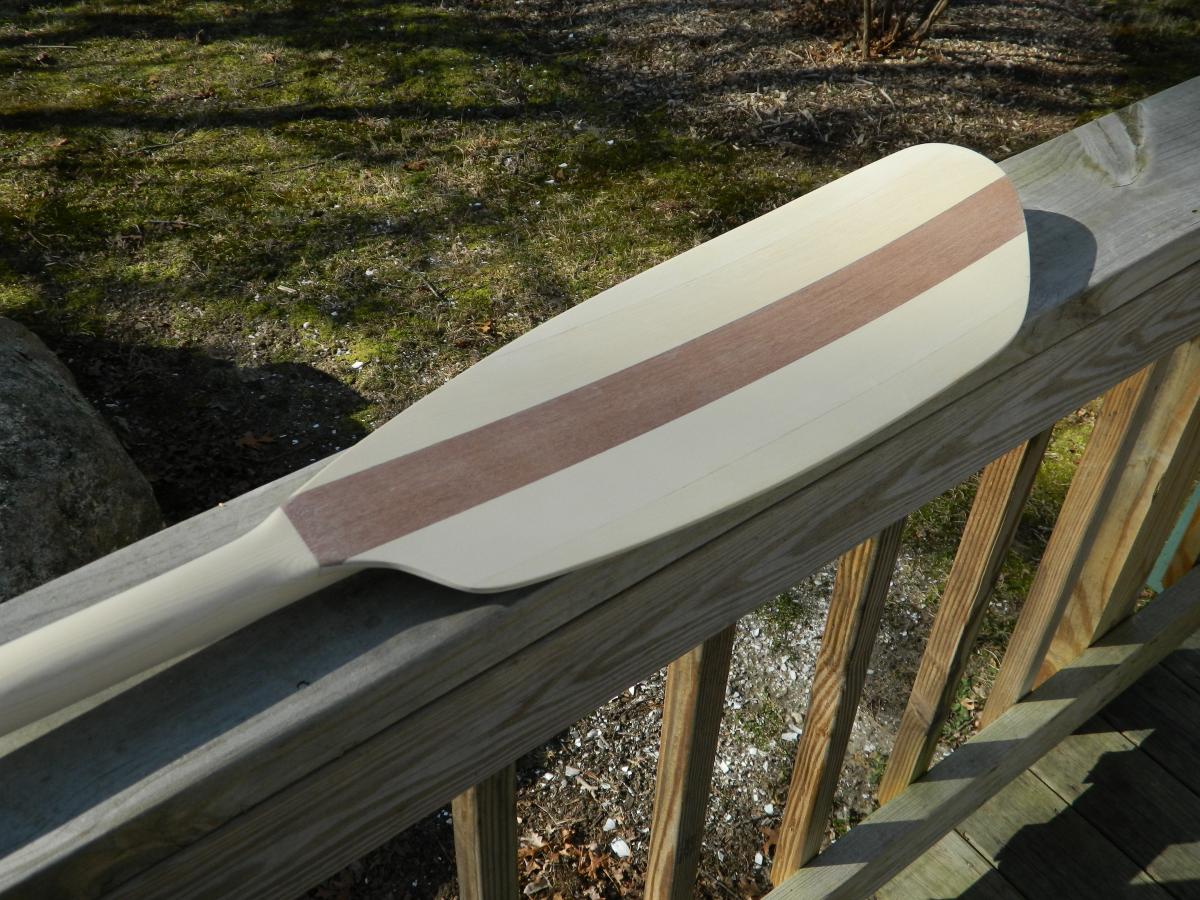

Thanks Chick, here are a few shots:
A euro paddle:
post-442-0-76017400-1447339887_thumb.jpgpost-442-0-78326300-1447339898_thumb.jpgpost-442-0-53283100-1447339906_thumb.jpg
Some Western Greenland inspired paddles:
