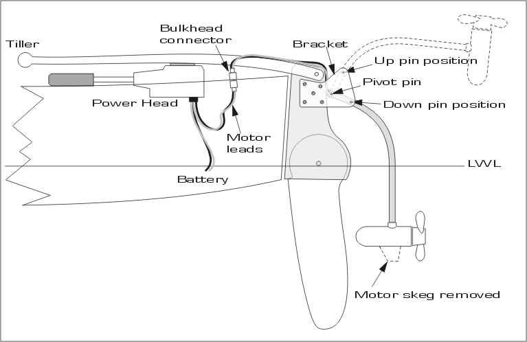

I'm working on a setup I've had in my head for a few years. A trolling motor that can be deployed and retracted, from a cockpit seat locker, all in one motion. To complicate matters, also tied to the rudder, for vectored steering. The idea is using just the motor and shaft, removing the control head and placing this on the underside of the tiller, with an umbilical to the seat locker/motor compartment. A quadrant arm on the rudder shaft, with a cable to the motor shaft's similar arm. The motor and its shaft are attached to a bifolding arm on a perpendicular base pivot. This allows the motor to "fold" up into the compartment, yet extend aft enough to clear the back of the boat. A single quick release pin locks it about 12" below the LWL.
The idea is to have a regular seat locker, open the lid, pull up the motor and swing it aft over the stern and down into position, all in one movement. No parts to hook up, adjust or fiddle with. The only hook up is the electrical connection from the motor to the bulkhead connection, which could stay in place if necessary. Control is at the tiller, so you're where you need to be during operation. When at your sailing area, you pull the pin, fold the rig up and forward to the locker and close the lid. I stole this idea from a bow mount trolling motor rig I saw and am just making it backwards and with more reach. Because the control head isn't attached, folding it into a locker is relatively simple, once I work out the geometry. The hard part has been enough leverage with the small quadrant arm on the motor shaft.

I'm pretty sure I saw a pic on the internet where someone had put the trolling motor head IN the rudder blade. Lots of drag, but if you got a tiny feathering prop...
I do have a rig that uses a trolling motor on the rudder blade, but it's retractable, just using the rudderhead to align it in the down position. It's the same setup, with the powerhead mounted under the tiller and a pivot on the rudder head that lets the motor rotate up and down. When not in use, it's rotated up and locked in this position. Bolger designed a box boat with a trolling motor built into the blade. I'm sure it sacrificed a knot of boat speed for this convenience.
The bass boat bow mounts don't steer remotely, from what I've seen, the foot pedal just controls forward, reverse and speed. I want the motor to be slaved to the helm, so it will be effective at slow speed maneuverability. Nothing worse than to need more way on, just to get the boat to turn under rudder alone or even worse, backing up in tight quarters. Having vectored powered steering is so far superior, that nothing else is reasonable. My needs for power are light, with the sailing area just a few hundred yards from the dock. I can sail out on some days, but most often I'm pinned against the dock with the prevailing, so need to power out to get some sea room to hoist, without banging into something.
