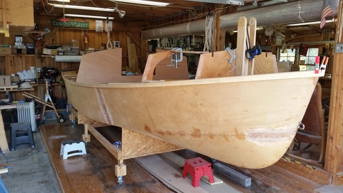

Pete McCrary Posted March 23, 2016 Author Posted March 23, 2016 Getting ready to attach the sheer strakes. Both sides are now forced into a fair sheer line from stem to stern. Graham's suggestion of a 1 x 2 batton back-screwed to the side plank leaving a 1/4" lip to channel the strake to its proper position did the trick. NOTICE to builders -- when attaching the transom remember to put a bevel on its sides. Without a proper bevel, the side panels will start forward at a right angle (from the transom) instead of inline with a fair sheer. That will create a slight but noticeable "dimple" in the side panels just forward of the transom. See the photo showing the gap near the transom. I didn't want to force the dimple to be in line with the batton-- thinking that might force the epoxy to crack at the side panel / transom joint. Also, forcing the side panel to the batton wouldn't take the dimple out all the way down to the chine. If the dimple is obvious and ugly, I plan to eliminate it with epoxied fairing compound. QUESTION: Should that be done before or after glassing the bottom and sides? Next will be to firmly line up the sheer strakes to closely fit the side panels and FIX them in place with "spot welds." Quote

Alan Stewart Posted March 24, 2016 Posted March 24, 2016 Pete, the picture of your bow with test anchor on show the foredeck incorrectly positioned. The stem does not angle backward above the side panels. The anchor locker cutout near the tabernacle should be in line with the front edge of the tabernacle. The pic shows not enough lateral support for the tabernacle with foredeck positioned back where you show. I hope your sheer strakes are glued up correctly. Quote
Pete McCrary Posted March 24, 2016 Author Posted March 24, 2016 Alan,... Great record performance in the Ultimate Florida Challenge. To do that you had to be in terrific physical and mental shape. Gongratulations !! The sheer strakes are wired [together] at the stem and nestled into the "lip" of the 1x 2 boat-length batton suggested by Graham. That back-screwed batton has set the inside beam measurements right at the dimensions you gave me earlier at the hanging knee positions. Blks 1, 2, 3 (in-place temporily), and 4 brackets aft set at 72.5 dgrs (2 ea P/S) have the sheer strakes at the required angle and very nicely set. The computer-drawn lines on the inboard side of the sheer strakes lineup VERY close (i.e., within a "line width or two") to the bulkhead positions. Amazing accuracy! Haven't tac welded yet. It all needs just a little fine tuning with wires, wedges, etc. When you get a chance -- check out my last few posts. Really glad you're back safe and sound. Quote
Designer Posted March 24, 2016 Posted March 24, 2016 Pete, Alan is correct. The aft end of that little piece of foredeck ends 2" forward of the fore side of the forward bulkhead. There is no aft rake in the stem or bow profile, it is a fair line all of the way to the upper sheer. If the bow end of the sheer strake has an aft rake, you have something wrong. Quote
