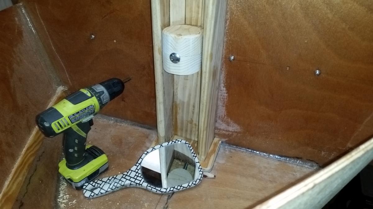

More progress on Chessie. Seems like I keep finding little things to do ... Just to keep from getting into the big stuff. My latest "little thing" is a faux mast just about 3" tall! It should keep driving rain (at 70 mph) from entering the foot-bolt hole in Blk#1. My last little job was a plug (2 & 3/4" diameter) to jam into the foot of the mast (when lowered) to keep rain water out -- but more importantly,.. birds and othe critters from nesting in the mast while parked on my driveway.
The bottom of the faux mast is trimmed with about a 5 degree slope so that dripping water will be lead away (forward) from the tabernacle. Tomorrow, I promise, I'll start on the bunk tops. But don't hold me to it.
