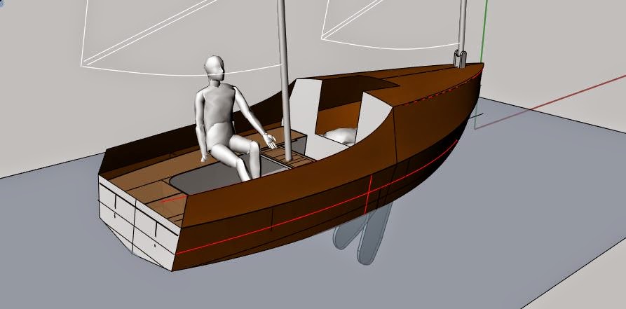

ricknriver Posted September 3, 2014 Posted September 3, 2014 Alan, As time permits :-). With performance proven, do you think the CS15's bow area could be tricked a bit to accommodate a small pop-top cuddy & useable portapotti. tween the mast & CB, for these oldsters at least when anchored/beached without an adverse impact on structure :-)? Or maybe in the stern? Trying to go to a smallest practical daysailer/explorer, as BH19 now at new home in Seattle. Thanks for the great videos. Hope to see you all at Messabout. Best and prayers for Carla. Rick Z Quote
Alan Stewart Posted September 3, 2014 Posted September 3, 2014 Rick, For the 15, my suggestion would be a nice big dodger that snapped around the gunwale and across the foredeck with rotating bows that could be folded down onto the foredeck. A zipper door on the aft end and you would have a tent on the front half of the boat and if you converted the CB to a weighted style and added some seat top filler pieces you would have a nice seat top bunk for 2. A portapotti could be stored in a stern locker and used in the bow if need be. Here is a render of the tent bows. I didn't draw the actual fabric but you get the idea. I was curious so I took Graham's MK3 idea and ran with it on the 15. Unfortunately the boat just isn't quite big enough to make the ergonomics work. Sitting headroom would only be possible if the cabin were made even taller than this and it's pretty chunky looking as it is. It could probably be massaged a bit to be made a little more pleasing to the eye. There isn't room for a bridge deck to sit on for rowing without losing minimum bunk length in the cabin. Also, the cabin isn't really big enough for 2 so it would be a solo cruiser. It would have water ballast, self draining cockpit. Could have a sliding hatch and a dodger or a trench. Here are some renders of the quickie 15-MK3 concept. Solo cruiser. Could maybe build in a small galley to starboard behind the CB trunk. Kinda chunky looking. Maybe if you were really short? Can't quite get sitting head room in the cabin. Quote
ricknriver Posted September 3, 2014 Posted September 3, 2014 Great fuel for thought Alan. Better than some other mini cruisers out there. Thank you for taking the time. Rick Quote
Chick Ludwig Posted September 11, 2014 Posted September 11, 2014 Hey Alan. Any more videos yet? We're ready for part 16. Hey, I kinda like that little mini Mk-3. Sure beats the Peep Hen. West Wight Potter 15 is really popular. There are other 14s and 15s out there too. This would give them some competition. Some folks just like to "potter around" and speed isn't a concern. They want lower cost, ability to tow behind small car, and just like the idea of a minimal cruiser. Hey---how about an ocean crossing in it, like Tinkerbell or Yankee Girl? By-the-way, who is that ugly guy in your renderings? Quote
